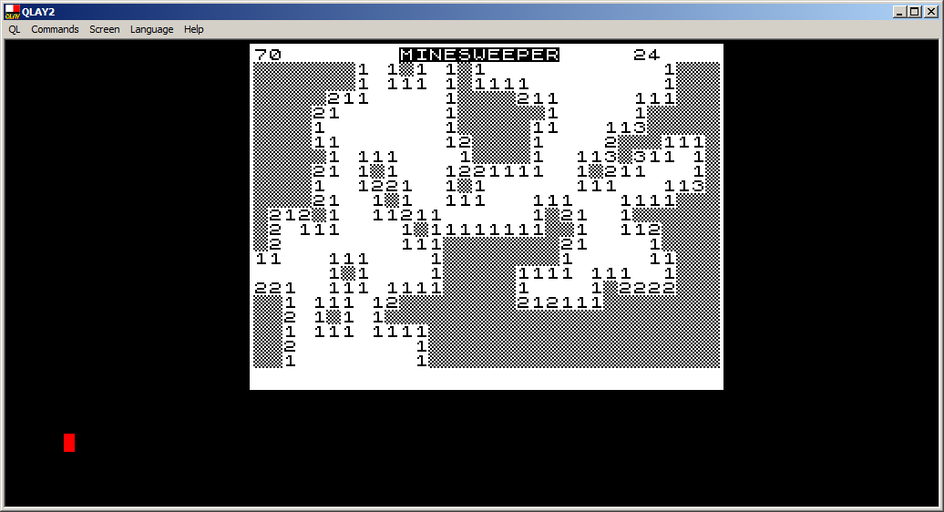

So for fun I converted the ZX81 Minesweeper game to SuperBASIC. It plays faster than it does on a ZX81 but not by that much (maybe 4-5 times). Clearing out half the screen took a little over 2 minutes and it took a little over 10 on the ZXSimulator running the same game -- so 4-5 times slower is a considerable wait of an extra 7-8 minutes -- but other parts ran at similar speed and I will likely further speed up the ZXSimulator eventually to catch up a bit. After all, I'm writing a BASIC interpreter and SuperBasic is just that as well, though more efficiently implemented. On the actual ZX81 it wasn't quite 10 minutes but I think it was close to that.
Here's a pic of it playing:

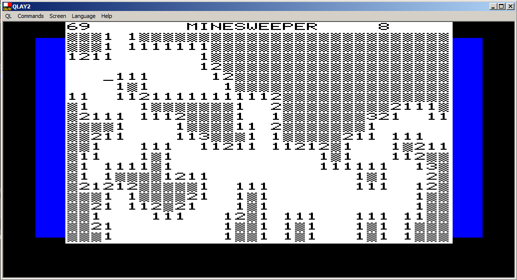

Here is the ZX81 version on ZXSimulator which runs slower.
I do like the look of the ZX81 version better. You can get that look on the QL (and even better of course) but you'd have to do some graphics futzing to get to it. I just print out character code 255 to get the stippled patter on the QL but it leaves a gap between boxes...I like how the ZX81 doesn't. The characters aren't as easy to generate on the QL so I didn't bother trying to invert characters, etc. That's the one nice thing about doing quick development on the ZX81...you are limited with graphics but you can do those limited ones quicker.

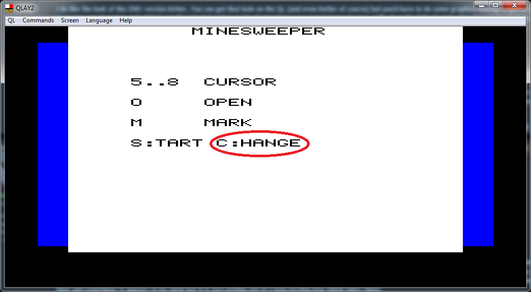

pjw wrote:I briefly tried the SuperBASIC version under SBASIC on SMSQmulator and AFAICS it seemed to work fine. Since I dont have a number pad, it wasnt much fun, but it should be easy enough to change that to using the cursor keys.
It's set up for you to change it on startup. Just hit the "c" key (in reality you can hit any key but "r") and then you can select space and cursor keys.
