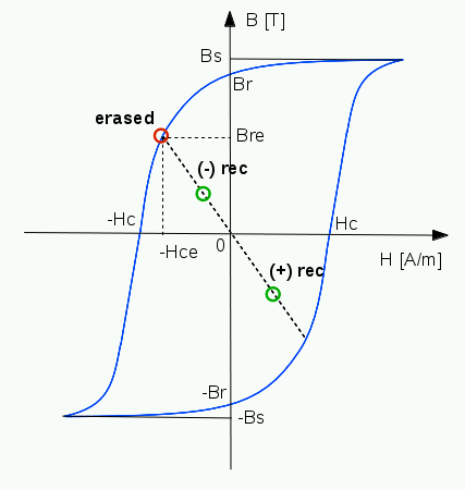

This asymmetry is caused by the fact, that in one direction a higher coercive force is needed that in the other, to overcome erased record which is a singular in the top left quadrant. `Bre' - remanent magnetism of erased record, `Hce' - its coercive force.
Coercive Force
Coercive Force

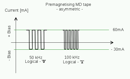

Knowing this, I can now correct the earlier diagram, now showing two currents with different bias. The current switching is done by MD ULA amplifiers? As the erase current is some 30mA, I just estimate that in one direction twice as high current is needed in writing through R/W coils.
asymmetric recording

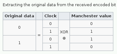

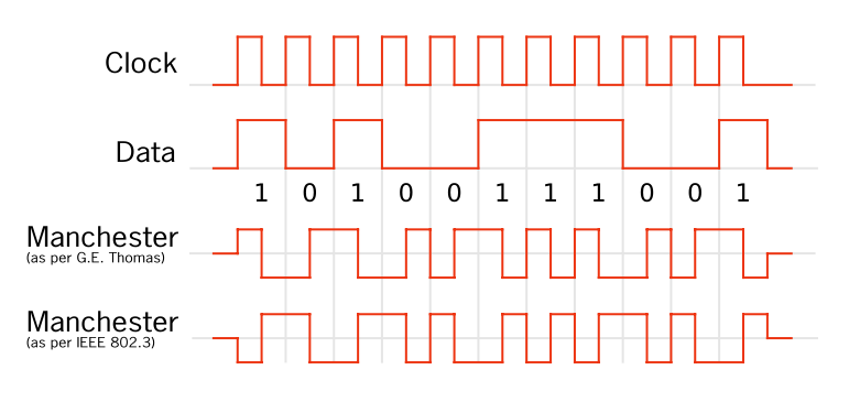

When we read the Dicken's QL Advanced User Guide, we see that the nominal time per byte is 40uS. As this is across 2 tracks, that equates to 80 uS per byte/track and thus the actual 'bit-frame' - which is constant - is 10us, regardless of 1 or 0 levels. This allows for 1/2 cycle at 50 KHz (==0) and 1 full cycles at 100 KHz (==1). Sort of, but not quite FM encoding.
Instead, the detection of 1 or 0 is effectively based on the number of transitions that occur in any given 10us bit-frame (1 or 2 transitions), or more precisely, whether or not a transition occurs both at the start of the frame as well as in the middle. Its more helpful, then, to discuss in terms of Manchester Encoding (ME), rather than FM.
The Wiki page on ME shows how easy it is to decode/encode the signal to or from tape (XOR data with CLK): https://en.wikipedia.org/wiki/Manchester_code

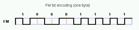

Thank you for reading my post. You are possibly right, in my 2nd diagram I just wanted to show how current is biased in one or the other direction through R/W coils. Frequencies just show that series of "1" ones need twice as many transitions to series of "0" zeroes.
The actual encoding I tried to show earlier with this picture, in naming it, I was lead by ZX and QL service manuals referring to it as FM.
FM/ME encoding
FM/ME encoding
In the record mode the modulator in IC23 converts the ones and zeros in the data into FM (frequency modulation) where there is always a transition at the beginning of the bit cell. If the data is a one there is a transition at the beginning and in the middle of the bit cell, which means essentially that the frequency doubles if the data contains ones.
The decoding/encoding, albeit FM or ME, seems easy as you explained using XOR function. I like the picture you shown at wiki, copying it here for clarity.
ME encoding
ME encoding
ME decoding
ME decoding

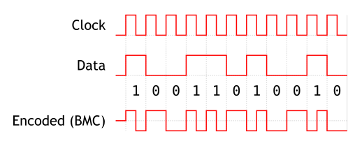

Now giving it a second thought. There is also `Differential Manchester Encoding', also known as, Biphase Mark Code (BMC), Frequency Modulation (FM), or F2F (frequency/double frequency).
Unlike with Manchester encoding, only the presence of a transition is important, not the polarity.
Which helps to eliminate noise on tape.
BMC / DME / FM - encoding
But how to decode this stream?
