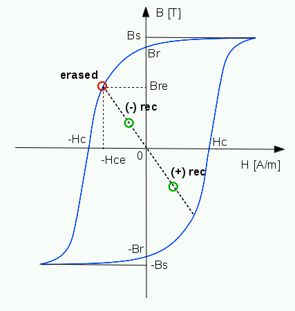

Now I also went through `ZX Interface-I & Microdrive' service manual. This caught my attention.
Knowing this, I can now correct the earlier diagram, now showing two currents with different bias. The current switching is done by MD ULA amplifiers? As the erase current is some 30mA, I just estimate that in one direction twice as high current is needed in writing through R/W coils.
Tomas
This asymmetry is caused by the fact, that in one direction a higher coercive force is needed that in the other, to overcome erased record which is a singular in the top left quadrant. `Bre' - remanent magnetism of erased record, `Hce' - its coercive force.DATA 1 and DATA 2 are used to drive current sources for track 1 and track
2. When DATA 1 is h i g h , for example, current is pul led in one
di rect ion through the head, when it is low current is p u l l e d in
the other direct ion. Wr i t i n g is done wi th an asymmetric write
current. Because the erase function is carried out wi th a d.c. f ield
it is necessary to write 'ha rde r ' in one direction than in the other
to overcome residual magnet ism. Resistors R4 and R5 on pins 11 and 7
of IC1 are chosen to al low this action. Should a di f ferent tape be
introduced or a di f ferent head type be fitted these resistors would
also need to be changed.

Thank you for reading my post. You are possibly right, in my 2nd diagram I just wanted to show how current is biased in one or the other direction through R/W coils. Frequencies just show that series of "1" ones need twice as many transitions to series of "0" zeroes.
The actual encoding I tried to show earlier with this picture, in naming it, I was lead by ZX and QL service manuals referring to it as FM.
