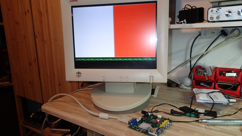

Yesterday i got my GBS-8200 Ver4.0 and i was able to connect a standard VGA monitor to the QL. The pins were the classic ones RGB,GND and Csync.
The solution works perfect with a German QL issue 7, but no chance with my English Issue 5 one. But i am already aware that this machine has unstable signals, even on the digital site. I am getting only noisy pictures on all outputs from it (time to look for the error).
The VGA converter works with all modes. No chance to test with a Q60.
QLObi
Latest news: On my issue 5 i added the resistor (1K Ohm), described earlier, in seriell to the C-Sync line and got a stable picture. On the oszillocope i saw a serious defoming of the signal wihout the resistor. I put also 100 Ohn in seriell to the RGB line to protect the ZX8301.
The noisy internal signals of the Issue 5 just causes a very light noise on black areas. But who cares if you now can use a cheap standard mointor. On the picture the monitor is in 1024/768 mode, so the QL picture is strechted a bit in vertical, but that can be adjusted on your demand.
I paid just 30 Euro (inc P&P) in ebay for the adapter.

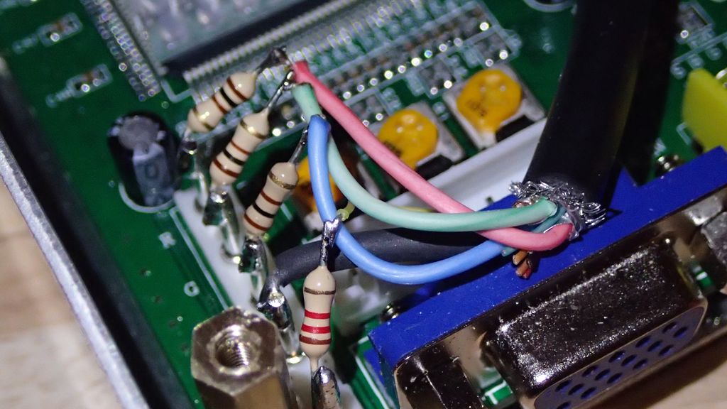

Latest news on GBS-8220.
Beside the resistor (1k to 2k) in seriell to Csync it's also important to use shielded wires for RGB and
normal wires for the sync signal. Otherwise you might encounter a light disturbance on showing characters on the screen.
The sync signal might work also with a shielded wires, but in generell there is a unbalance between impedance of cable and input/outout of devices.
Resistors in seriell to the videosignals (50 to 100 Ohm) can be omitted, just protection. If you install them, put them as close as possible to the QL (in the plug).
Version od GBS needs to be V4 and higher.
In this configuration my Black Box with GBS-8220 was shown on the 30isShow in Edinburgh.

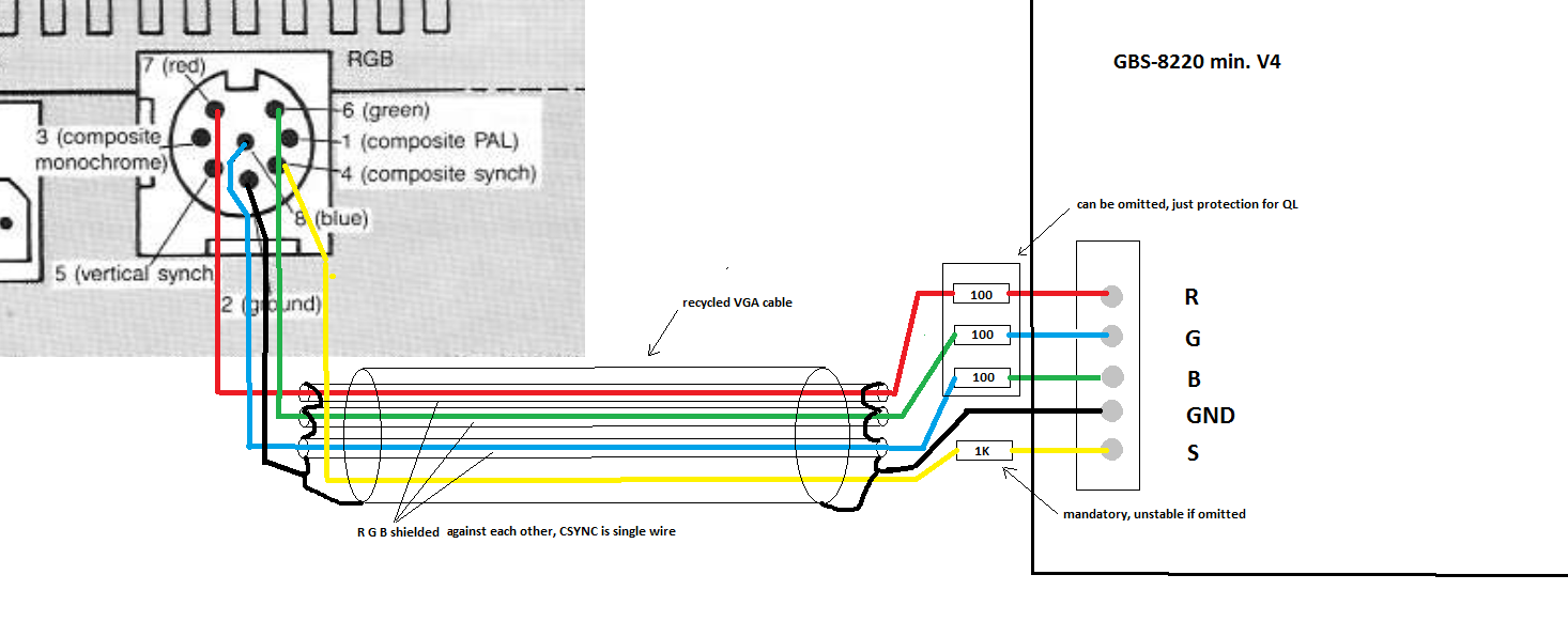

Detlef
Posts: 4732
Re: GBS-8220 RGB TO VGA Converter
Hi Detlef,
I thought the display on your QL at Edinburgh was excellent.
Can you post a diagram of the connections from QL to GBS8220.
So that everyone can use this interface correctly.

Hi Derek,
i draw my configuration on a paint picture. Hopefully not to technical.
The other picture shows the real converter as used on the Edinburgh meeting.
Detlef
ps: As already mentioned, best place for protection resistors is as close as possible to the QL. But easiest is at the pinheaders of the GBS8220. There is next to no impact to the picture.
It's also a good and safe practise to isolate with shrinking tub. For better demonstation of the resistor not done here.
