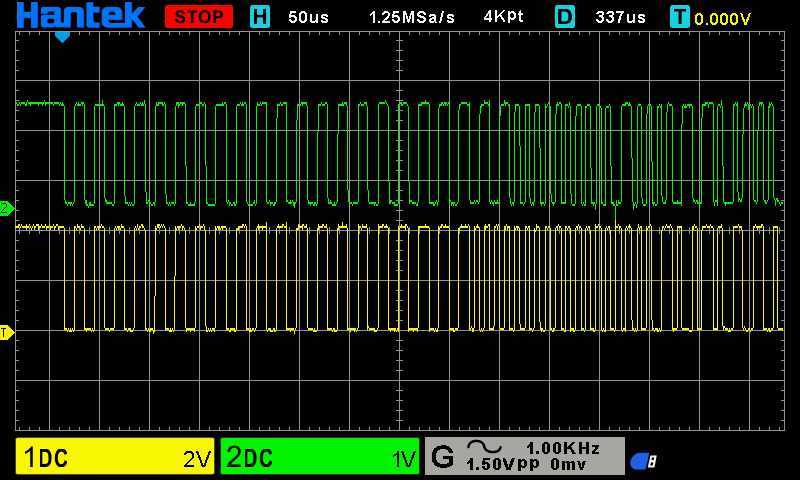

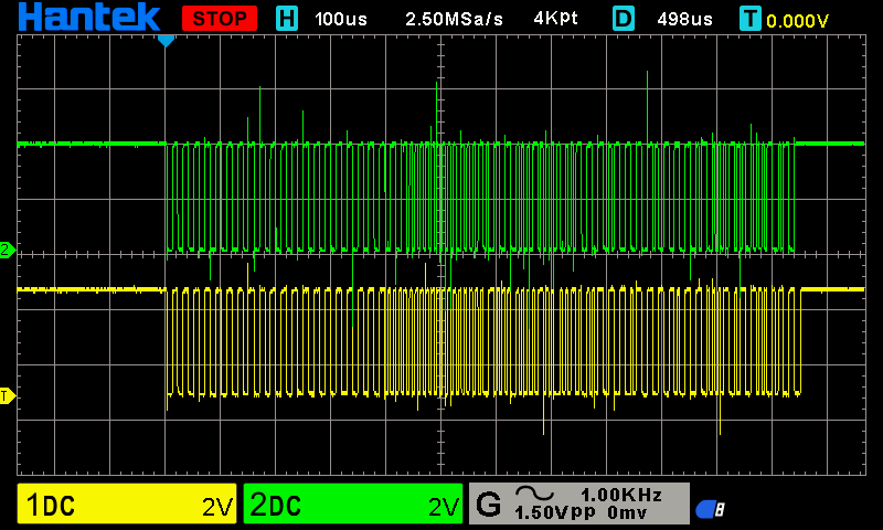

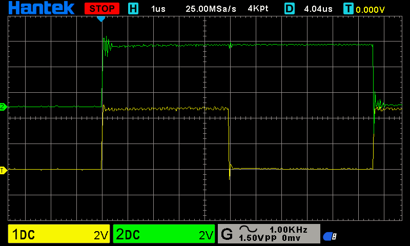

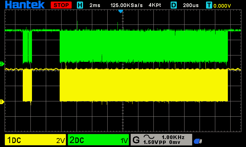

Yellow is track1, green track2.
I prepared a few screen shots from the oscilloscope:
1. a few sectors
2. one sector
3. a header
4. a header's data in more detail
5. bit_timing : shows the bit timing in 1μs scale

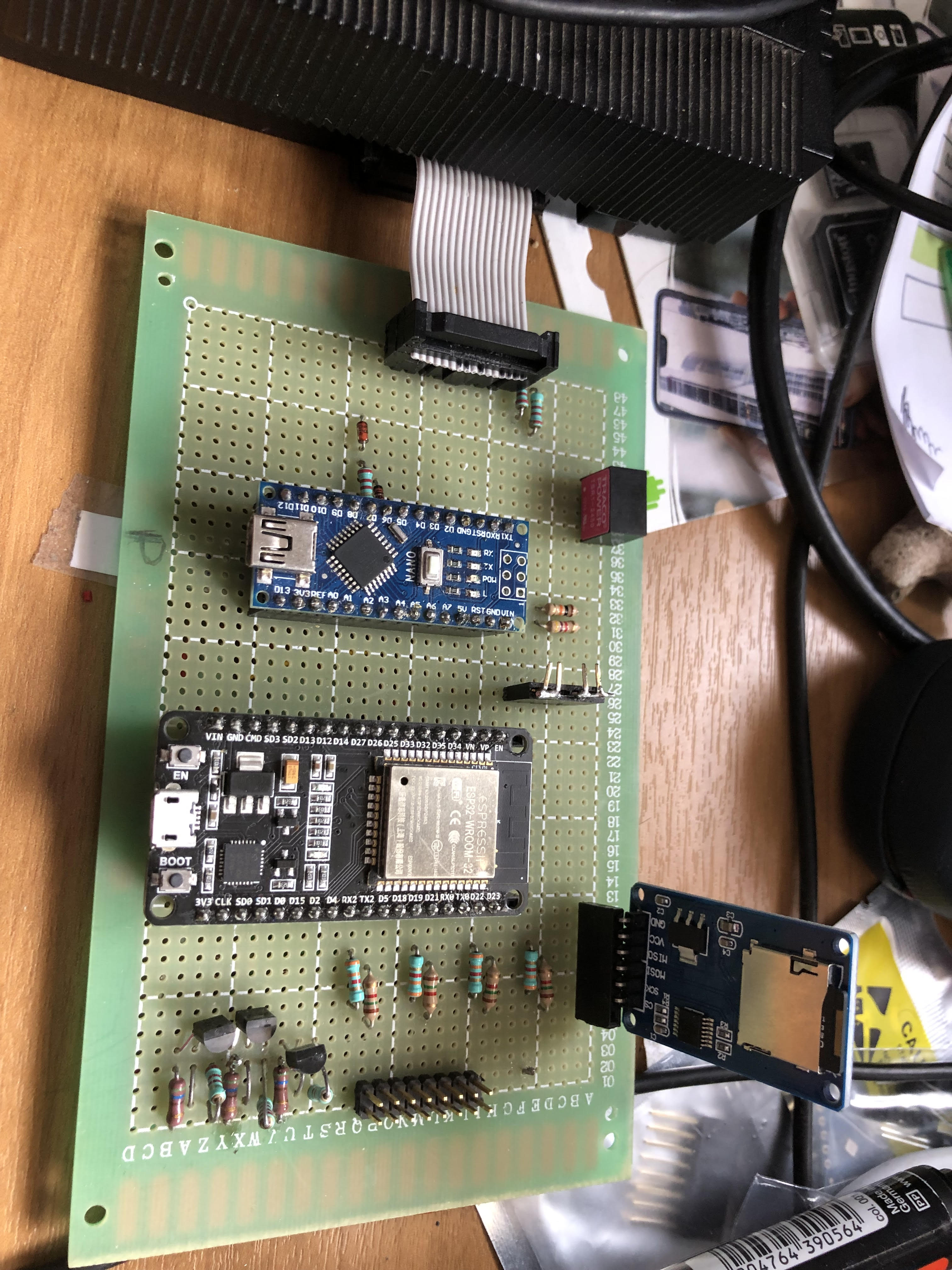

Here you can see the test board and more details of the data on the tracks.

Those traces look good to me from a timing and voltage level point of view.

b. Those over/under shoots (under-damped) beyond 5v/0v might be upsetting the ZX8302 - perhaps try adding some extra capacitance to RAW1/2 to dampen the transition artefacts.

I just checked again my connections. I have
TRACK1 data-> Nano A4-> 2.2K Resistor -> EDGE CONNECTOR TOP.1
TRACK2 data-> Nano A0-> 2.2K Resistor -> EDGE CONNECTOR BOTTOM.1
which I believe is correct. After the problems I had I copied this design from oqtadrive but it did not seem to help.
I will also try to add some small capacitors to the track lines in order to smooth them up.
