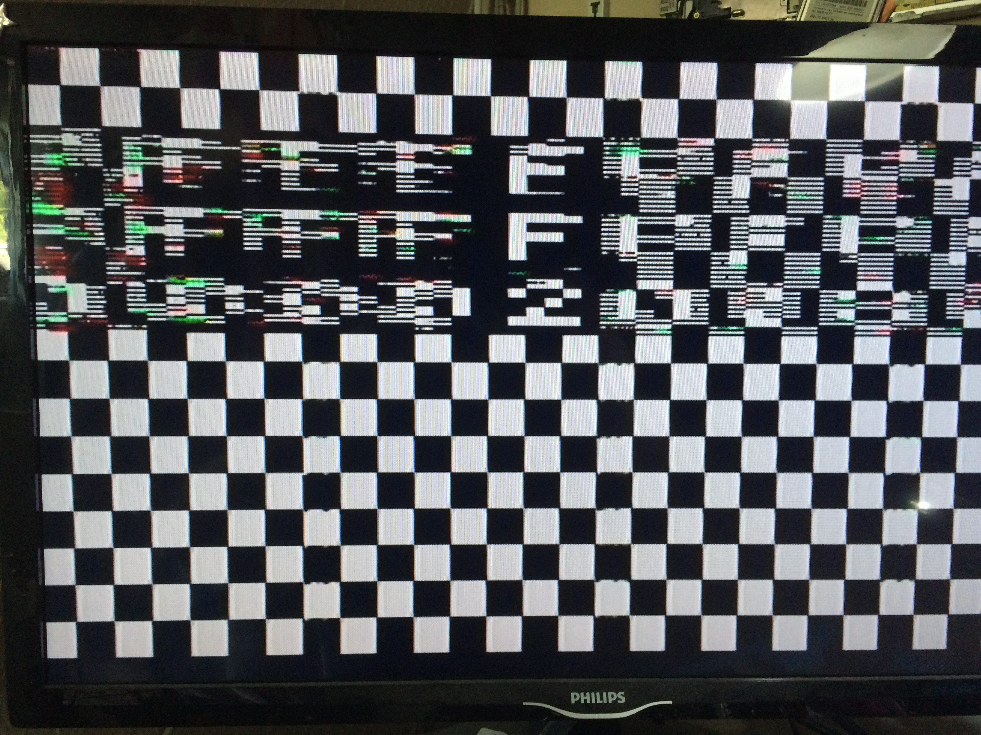

just another thought - how are you connecting the monitor to the QL - is it via RGB lead ? If so, try unplugging the MC1377P chip, it is not needed for RGB output, and it does have a connection to SYNC (VSYNC) which is fed to the ZX8302 chip to control frame interrupt -which is in effect the heartbeat of the QL and which allows multitasking. if this pin is loaded by the chip or by the monitor, it may affect the QL's behavior - the pin is directly connected from the 8 pin RGB socket to the ZX8301 and ZX8302 - there is no resistor or protection for it.
Cristian
Posts: 1024
Location: Veneto
Re: All RAM chips destroyed??
Post by Cristian »
Pr0f wrote:check this pin on the ZX8302 chip to 5v and GND and see if there is any short circuit there. This is Pin 2 on the chip. There is a resistor between this pin and 5V line - value is 3.3K, so there should be some resistance when measuring to 5V.
Updates about repair status.
- Cheched resistance value between pin2 and 5V: I got 3.3K as expected. Almost same value when checking pin2 and GND.
- All edge connector pins (as told before) look perfectly aligned, included EXTINTL.
- Removing MC1377P does not produce any effect.

Hi Cristian,

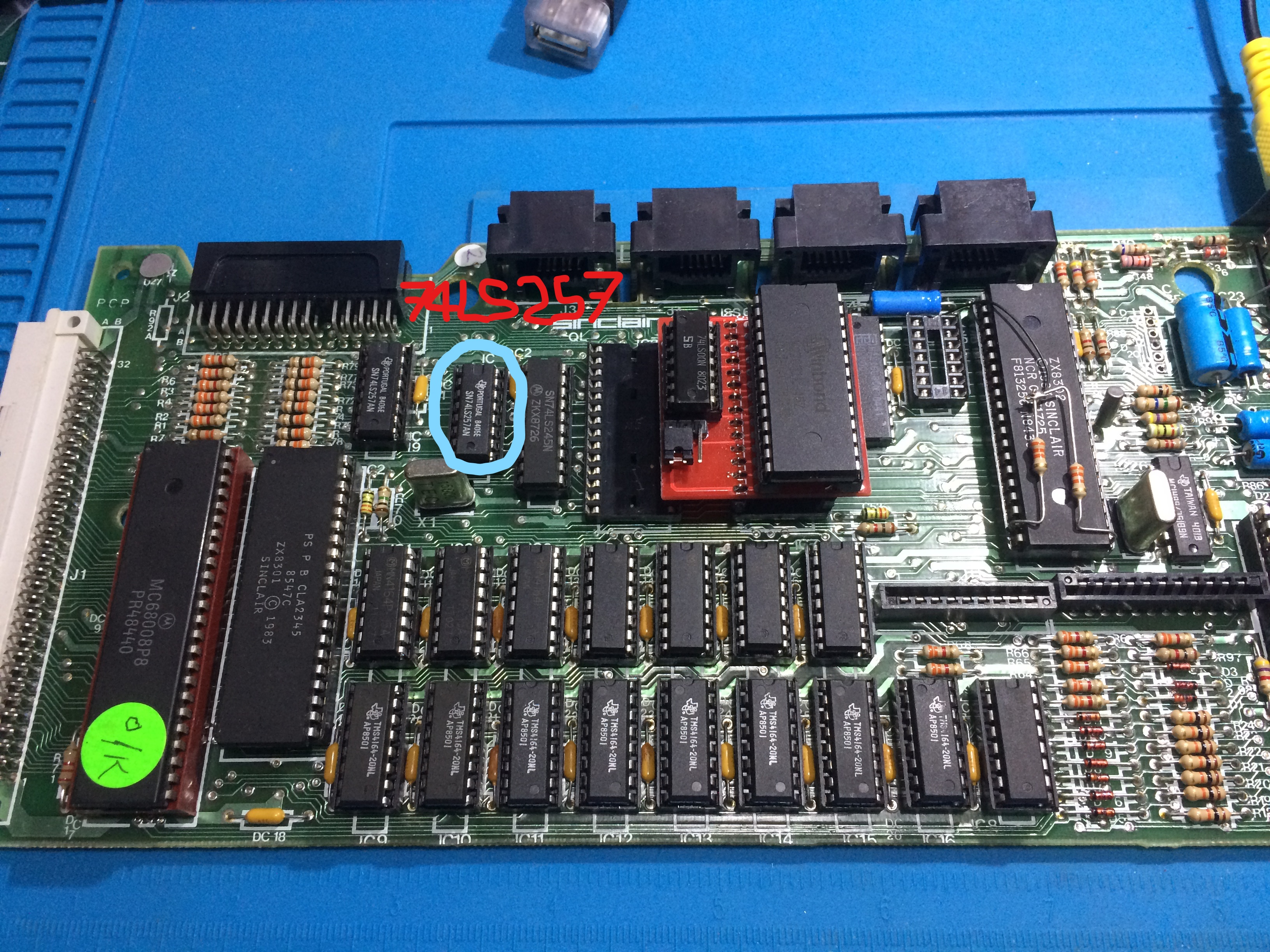

I have been following this thread for a while as I to have a QL which will not boot and gives a garbled screen, at first I replaced the decoder logic chips (74LS257's and LS245) and it made little difference. So, as you do sometimes, you put the computer away and start another project. Well after a while it was this machines time again and reading about similar issues it was suggested to replace the ULA 8301 as this was know to cause this type of problem. So I tried it and it made no difference again.
Weeks passed before I could get hold of a new (old stock) 8302, but still no go, I could see there was an issue with the data lines as the output was low on some of the address lines, but could not track it down. So in for a penny, in for a pound, I de-soldered all the main logic and memory chips, including the video decoder.
I have a Commodore 64 that I tested the memory chip with and yes one was faulty, 'found it' I thought.., but no.
So I ordered more memory and a new MC1377 and a new CPU (10MHz). Did it work, of course not, So I tried the Minerva ROM with the better memory checking routines.
But still no go...
What can it be, a fault on the motherboard itself, I hope not I have spent weeks of my life on this machine, I will get it go if it kills me....
Deep breath, Think... you know it's a memory address problem, start again from scratch... So I went back to the address decoders and it WORKS NOW !!
It was one of the 74LS257's that I replaced many months ago.
I have a Mini Pro programmer that tests TTL and Cmos IC's and it has not let me down before, but it passes the LS257, but it will not work in the QL.
So I have modded the modulator and I still have one chip that gets quite hot, but still works fine, the RS232 line driver chip. Still not a real problem.
The moral of the story is, never give up! But if in doubt, start again...
I hope this gives you some words of encouragement.

Technical-Chap wrote:Deep breath, Think... you know it's a memory address problem, start again from scratch... So I went back to the address decoders and it WORKS NOW !!
You totally lost me with this post. :? It looks like you said it is the 74LS257 but they are not the chips in the picture are they? Then some mention of line drivers and you say you modified the modulator but what has that to do with the problem? I have a similar problem as on this thread so it looks like there might be a circuit weakness or maybe a fundamental design timing problem that sticks multiple outputs on the bus for a fraction of a second causing different things to go toast on different boards. :roll:
Posts: 1552
Ruptor wrote: ... and you say you modified the modulator but what has that to do with the problem?
They way I read his post is that the modulator mod was an additional change not one related to the initial memory issue.

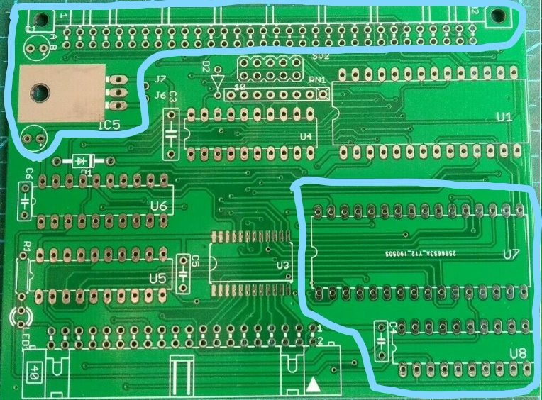

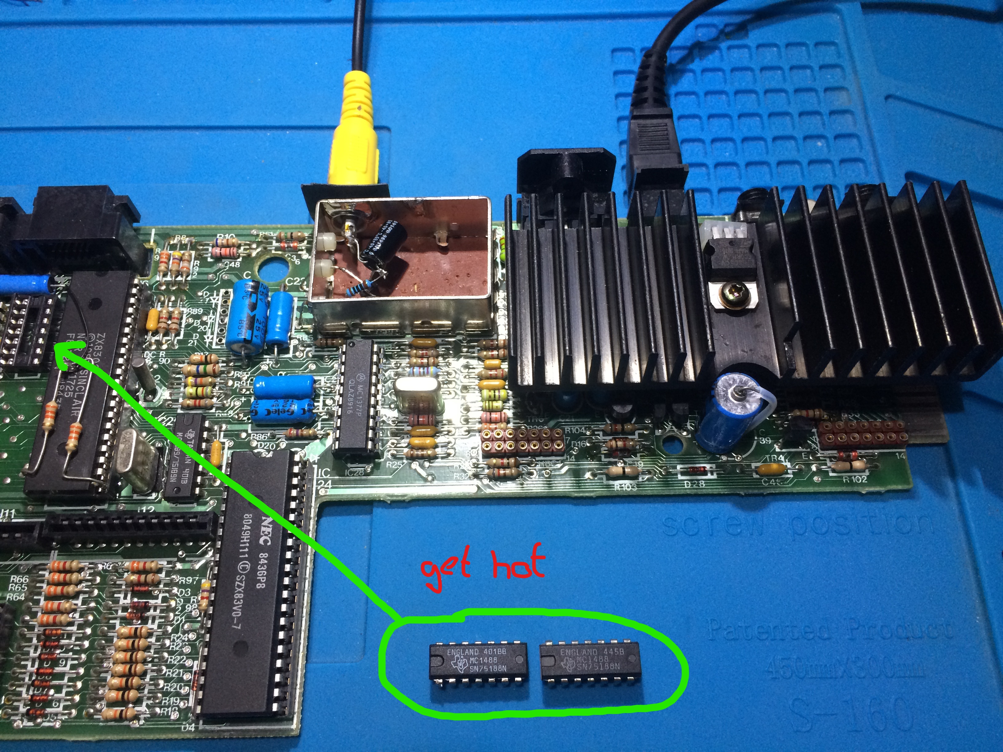

I am not to worried about the hot 75188 line driver, I don't use the serial port for much, as you can see below, I use one port for the ROM selection and ToolKit on/off, I leave port one available - just in case.
This is my issue 5 board, but both machines are now the same. The real time clock mod does not include the new reset mod, but it works most of the time.. (get it!).
As for cheep memory, the clone of the QubIDE PCB is easy to get from eBay with just PAL 3 and CMOS 512KB chip, 640K is not hard to get to.
Just to clarify, I have only looked at the schematic and will test this today and give an update, but can't see why it would not work. But if you are going to do this much you might as well build the whole board and have IDE to.
