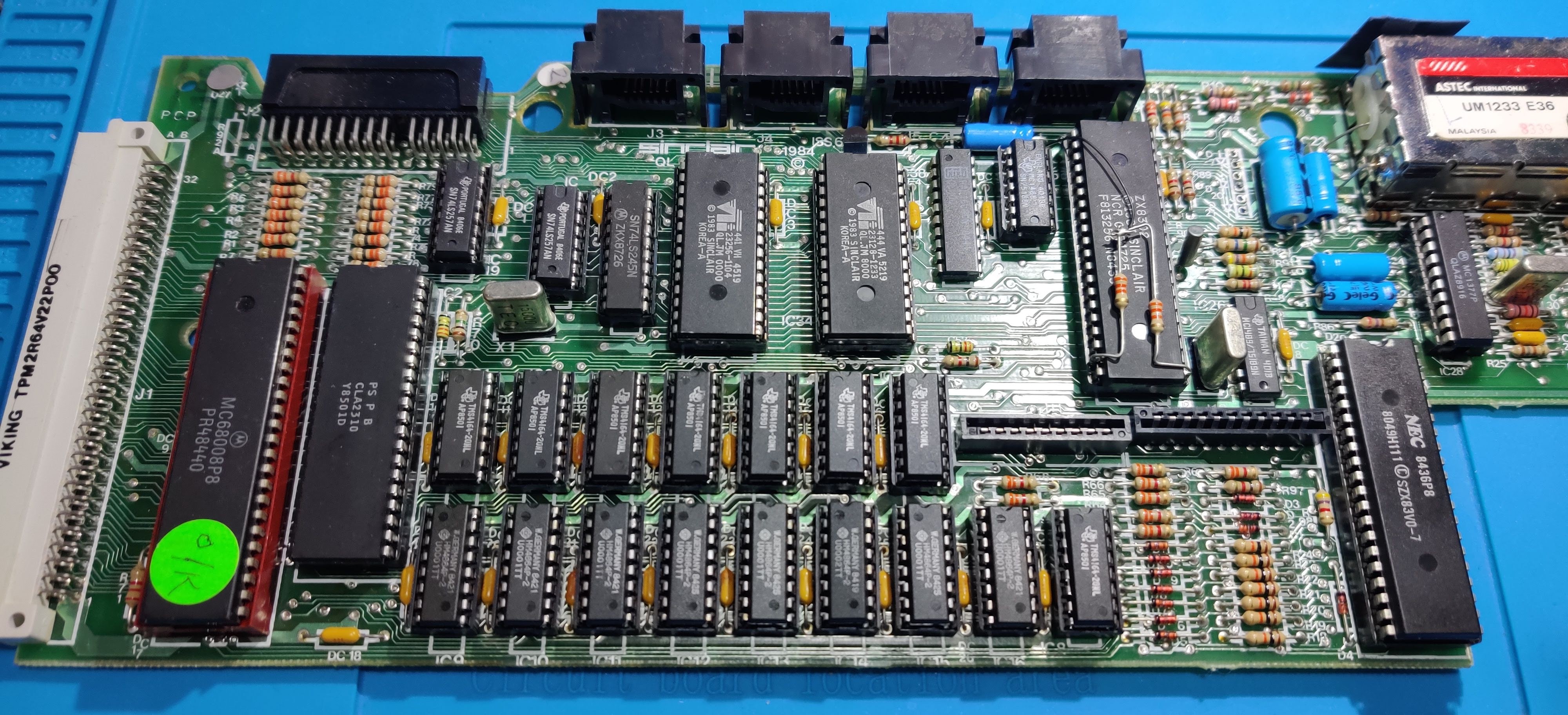

- Found some "strange" solderings in the resistors near the ROM expansion port. For what I know, they might be perfecly normal, but I'm not sure so I attach a picture:

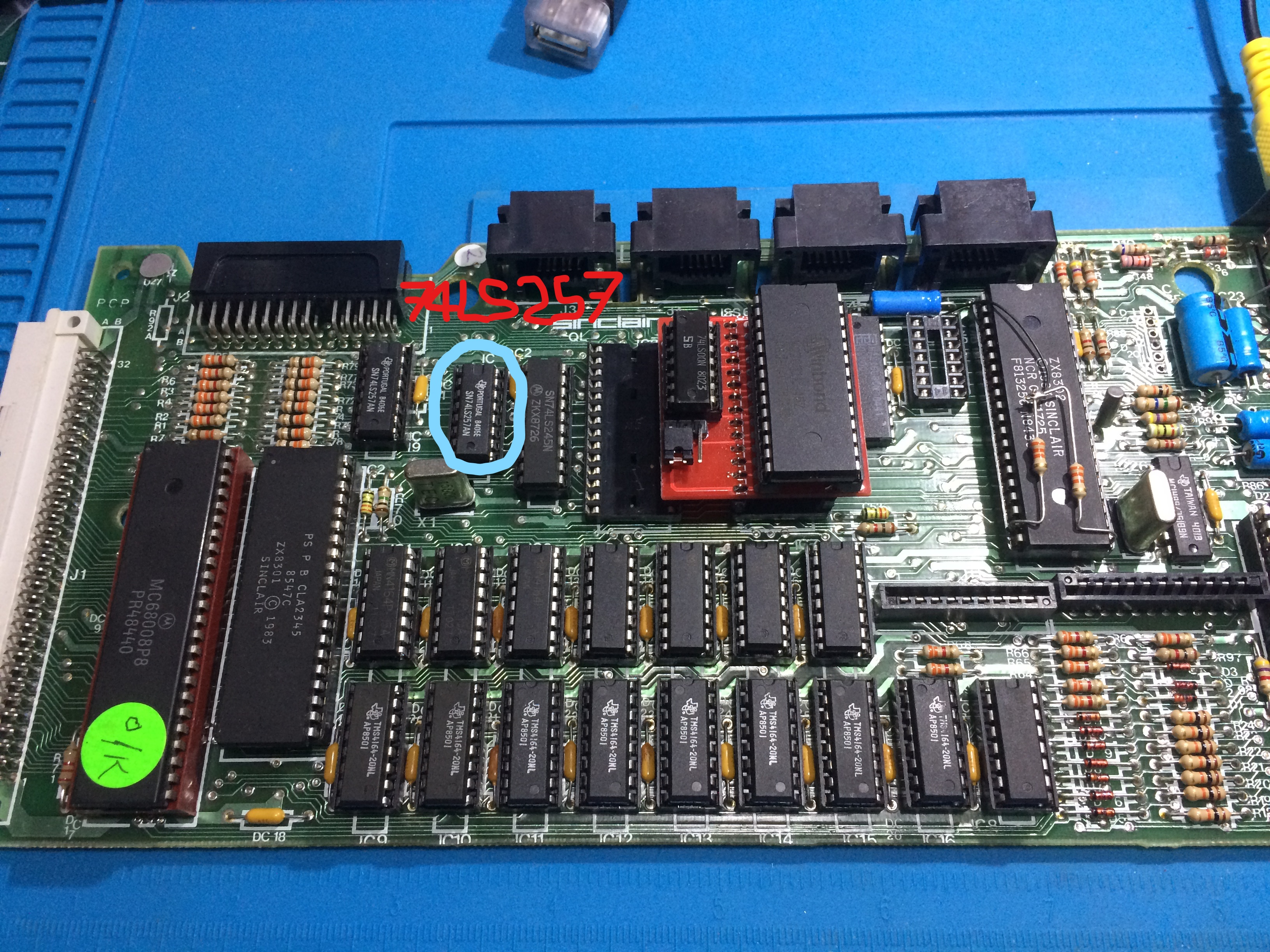

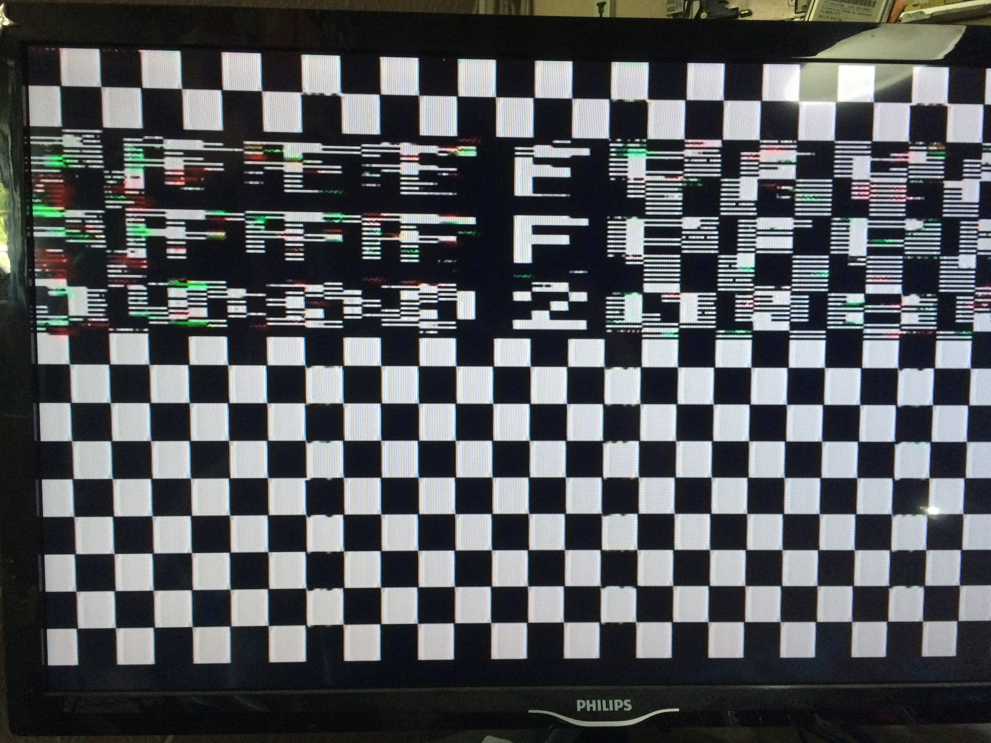

I have been following this thread for a while as I to have a QL which will not boot and gives a garbled screen, at first I replaced the decoder logic chips (74LS257's and LS245) and it made little difference. So, as you do sometimes, you put the computer away and start another project. Well after a while it was this machines time again and reading about similar issues it was suggested to replace the ULA 8301 as this was know to cause this type of problem. So I tried it and it made no difference again.
Weeks passed before I could get hold of a new (old stock) 8302, but still no go, I could see there was an issue with the data lines as the output was low on some of the address lines, but could not track it down. So in for a penny, in for a pound, I de-soldered all the main logic and memory chips, including the video decoder.
I have a Commodore 64 that I tested the memory chip with and yes one was faulty, 'found it' I thought.., but no.
So I ordered more memory and a new MC1377 and a new CPU (10MHz). Did it work, of course not, So I tried the Minerva ROM with the better memory checking routines.
But still no go...
What can it be, a fault on the motherboard itself, I hope not I have spent weeks of my life on this machine, I will get it go if it kills me....
Deep breath, Think... you know it's a memory address problem, start again from scratch... So I went back to the address decoders and it WORKS NOW !!
It was one of the 74LS257's that I replaced many months ago.
I have a Mini Pro programmer that tests TTL and Cmos IC's and it has not let me down before, but it passes the LS257, but it will not work in the QL.

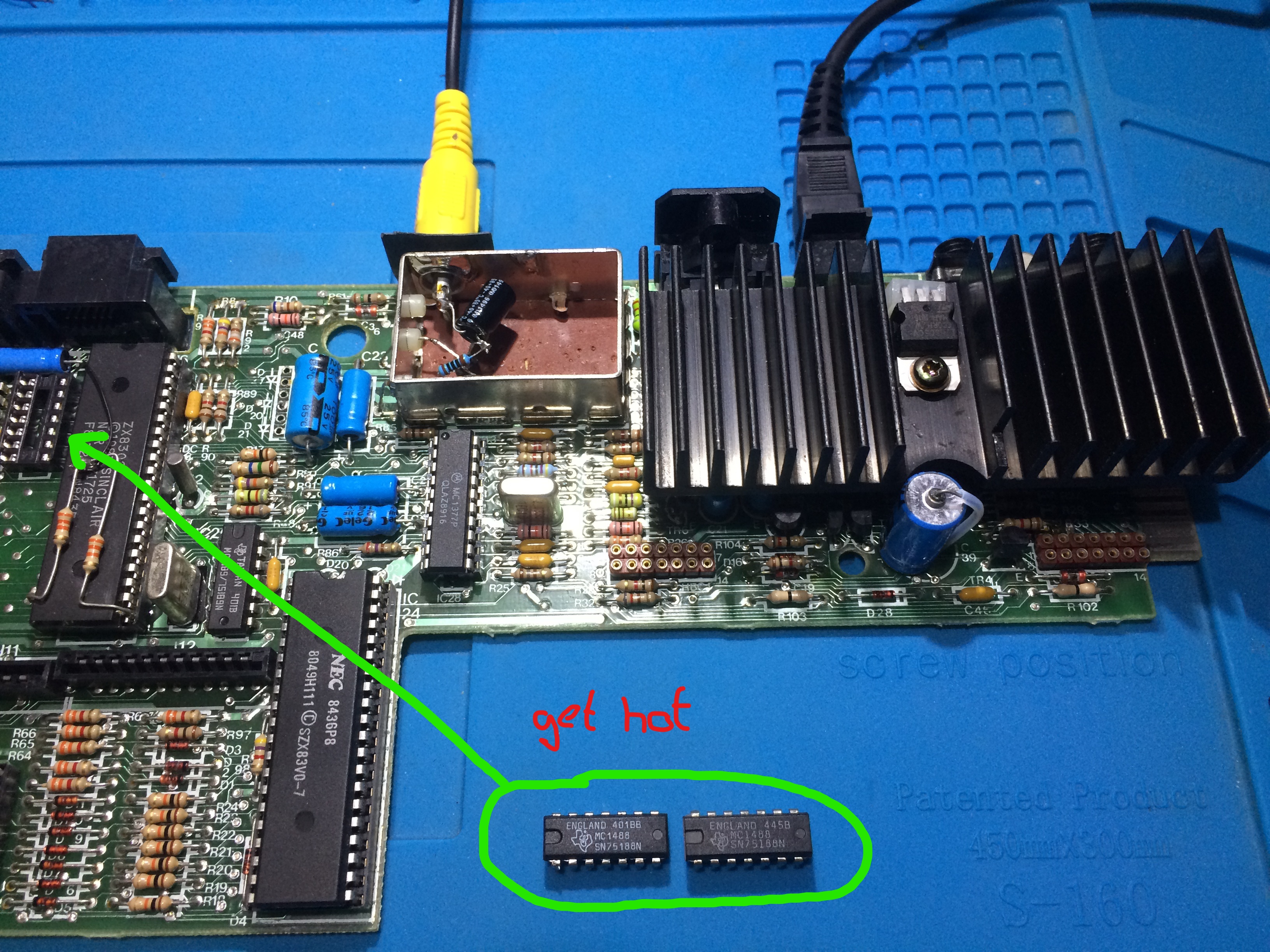

So I have modded the modulator and I still have one chip that gets quite hot, but still works fine, the RS232 line driver chip. Still not a real problem.

It looks like you said it is the 74LS257 but they are not the chips in the picture are they? Then some mention of line drivers and you say you modified the modulator but what has that to do with the problem? I have a similar problem as on this thread so it looks like there might be a circuit weakness or maybe a fundamental design timing problem that sticks multiple outputs on the bus for a fraction of a second causing different things to go toast on different boards.
You totally lost me with this post.Technical-Chap wrote:Deep breath, Think... you know it's a memory address problem, start again from scratch... So I went back to the address decoders and it WORKS NOW !!

Speaking of the modulator mod, it looks like almost everything was taken out of there and now I'm guessing the QL gives you composite from that RCA connector? I grabbed composite off of pin 7 from the MC1377 IC and routed it to pin 3 on my DIN socket with a resistor and a switch mounted on the modulator case with hot glue giving me color and bw composite on the same DIN cable with a flip of the switch. The b&w composite signal is so crisp I haven't gone back to the color composite in some time and I had even bought one of those SCART to HDMI converters but it came dead-on-arrival and haven't bothered since as my current project only needs b&w.

Yes as already said the last two comments were extra to the RAM issue. As I do on all old British computers from the eighty's and early ninety's I put a simple PNP amp circuit, this gives a colour composite output on most machines, some need a bit more work or the signal inverting. I am not to worried about the hot 75188 line driver, I don't use the serial port for much, as you can see below, I use one port for the ROM selection and ToolKit on/off, I leave port one available - just in case. This is my issue 5 board, but both machines are now the same. The real time clock mod does not include the new reset mod, but it works most of the time.. (get it!).
