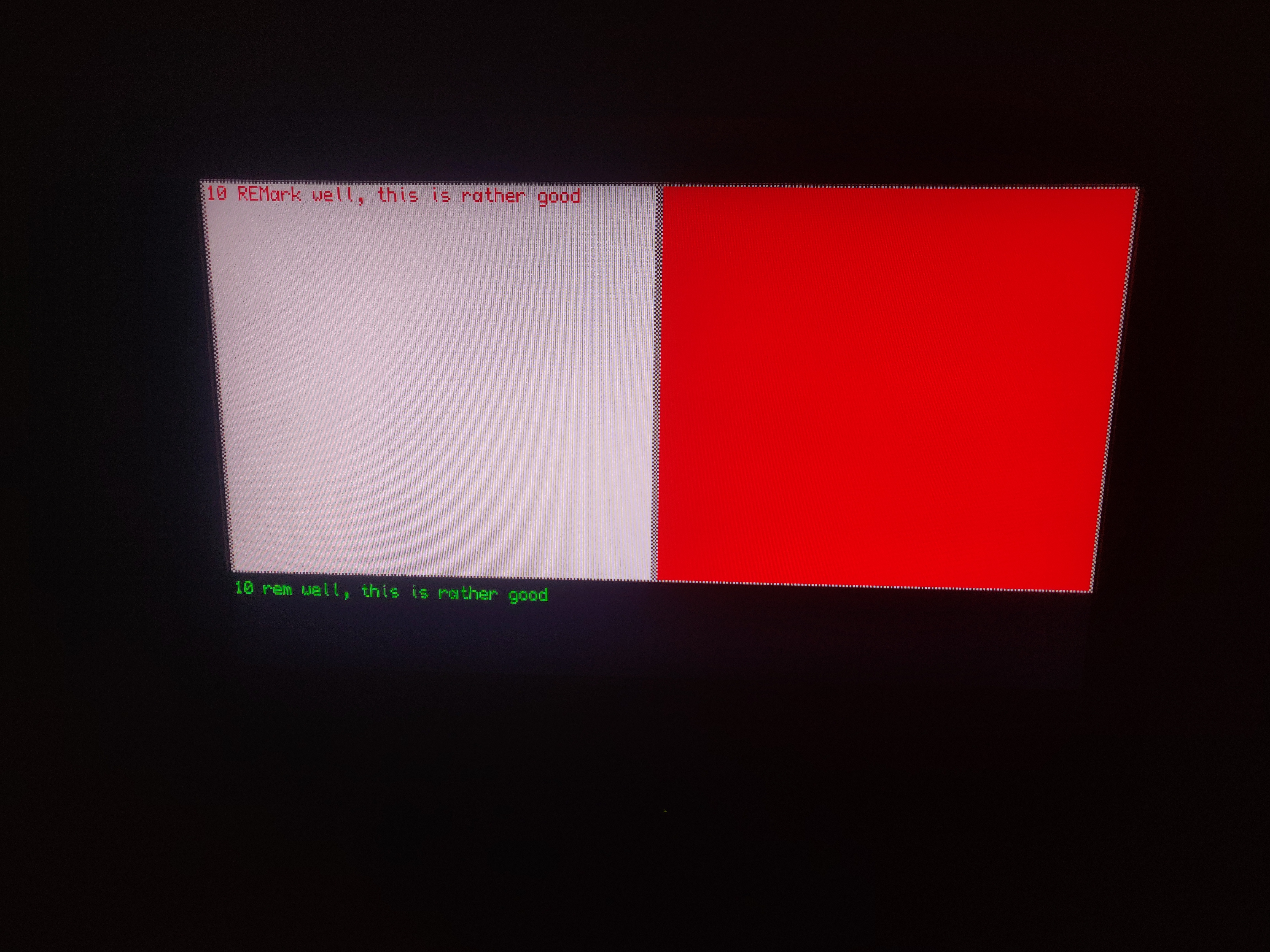

Last night, at 1am, I couldn't sleep, so decided to make one of these.
It's not gone well : :roll:
Please help, I have 2 basic questions:
1) the the led flash every two seconds if everything is working correctly? (Mine is doing that)
2) without the QL plugged in, does it display a holding screen? (Mine has no signal at all)
On gp16 and GP 17, I'm getting a voltage reading after the resistors 2.9v and 3.3 volts respectively.
I'm using the Pico 2020 and the .5 firmware.
Any help is much appreciated
Update*
On the TV, plugging it in causes the TV screen to go black and all the buttons on the TV stop working!
Further update*
I screwed up the soldering on the VGA end. I grounded pin 4 - wrong.
Think I've got v sync and h sync on the wrong pins too.
Who knew such soldering at 1am could produce such errors!

Alright!!
