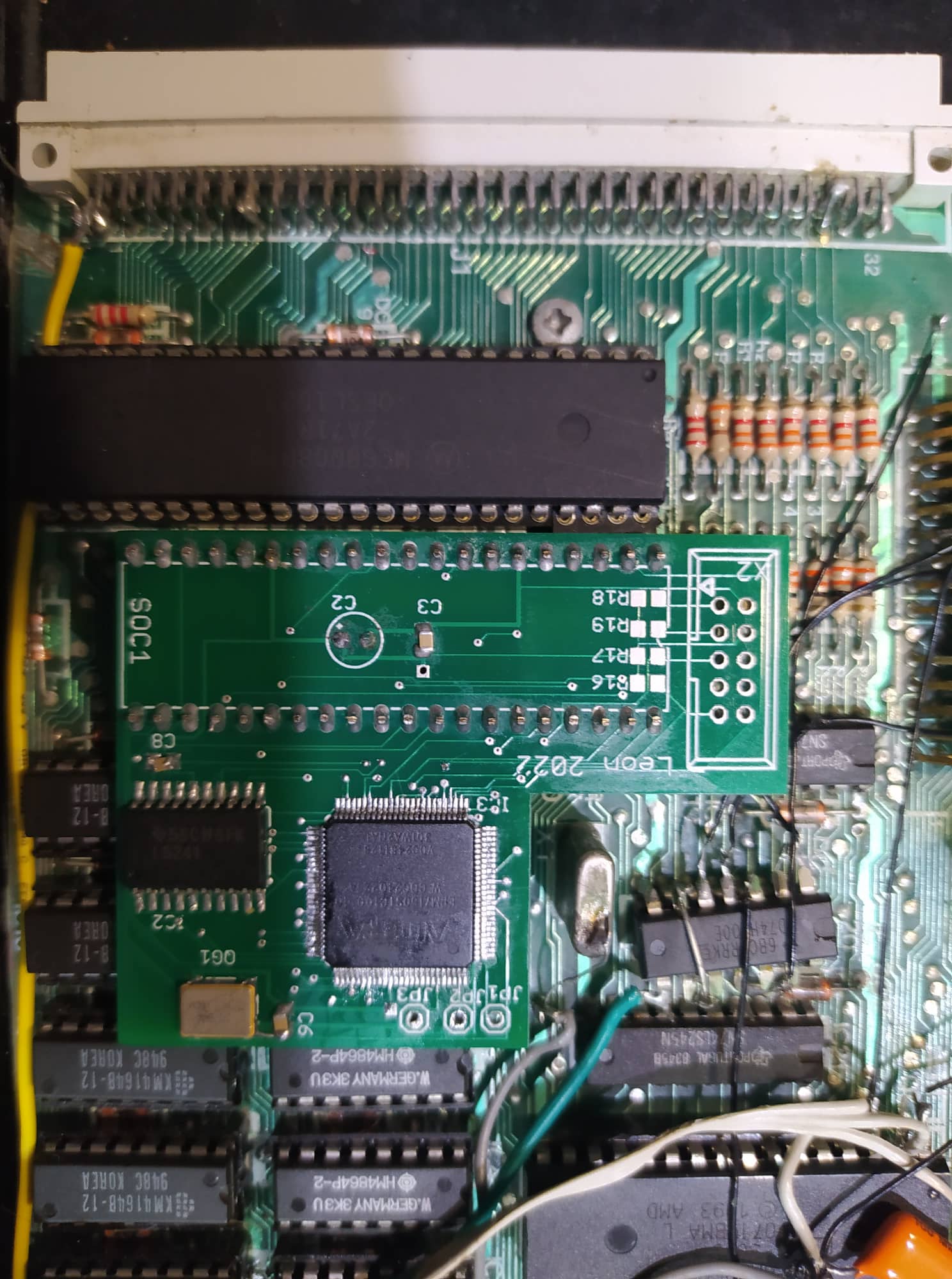

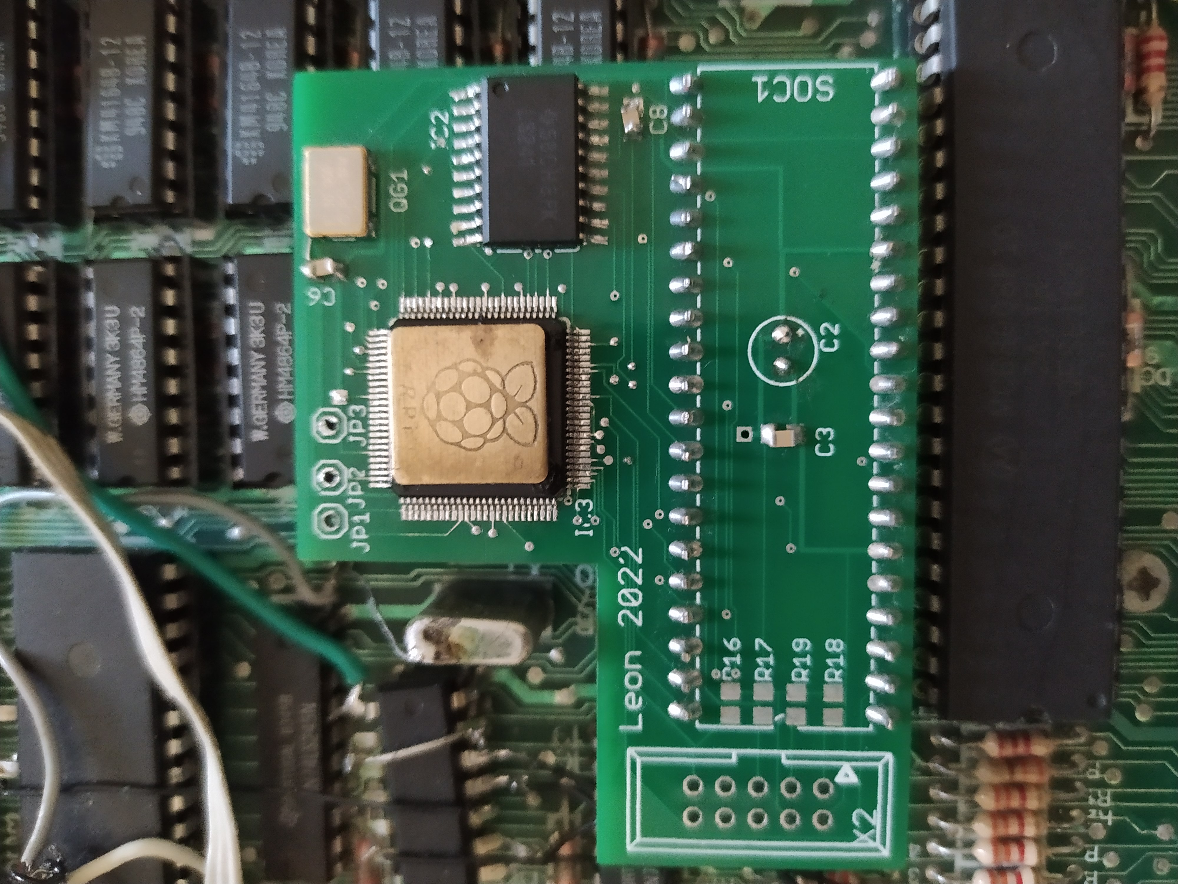

Here a new pcb with the EPM7160STC100-10 that is smd and fits also in QL's with socketed rams.
It was difficult to solder it now that I'm older and can't see very well but finally I did it.
It gets hot, hotter than the PLCC84 cpld, I'll put a small flat heat-sink on it even I don't think it is necessary, now there is enough space.

Here

kudos to the soldering skills for that beast - was that done using a lot of flux and dragging a blob technique, as no one has an iron that small :-)

Pr0f wrote:kudos to the soldering skills for that beast - was that done using a lot of flux and dragging a blob technique, as no one has an iron that small :-)
I have a soldering iron this small but still prefer the drag technique ;) Nice job anyway, I just wonder if it's normal that it would get this hot.

Don't know but it is a 5 volt small device with almost all its macro-cells used, clocked at 10 and 15Mhz (clocks derived from a 30Mhz active oscillator) and continually drives a lot of QL lines, maybe it is normal. It runs for hours with no problem so far with that small heatsink. You can touch the heatsink only for a couple of seconds.
Powered from an external ps when I was programing it not connected to the QL the whole circuit drew about 200ma. Do you think there is something wrong with the ic;

Yes I used something like the dragging a blob technique with lot of flux

The turbo bit option was in auto by default, I change it to off and the temperature dropped without affecting the operation!
Now it gets just warm but not hot.
