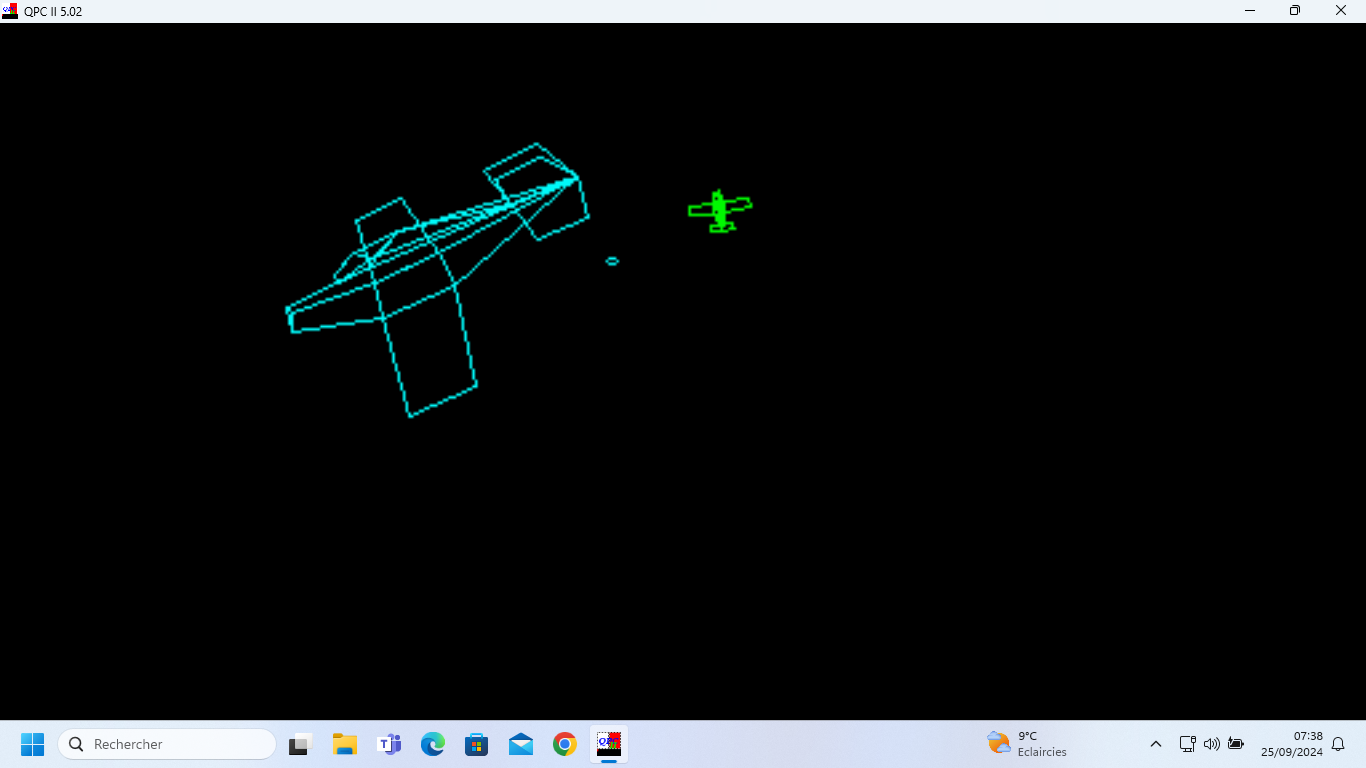

Just back from holidays, so I reset my PC and ran Planes7_bas again. You may have a quirk with the program :
Type PAPER 0: CLS before running. Also some planes get so near the viewing point that lines cross the screen. Wiil do a fix...
May do flight paths following trajectories, but that will mean adding a lot of extra code. Using two planes took much memory !
Thinking too about the 4D 'tank war' program somebody requested. Could be an interesting project. Regards, Steve.

Hi Folks,
Just putting the finishing touches to the latest 'Planes' program. Here is a preview of the 'four plane' version.... much harder !
