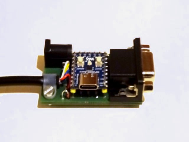

For those who like an easy to solder version, but not fitting a D-Sub hood, I designed a larger PCB, sized 50 x 30.8 mm:
The QL is protected by a diode from feeding back +5V into the machine, if it is not modded.
A cable clip can be provided, I had to add a little glue to fix it properly.
Please find Gerbers (for Aisler), schematics and placeplan attached. Have fun.
Side note: The holes for the module pins are nominally 0.8 mm. On my prototype PCBs, this was closely sufficient for modules with pre-soldered pins.
If other PCB manufacturers are used, especially cheaper ones with high tolerances, pins should be selected with care.
+5V power can be supplied by UBS-C at the side, a Q68-style 2.1mm coaxial connector at the rear (center is +) or from a modded QL.The QL is protected by a diode from feeding back +5V into the machine, if it is not modded.
- qlvga-rp2040-1.0-schematics.pdf

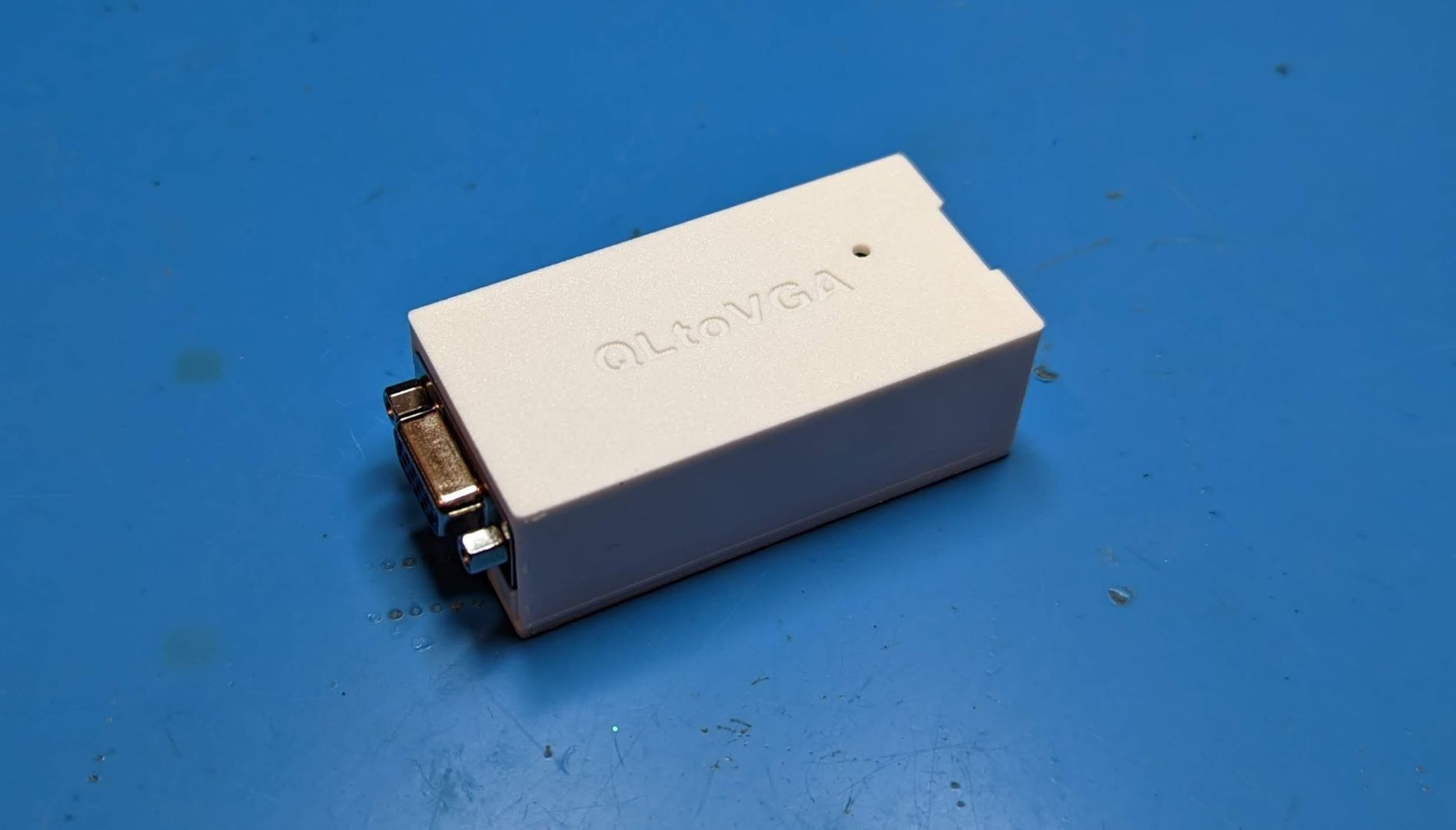

Another PCB/Case option I whipped up that uses the full size Pico, https://github.com/djtersteegc/video_if ... doc/pcb.md
- Posts: 4817
Re: QL Pico VGA
Looks very neat, I would make the case black.
I have ordered some PCBs for the RP2040-Zero, just waiting for delivery.
But I like the design of the full size RP2040 version. Maybe I will make some as well.

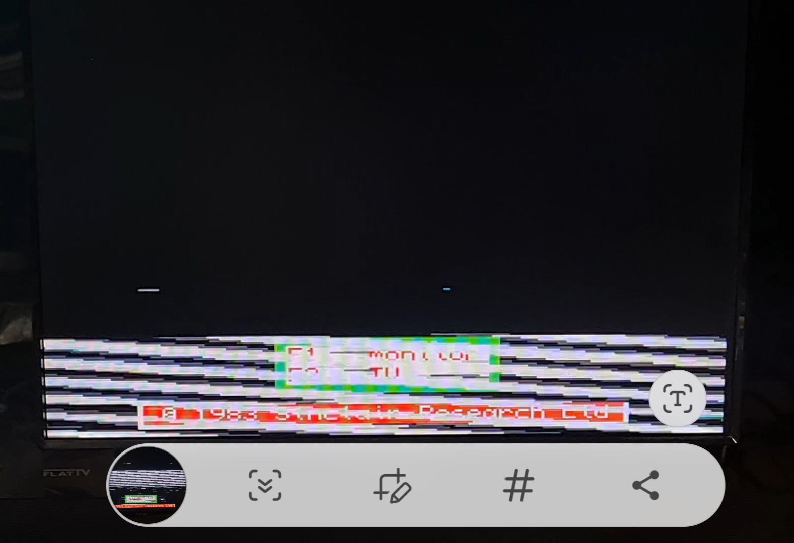

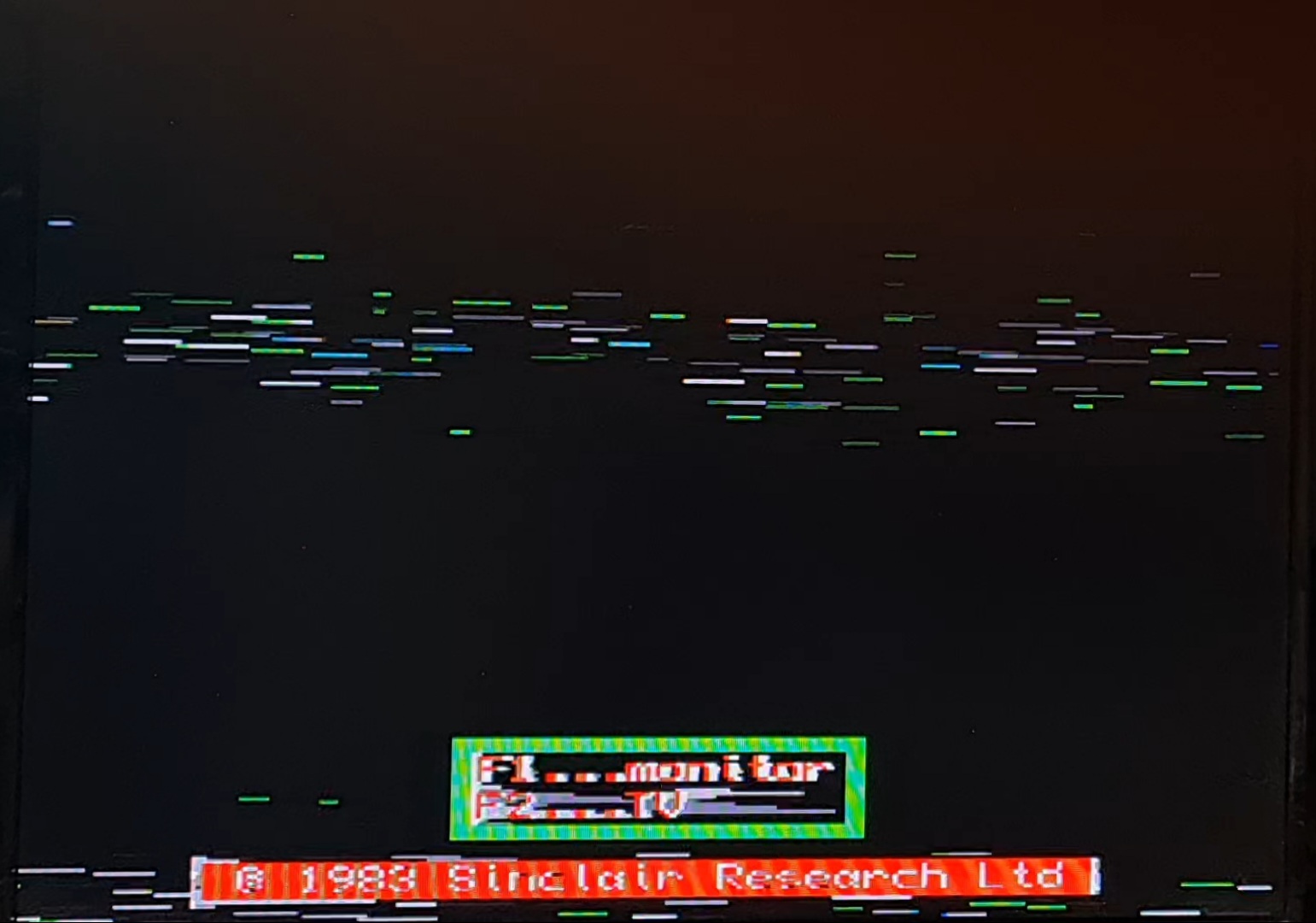

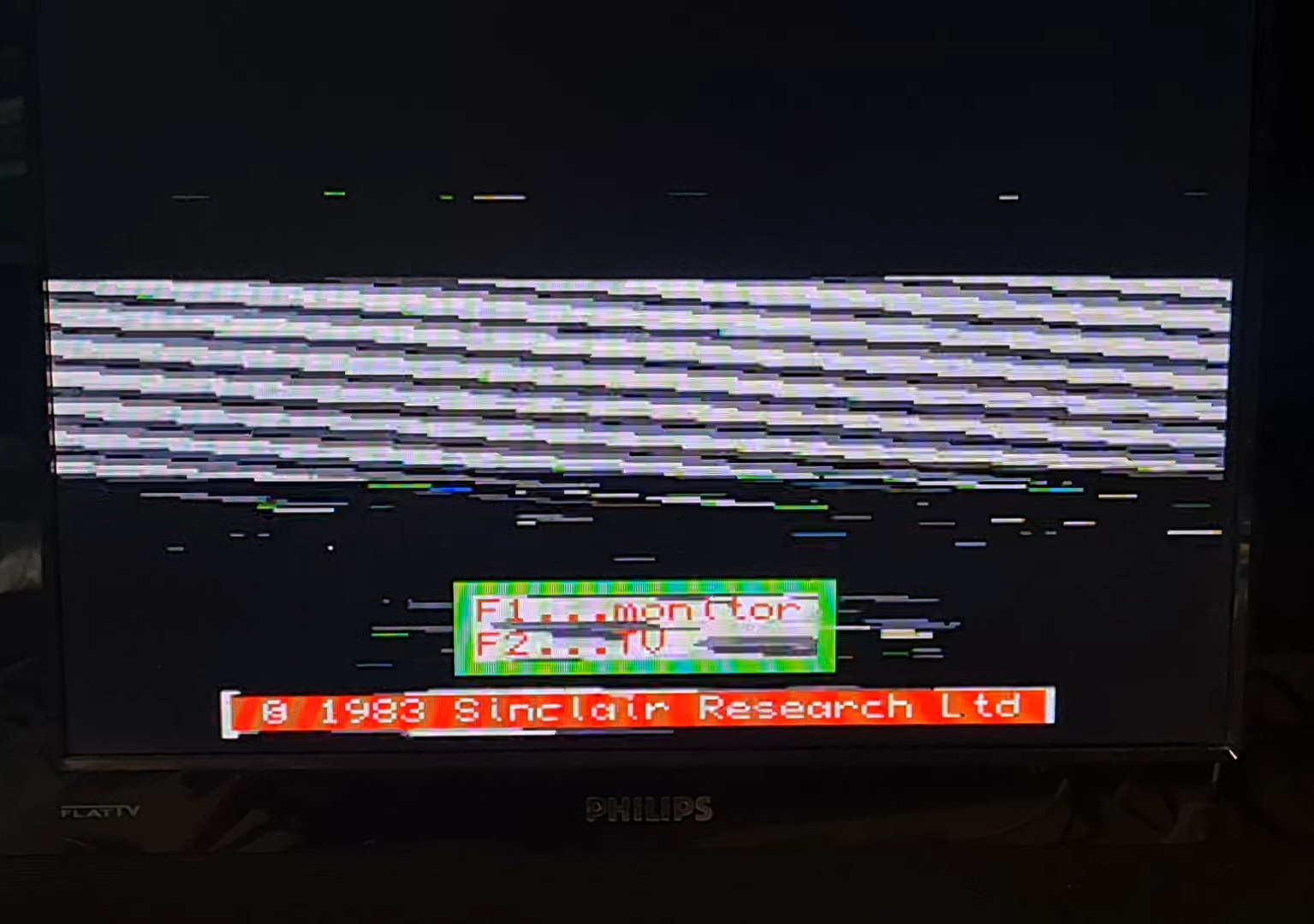

Nedd troubleshooting help
I've just finished my QL pico VGA using a strip board (it didn't look so difficult) I guess I have some Sync problems. Image is not steady with some horizontal jumps and the rainy band moves from top to botom, then the "signal?" Screen apears briefly.
If I attach a tv to the composite output the image gets steadier but the moving band worsens notably.. What should I check first ? Connections seems tonbe good..
Thanks
Thanks

Re: QL Pico VGA
You didn't even write which module you used.
Are you aware that different binaries are needed for the (small) RP2040-Zero and the (larger) Raspberry?
Did you keep the wires to the QL either very short or shielded?
Did you check that the QL RGB output (not composite) is working correctly, e.g. with a different converter?
Re: QL Pico VGA
I'm sorry about that... I used the conventional raspberry Pi Pico, the larger one, and downloaded the firmware from the github page
Wires from QL are not shieded but about 7cm long, I guess they are short enough.Peter wrote: Fri Mar 17, 2023 9:16 pm Are you aware that different binaries are needed for the (small) RP2040-Zero and the (larger) Raspberry?
Yes actually I am using a NEC Multisync II monitor connected directly to the same (short) adapter from the QL's DIN to a db9 Cable.. and image is just great.Peter wrote: Fri Mar 17, 2023 9:16 pm Did you check that the QL RGB output (not composite) is working correctly, e.g. with a different converter?
I guess you are suggesting me to look for interferences, maybe the QL itself be the source ? I'll try to shield the short wire and the adapter itself somehow and check again.
I am a bit concerned about the fact that having the co posite connected at the same time changes it behavior.. composite image is not very good I think some capacitors may need some care on the machine..
Thanks for your help and forgive my clumsiness in previous post.
