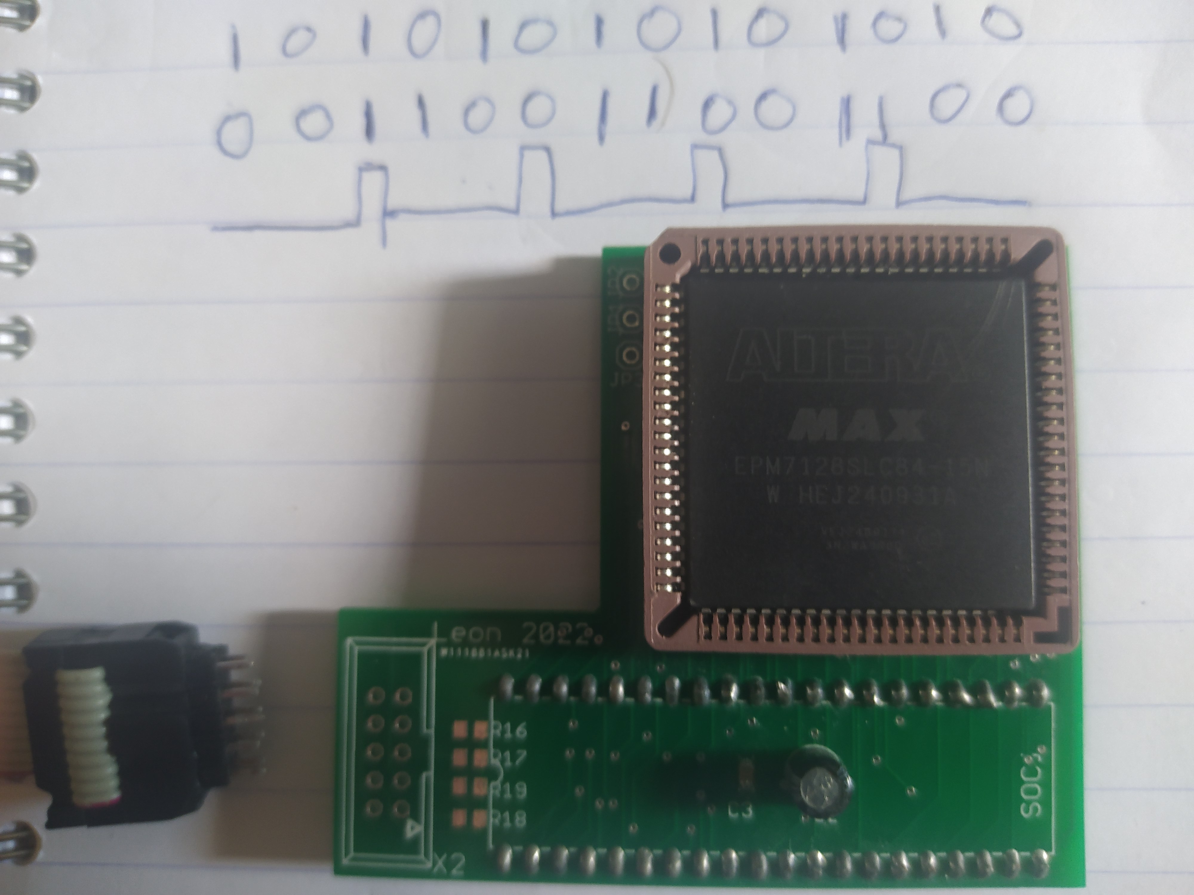

New pcb with video buffer arrived and tested OK.
I tested it with the smaller cpld and a 15Mhz oscillator but in the final version I'll use a 30Mhz oscillator.
So I'm waiting for 2 parts to have the 2 different versions of the ULA replacement board ready.
-One with the EPM7128S with the only difference in the behavior of flash bit that complements the colors instead of flashing using a fixed background color
-One with the EPM7160S that will work exactly as the ULA.
On the new pcb there are 5 pin connections available, one pin can provide the Flash signal as output for more colors as an option enabled by shorting another input pin to gnd.

I got the EPM7160S and the 30Mhz smd oscillator and tested it with the new pcb and works OK and with the correct flash bit behavior.
It also outputs the flash bit as a signal for any alternative use, when this output is enabled the flashing is disabled. With a simple resistor dac this could be used to produce 16 colors.
Next I may make a pcb with the smd version of epm7128s to reduce the height so it may fit in my QL that has socketed ram or make a different shape pcb for that reason.
Posted: Sat Aug 06, 2022 7:47 am
by lliont
The EPM7128S that is cheap and available works also with the new pcb and 30Mhz osc. as I wrote with the difference that it flashes the complemented colors instead of the background and this due to resources limitation because there is no room in the cpld to save the background color data. This produces a more intense flashing result.
If there is another cpld with 5V outputs of the same size or bigger that is cheap and available that I am not aware of tell me.
There is also the possibility to use a newer 3.3V cpld (XC95144XL-10TQG100C) and extra circuit for level conversion, I think this is what I'll do next.

by ones' complement
AFAIK the ATF1508AS can be used in place of EPM7128S (as used here). But at about the same price (ATF1508 is largest in range).
Posted: Mon Aug 08, 2022 3:57 pm
by Nasta
ones' complement wrote:AFAIK the ATF1508AS can be used in place of EPM7128S (as used here). But at about the same price (ATF1508 is largest in range).
ATF1508S can also be had in a TQFP100 package which is small and thin, so much so that with a multilayer PCB it may be possible to squeeze the whole board within the outline of the original ULA, perhaps a bit wider. It would require surface mount pins to go into the original socket though.
