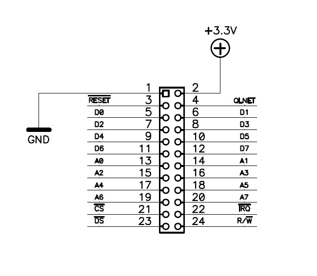

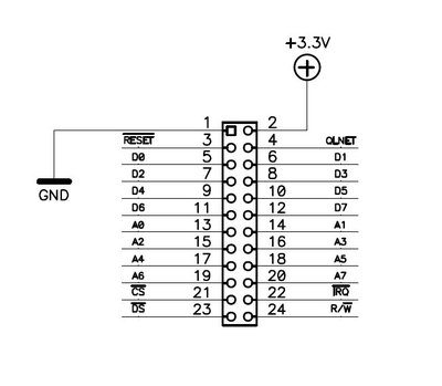

There was a small change of Q68 extension bus signals. A signal "QLNET" was added, which implements physical QL network, if some minor components are added externally (two resistors and a clamp diode). For that pupose, one address pin had to be removed.
Currently the Q68 extension bus base address is in the QL external I/O area. Should future Q68 compatible peripherals prefer the QL internal I/O area, the driver software must support a different base address. This seems trivial, as long as the register offsets are the same.
The Q68 8-Bit extension bus will be longword aligned.
