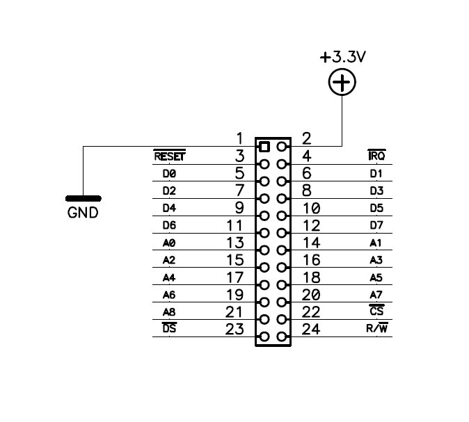

Basically the Q68 extension bus is a simple 8 bit data bus, 9 address lines, and the usual control lines. Currently the only device on this bus is the CP2200 ethernet controller, which has it's own chip select line. The Q68 extension bus is also available on a space saving through-hole-type connector footprint with 2mm grid. That one has a separate chip select line.
The CP2200 is 5V tolerant and suitable to interface the original QL bus. Ideally, driver software could be identical between the Q68 and an other QL system using this chip.
Same goes for further peripherals that might later be made for the Q68 (no idea whether that will happen, but at least this simple little bus makes it quite easy.)
What needs to be decided, is the base address and the spacing in which the external 8 bit bus appears to the CPU. At the moment, I consider to implement a 4-Byte aligned spacing, because that would allow 32 Bit CPUs to easily access devices without dynamic bus sizing. Not important for a 68020, but for 68040 and 68060. Any feedback on this?

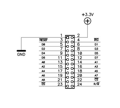

Pin assignment of the Q68 extension bus:
Planned start address is $1D000 for the CP2000 ethernet controller chip select, and $1D800 for the external chip select.

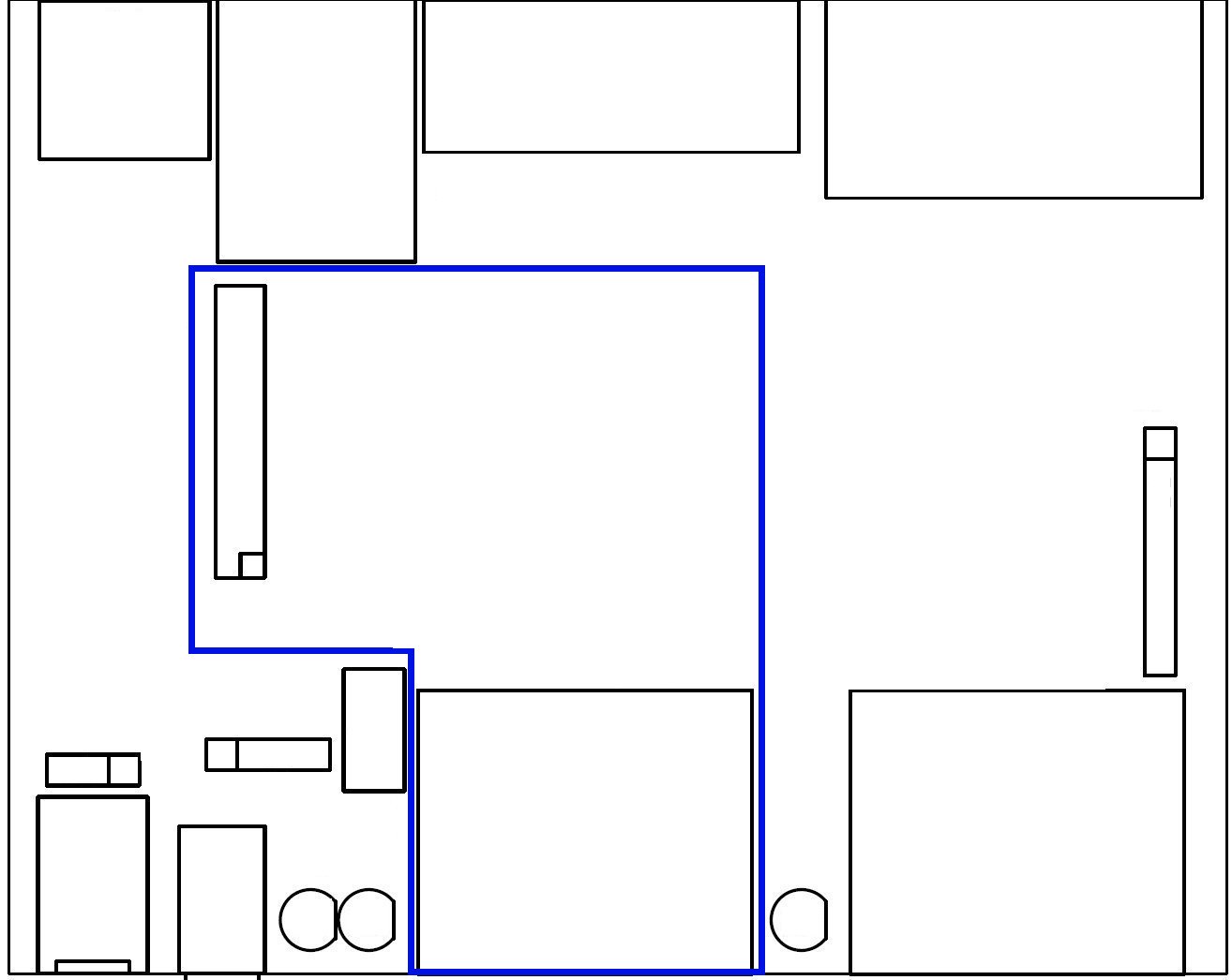

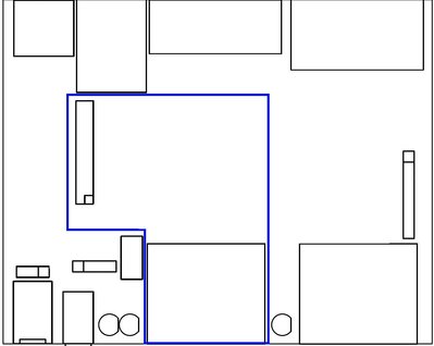

Peter, could you please supply the dimensions and relative positions of the three 5V/GND pins to the 24 pin header?
As the connector is not fitted, this leaves options open for accessories. Expansion boards could be mezzanined above or below. Cards mezzanined below could be the same 100x80mm size. It might even be possible to support multiple cards, stacked below, similar to a Raspberry Pi or Arduino.
Posts: 2513
Re: Q68 compatible peripherals on other QL systems

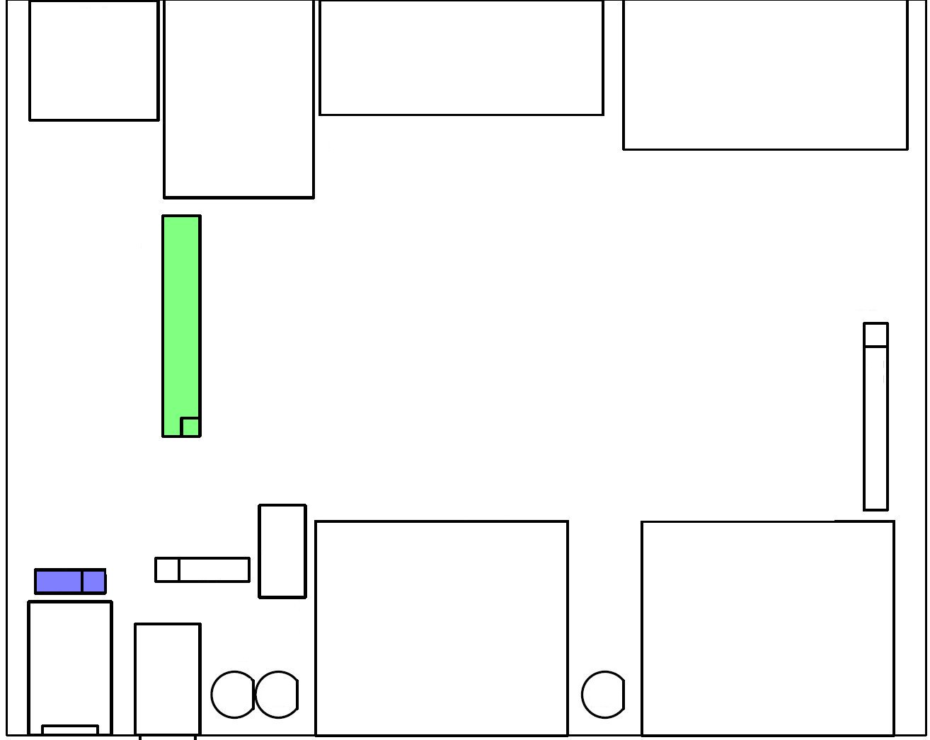

Extension bus header (24 Pins) in green, Pin 1 at x=20.0 y=33.5 [mm]
5V Power header (3 Pins) in blue, Pin 1 at x=9.5 y=16.7 [mm]
Total board size x=100.0 mm y=80.0 mm
If 5V is required, it would probably better be connected by a cable, since it is on a standard 2.54 mm jumper header, i.e. higher than the 2mm spaced extension bus header.
The 5V Power header is primarily there so an optional power switch can be added between 5V input from external supply (Pin 2) and internal 5V (Pin 3). Pin 1 is GND.
Here is how the shape of a small extension card with connector at the front panel could look:
