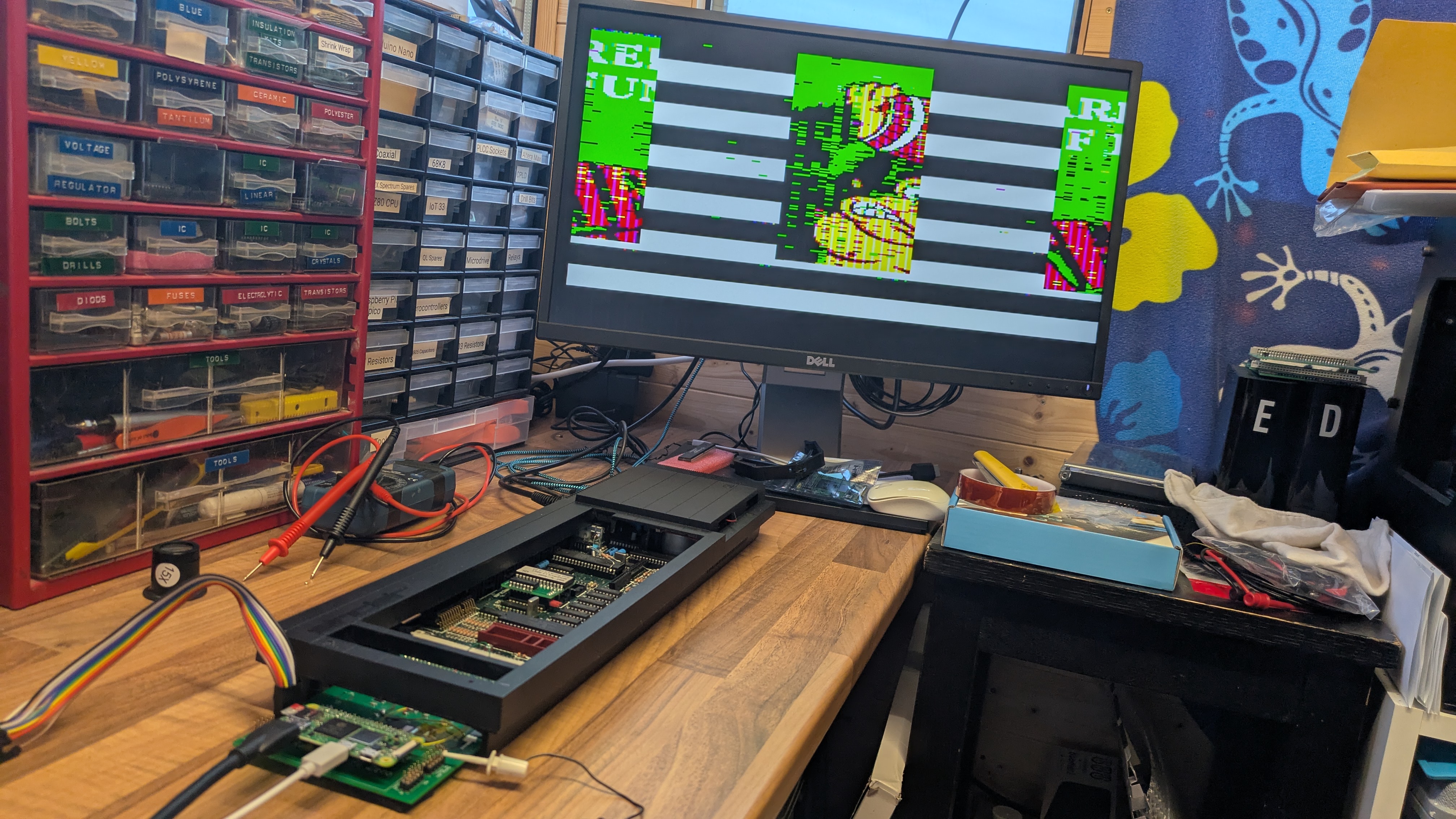

Progress! After literally weeks of struggling to get my QL PiStorm to do anything at all (apart from producing the odd puff of smoke) I have finally got the FSM to let me access the QL bus and copy a picture into video memory (not perfectly to say the least). I was using !LDS as !DS when I needed to use !LDS & !UDS to make !DS which was causing the FSM to lock up. Oh happy day! I can see light at the end of the tunnel. I'll have to work out how to use Quartus an recompile the Verilog pistorm.v rather then the ugly 7408 I bodged onto U9. I'll try and upload some pictures. Now to get it reading and writing more reliably. Here are some photos ---->
https://photos.app.goo.gl/xdjRPFzbUSViffhd7
