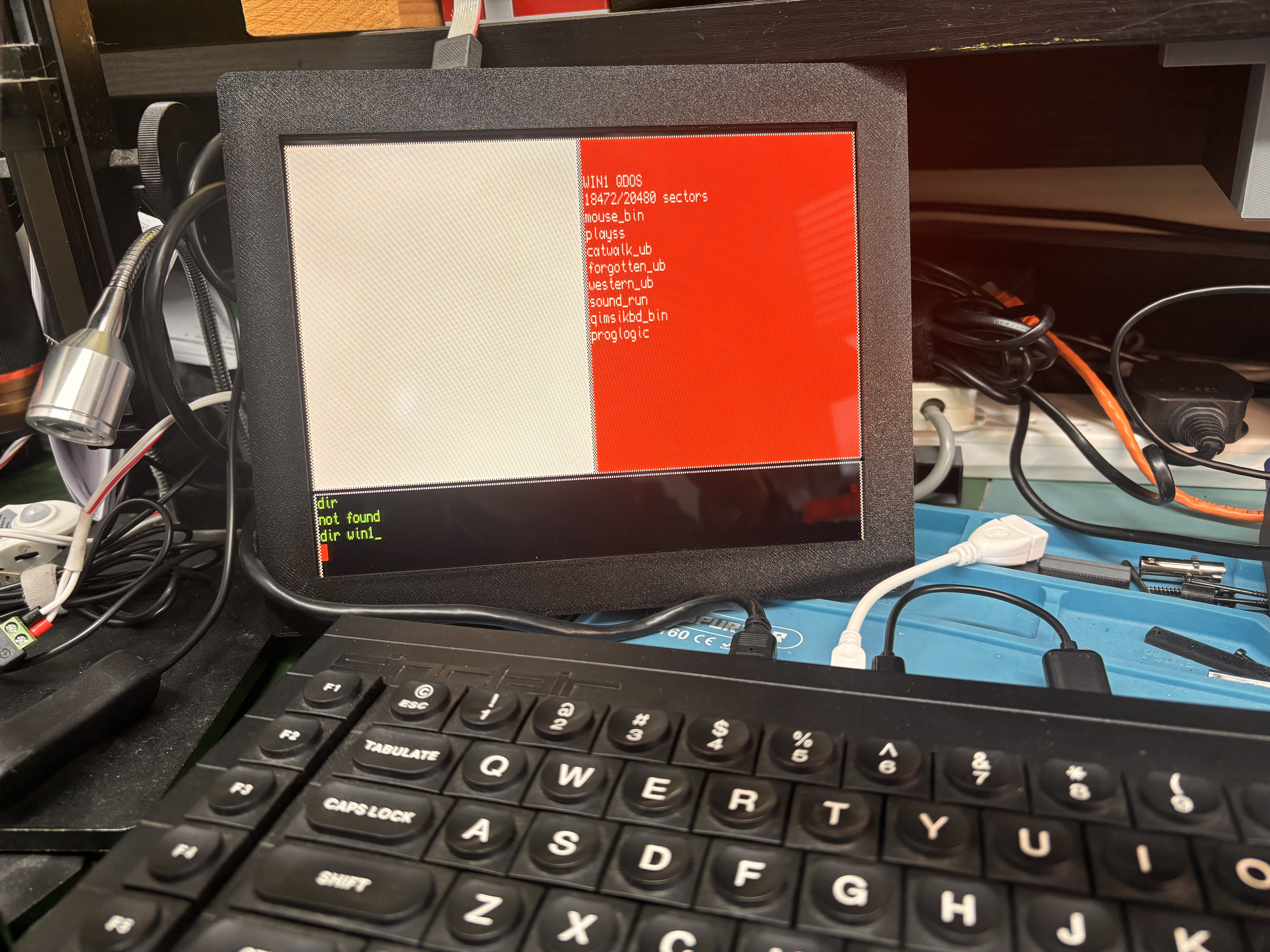

Re: QIMSI Gold - getting started
It was the mouse. I can get it to boot now with a PS2 mouse with a converter but the mouse doesn't work. It boots though and I get the display from the QIMSI board.
I'm going to have to make the 3D printed case more stable though, before the QIMSI PCB pulls out on its own.
You could check that with QIMSI Gold standalone, powered by a simple microUSB supply. I bet the problem does not occur then. It is likely that your system does not power up nicely, which confuses the mouse.dilwyn wrote: Thu Jan 02, 2025 10:43 pm Both my Q68 and QIMSI-Gold sometimes get stuck at the start-up message for no obvious reason when first switched on (i.e. with their regular mouse which is known to work).
Thank you, looks like that is indeed the issue. I've started it several times stand alone with a microUSB power supply, not seen a screen like Pepperm was getting while doing that. Also started it several times plugged into the QL without the QIMSI mouse to try, and also not seen that screen. OK, granted that 10 tests each is probably not the most thorough of tests, it seemed to happen about 5 to 10% of the time when plugged into QL with the USB mouse, which I sort of accepted in the knowledge that if I left it a few seconds and restarted it, sure enough it would power up OK. Possibly the QL's 40 year old power supply needs a short while (like me at my age) to power up to speed in the morning!Peter wrote: Sun Jan 05, 2025 10:42 amYou could check that with QIMSI Gold standalone, powered by a simple microUSB supply. I bet the problem does not occur then. It is likely that your system does not power up nicely, which confuses the mouse.dilwyn wrote: Thu Jan 02, 2025 10:43 pm Both my Q68 and QIMSI-Gold sometimes get stuck at the start-up message for no obvious reason when first switched on (i.e. with their regular mouse which is known to work).
When I tried a few times plugged into QL with no mouse it subjectively (cannot prove it) seems slightly slower to start up, slightly slower as in less than a second. Could that be because searching for a mouse which doesn't exists takes a little longer than successfully finding and initialising a mouse? Or am I over-imagining things?
