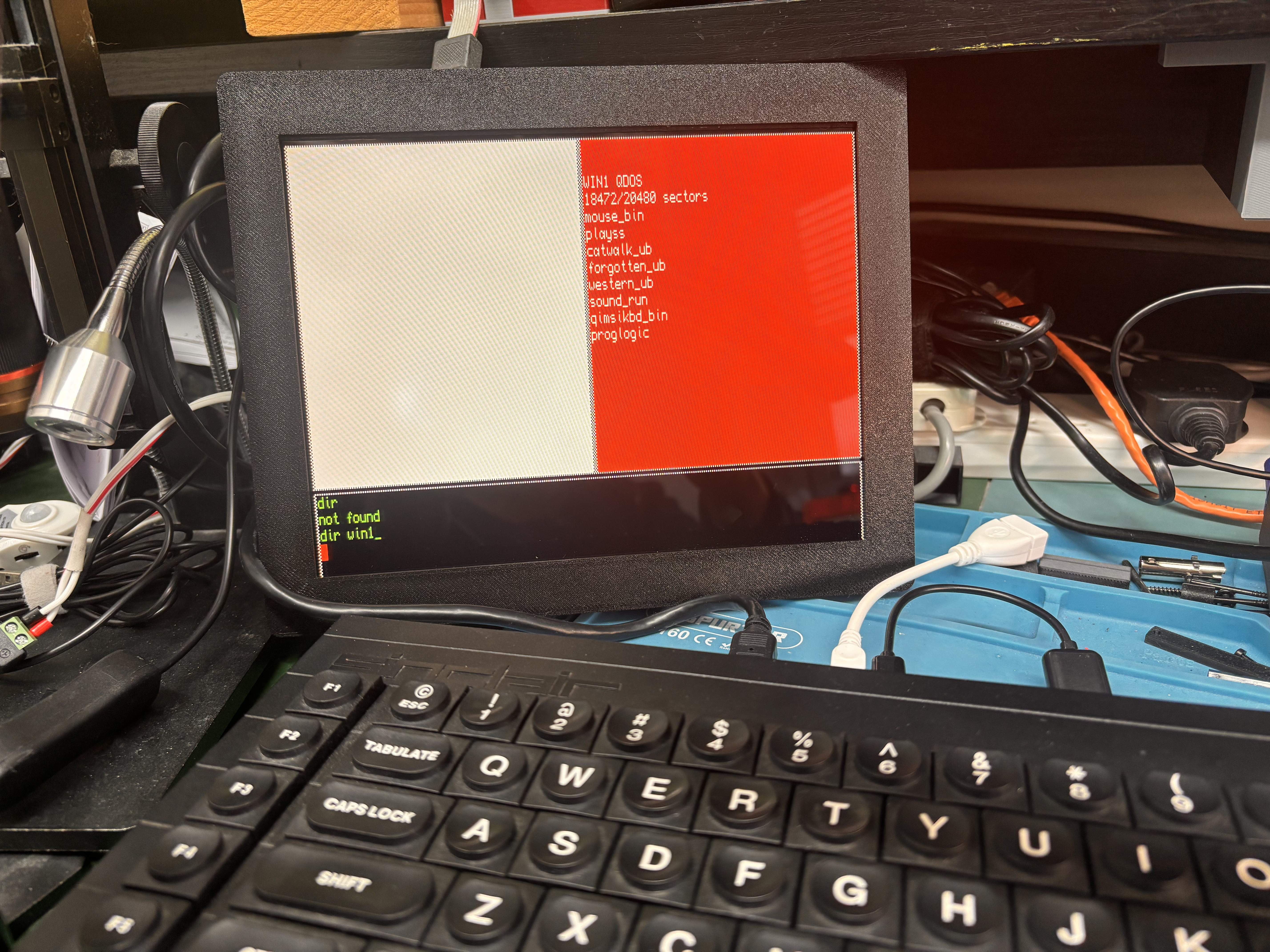

It was the mouse. I can get it to boot now with a PS2 mouse with a converter but the mouse doesn't work. It boots though and I get the display from the QIMSI board.
I'm going to have to make the 3D printed case more stable though, before the QIMSI PCB pulls out on its own.

Re: QIMSI Gold - getting started
You could check that with QIMSI Gold standalone, powered by a simple microUSB supply. I bet the problem does not occur then. It is likely that your system does not power up nicely, which confuses the mouse.dilwyn wrote: Thu Jan 02, 2025 10:43 pm Both my Q68 and QIMSI-Gold sometimes get stuck at the start-up message for no obvious reason when first switched on (i.e. with their regular mouse which is known to work).
If you can not find a suitable PS/2 or combo mouse, we could still try an update with the USB mouse version of the FPGA - which I do not normally distribute to reduce confusion and future update issues.Pepperm wrote: Fri Jan 03, 2025 4:26 pm It was the mouse. I can get it to boot now with a PS2 mouse with a converter but the mouse doesn't work.
