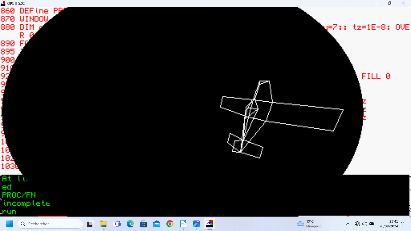

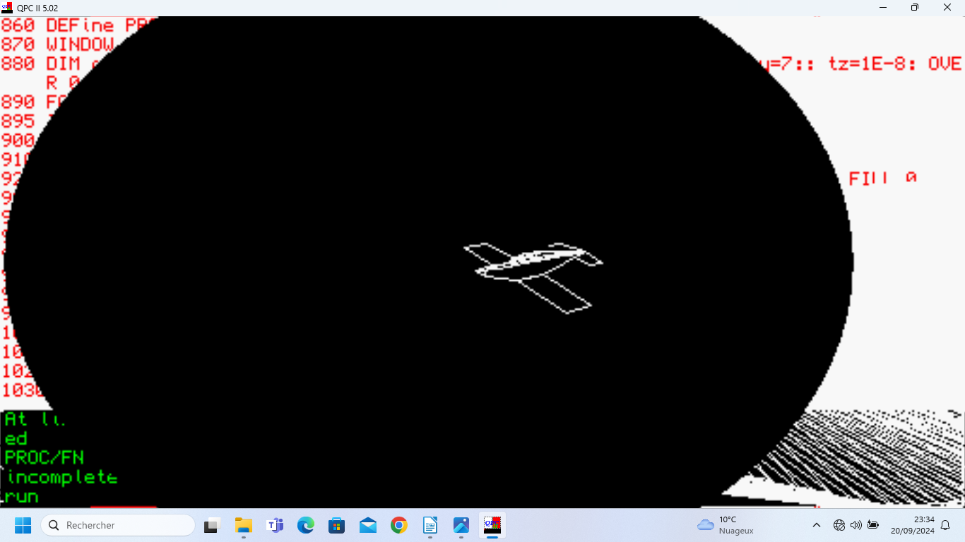

I could not make head nor tail of the Forth, so I designed my own tumbling 3D plane, using Trigonometry. Here it is , just UNZIP & LRUN.
plane5.zip
(2.12 KiB) Downloaded 216 times

stevepoole wrote: Fri Sep 20, 2024 10:57 pm Capture d’écran (536).pngCapture d’écran (538).png
Wauuu!!! Amazing! it seems to me like big magic!
Posts: 4864
Re: Talent 3D Designer
HI Steve,
Really amazing, you are an excellent programmer.
Have to try the Forth version.

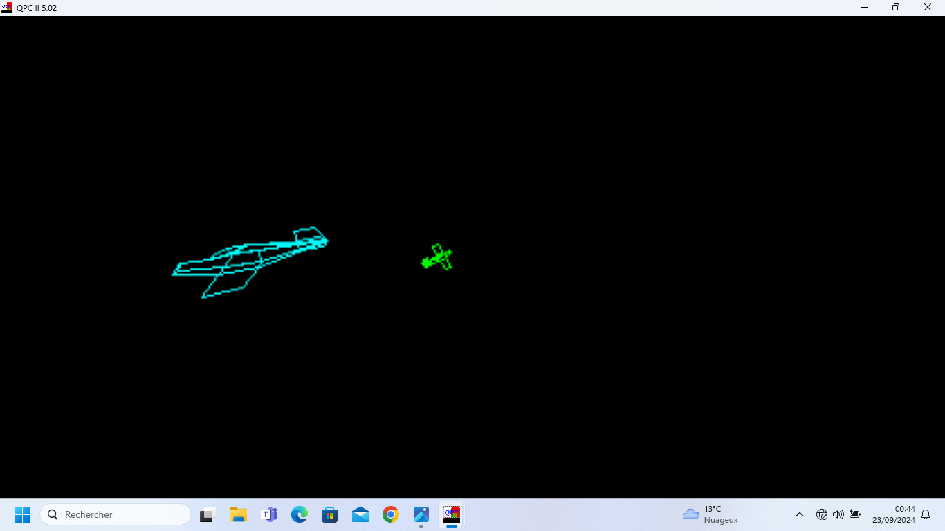

Hi Folks,
Just made the Plane program into a shootem-up version. Can you destroy two planes on one screenfull ? Blast away !
Just UNZIP, LRUN and use arrow keys to aim. Tested OK on QPC2. Will try to optimise for SGCs soon. Regards, Steve.
Planes7.zip
(2.92 KiB) Downloaded 247 times
