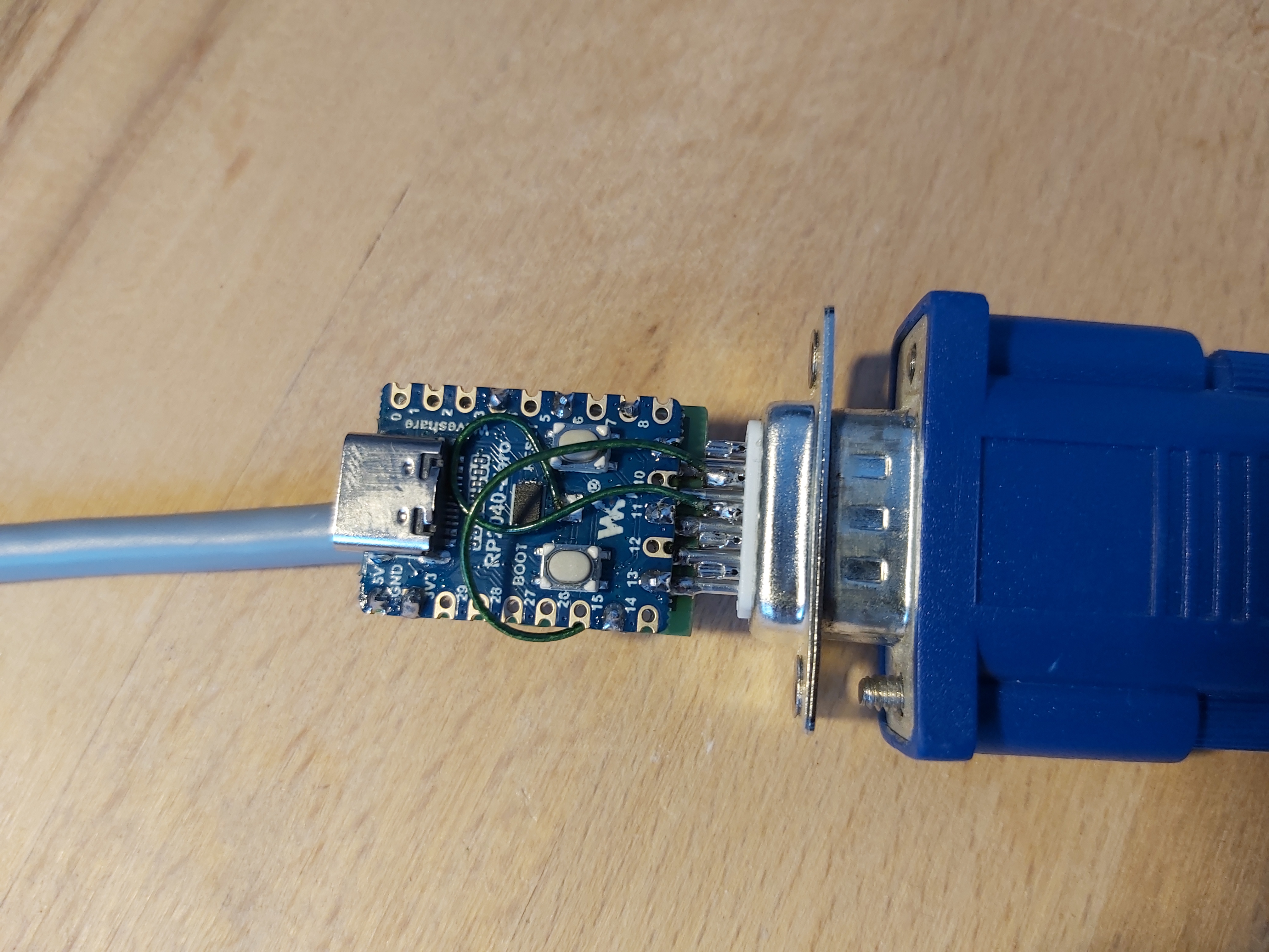

Derek_Stewart wrote: Sun Feb 05, 2023 4:32 pm Your earlier photographs show the Mini VGA board soldered to VGA pins 1-5, whivh should support the VGA and Pico RP2040-Zero.
A wire link from GND to VGA pins 6,7,8 and wite links to HYSNC, VSYNC.
No. The PCB directly connects to pins 1 to 10. Pins 13+14 are wire links. Please read the schematics and my previous posts.

Hi Peter,
I looked at the Gerber files in Kicad Gerber Viewer (Gerbv), I noted that pins 6-8 are soldered to pads on the PCB, not clear on the photo. Which should make construction easier.
I will see if I have the time to make one.

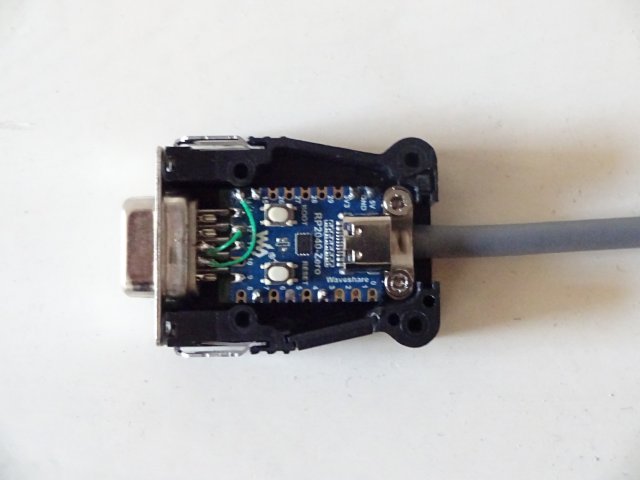

Finally found the time to order a nice D-Sub hood for my miniaturized version. Type Conec 16-001810E. It has an optional side cable exit, the cable relief for it should be filed off a little. With the circuit fitted, it looks like this:

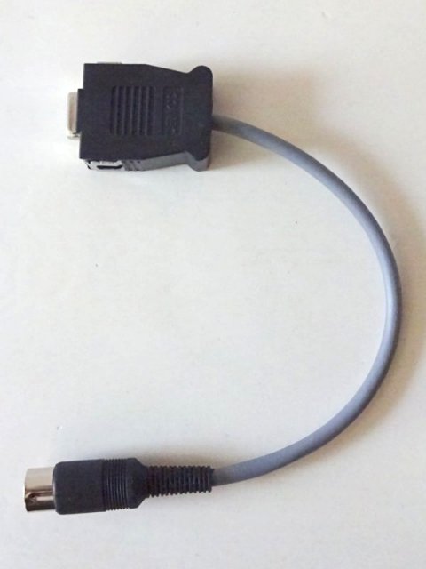

And the completed QL to VGA adaptor cable:
Had I waited for a black cable, it would be perfect. ;)

Peter wrote: Tue Feb 28, 2023 7:11 pm With the circuit fitted, it looks like this:
Looks absolutely amazing! What a great piece of kit!

Peter wrote: Tue Feb 28, 2023 7:11 pm Finally found the time to order a nice D-Sub hood for my miniaturized version. Type Conec 16-0018E. It has an optional side cable exit, the cable relief for it should be filed off a little. With the circuit fitted, it looks like this:
That looks fantastic!

The new case looks great.
I could only find CONC 16-001820E, here is the data sheet.
*** Data Sheet removed
I will get some PCBs made.
I just have to find a way of powering the adapter from an unmodified QL with all the video lines connected. Most modern VGA LCD monitors have a USB connector. which could be used for powering the adapter board or a mobile phone power supply would do.
