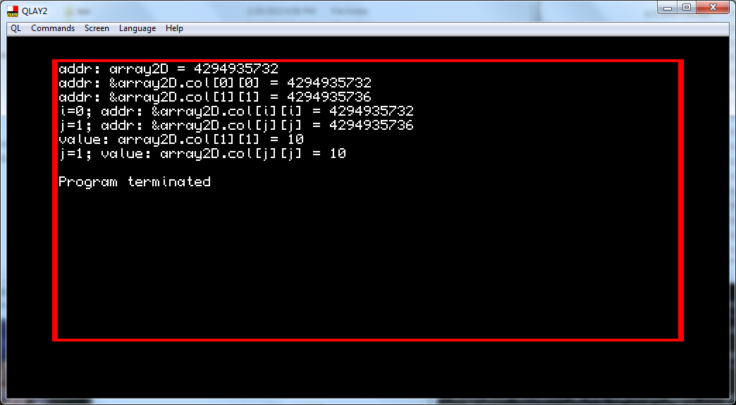

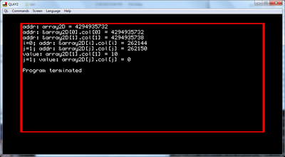

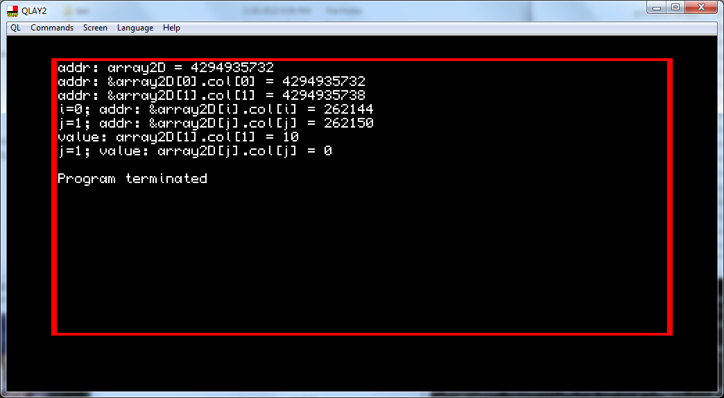

But you can see below in the last printed statement it shows a 0 but the array element should be 10. Note that the pointers are all wrong when using variables to access the arrays. It works with literal numeric values but not variables (the pointers are these smaller values). I actually dug down even deeper and it's the first subscript that doesn't work with a variable, whereas if you do something like array2D[1].col[j] it would work:

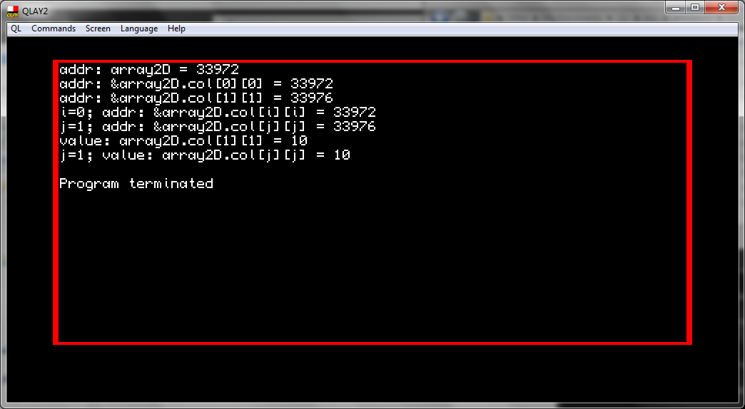

The solution is this odd syntax. Again, haven't tired it on a real C compiler, but that cannot be the actual syntax, can it?
#include stdio_h
struct dim {
   int col[2];
struct dim array2D[2];
main()
   int i, j;
   i = 0;
   j = 1;
   array2D.col[1][1] = 10;
   printf("addr: array2D = %lu\n", array2D);
   printf("addr: &array2D.col[0][0] = %lu\n", &array2D.col[0][0]);
   printf("addr: &array2D.col[1][1] = %lu\n", &array2D.col[1][1]);
   printf("i=0; addr: &array2D.col[i][i] = %lu\n", &array2D.col[i][i]);
   printf("j=1; addr: &array2D.col[j][j] = %lu\n", &array2D.col[j][j]);
   printf("value: array2D.col[1][1] = %d\n", array2D.col[1][1]);
   printf("j=1; value: array2D.col[j][j] = %d\n", array2D.col[j][j]);
Here it finally has the correct addresses for both literal numeric values and variables:

The pointers in your first 3 printf() lines look seriously wrong and are outside any reachable address space of the 68000. Something must have gone wrong with a sign extension here, they look like negative numbers to me (0xffff84b4). And pointers being 32-bit is a feature of the special edition of the compiler (before, they were 16 bits, apparently), maybe what you see here is an omitted change.
Posts: 1517
Re: Dhrystone compiled on BBQL with Digital C SE
tofro wrote:The pointers in your first 3 printf() lines look seriously wrong and are outside any reachable address space of the 68000. Something must have gone wrong with a sign extension here, they look like negative numbers to me (0xffff84b4). And pointers being 32-bit is a feature of the special edition of the compiler (before, they were 16 bits, apparently), maybe what you see here is an omitted change.
I do see the size being an issue, but these are the valid pointers. If you do just a simple malloc in Digital C SE you get pointers of that size exactly in that range. I initially thought those were the bad ones since they are at the to of 32 bits (4GB). It's the pointers reading 262144 that are incorrect and though they show no signs on either QLAY or Q-Emulator, on my actual QL they write into screen memory, leaving artifacts (that's in fact how I knew things weren't working, since otherwise it compiles fine). I'm printing them out as lu (long unsigned) so perhaps the top 12 bits need to be masked out since the 68008 has only a 20 bit address range...I will give that a try in my next run as I continue to try and figure out what's going on.

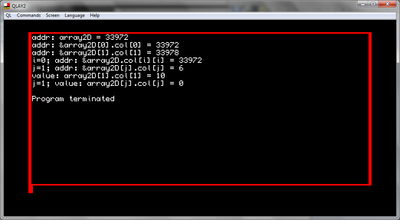

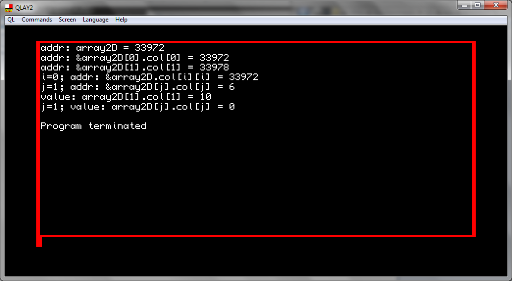

    So the actual addresses shouldn't be that large. If I treat them as 16 bit values then printing the addresses out as just unsigned integers (i.e. %u in printf), the working version, that doesn't conform to K&R C, looks like this:
    ...and the broken one, that does conform to K&R C, looks like this (note the 6 as a relative address):
