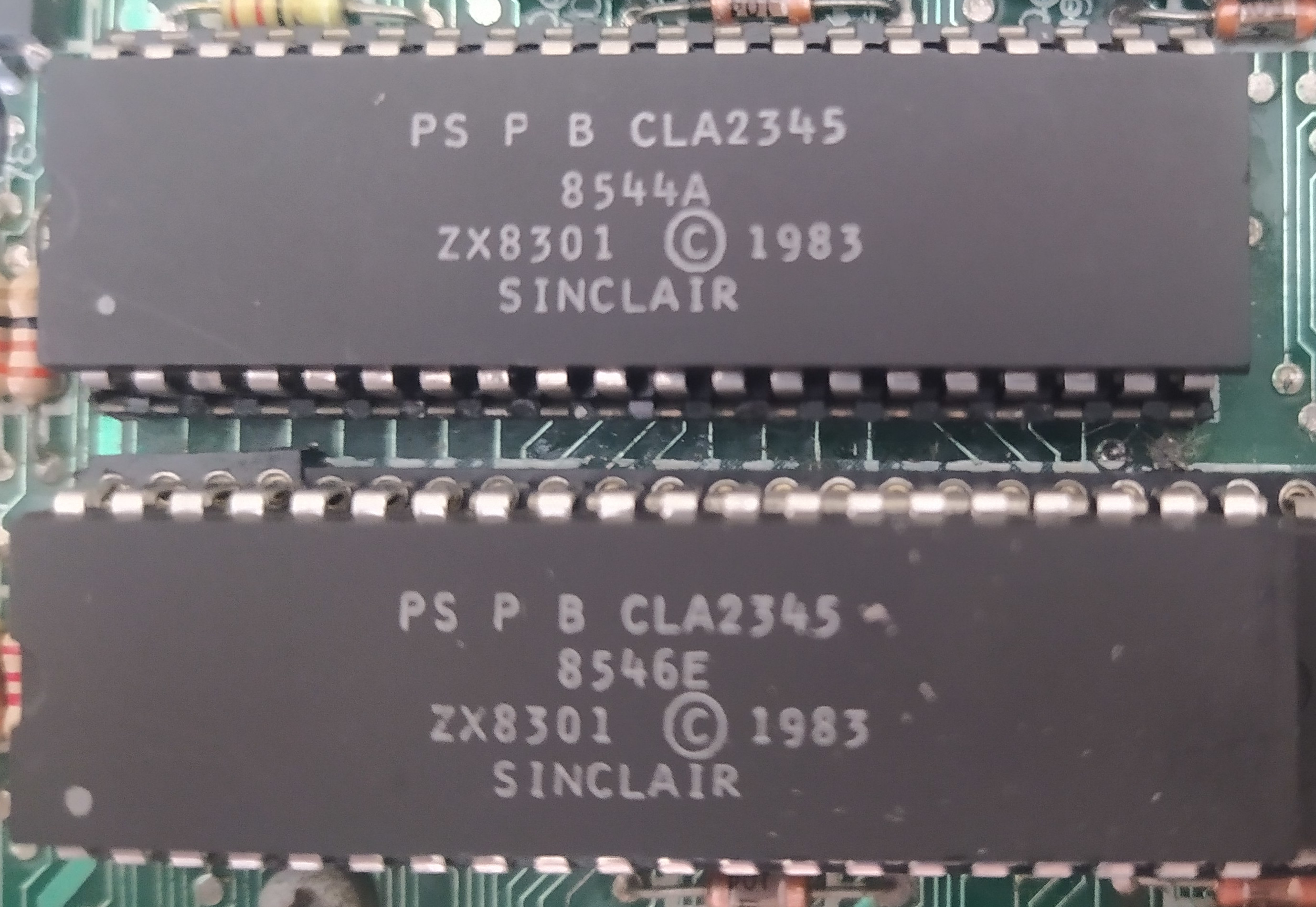

How odd, almost looks like some revision happened in early November 1985 (8544 to 8546) :?
lliont
Posts: 342
Location: Athens, Greece
Post by lliont »
ones' complement wrote:How odd, almost looks like some revision happened in early November 1985 (8544 to 8546) :?
The older ULA is the fast :)
lliont
Posts: 342
Post by lliont »
What do the letters 'A' and 'E' indicate ?
A is on the fast
E is on the slower
lliont
Posts: 342
Post by lliont »
The same tests without the memory upgrade so that the basic code and variables are in the lower ram that the cpld manages give these results:
Fast ULA 51.5
CPLD 50.9
Cpld is about 1.2% faster than the fast ULA, but the ram access speed improvement percentage is bigger because basic interpreter code resides in rom and access to rom is the same for both and a percentage of the code is not a memory access.
So yes some (if any) of the improvements don't exist even in the fast ULA.

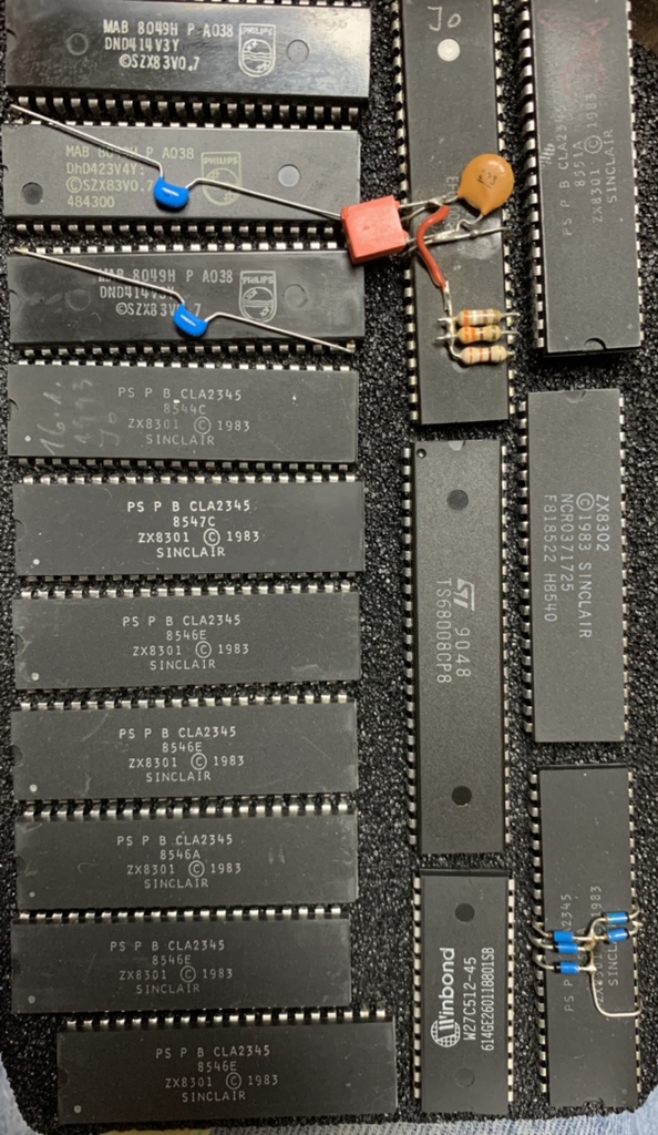

lliont wrote:What do the letters 'A' and 'E' indicate ?
A is on the fast
E is on the slower
No idea. But looking at my pile of spare ULAs I also have the letter "C" and different letters for the same week as yours. Maybe different plants or at least production lines?
Cannot make heads nor tails of the speed difference you report. Are they as consistent as you say? As far as I know there are only two revisions, the old CLA2310 and the later CLA2345 which added NTFS support.
