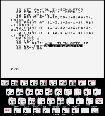

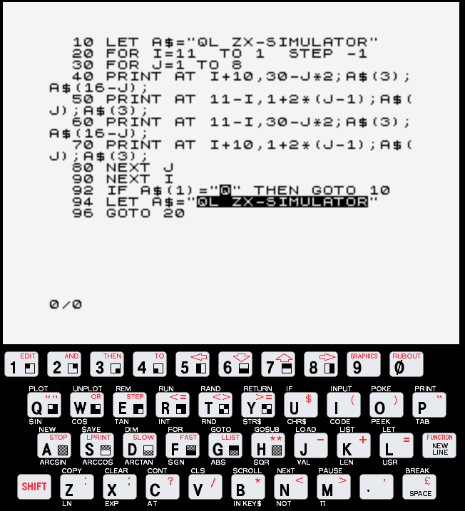

Re: ZXSimulator
Another update...
Here is what it looks like in JtyOne (online ZX81 emulator):
I think I have enough implemented now to write a simple graphics game in it so I'll post the BASIC file when done. sometime this week.
- This implements the graphics characters in a string (not easy since the format is multi-character)
- Fixed a bug in AT to make it work like in a true ZX81
- I broke my IF/THEN in last one that is now fixed
- Did I mention that space now breaks a run
10 LET A$="QL ZX-SIMULATOR"
20 FOR I=11 TO 1 STEP -1
30 FOR J=1 TO 8
40 PRINT AT I+10,30-J*2;A$(3);A$(16-J)
50 PRINT AT 11-I,1+2*(J-1);A$(J);A$(3)
60 PRINT AT 11-I,30-J*2;A$(3);A$(16-J)
70 PRINT AT I+10,1+2*(J-1);A$(J);A$(3)
80 NEXT J
90 NEXT I
92 IF A$(1)="%Q" THEN GOTO 10
94 LET A$="%Q%L% %Z%X%-%S%I%M%U%L%A%T%O%R"
96 GOTO 20
