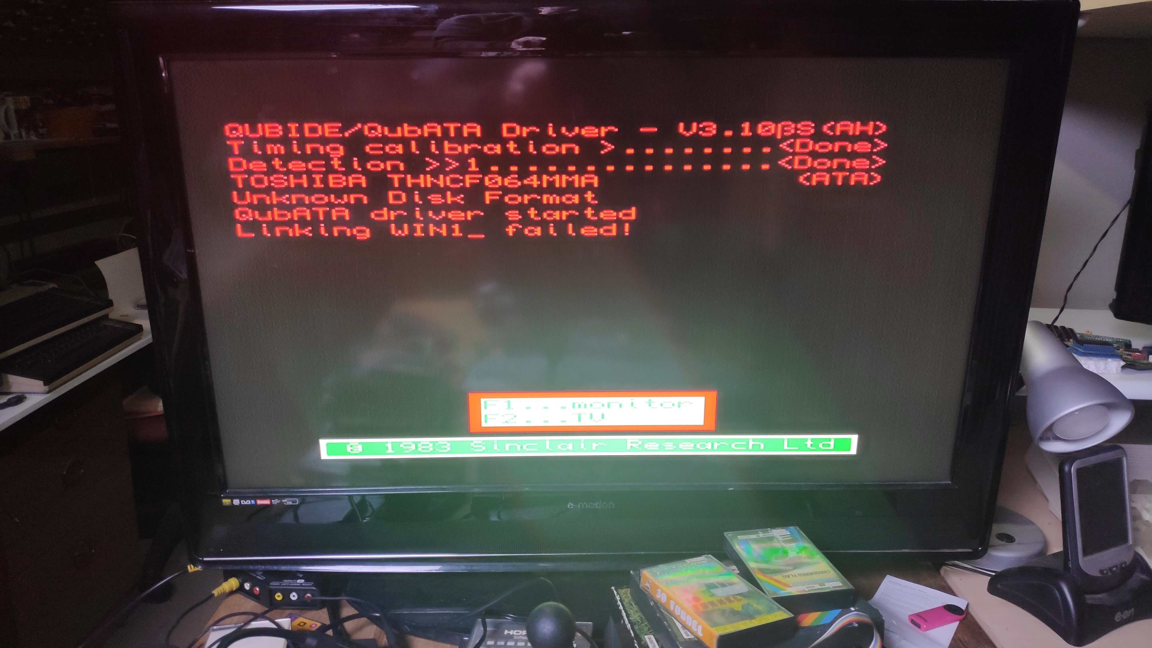

That's a promising screen!

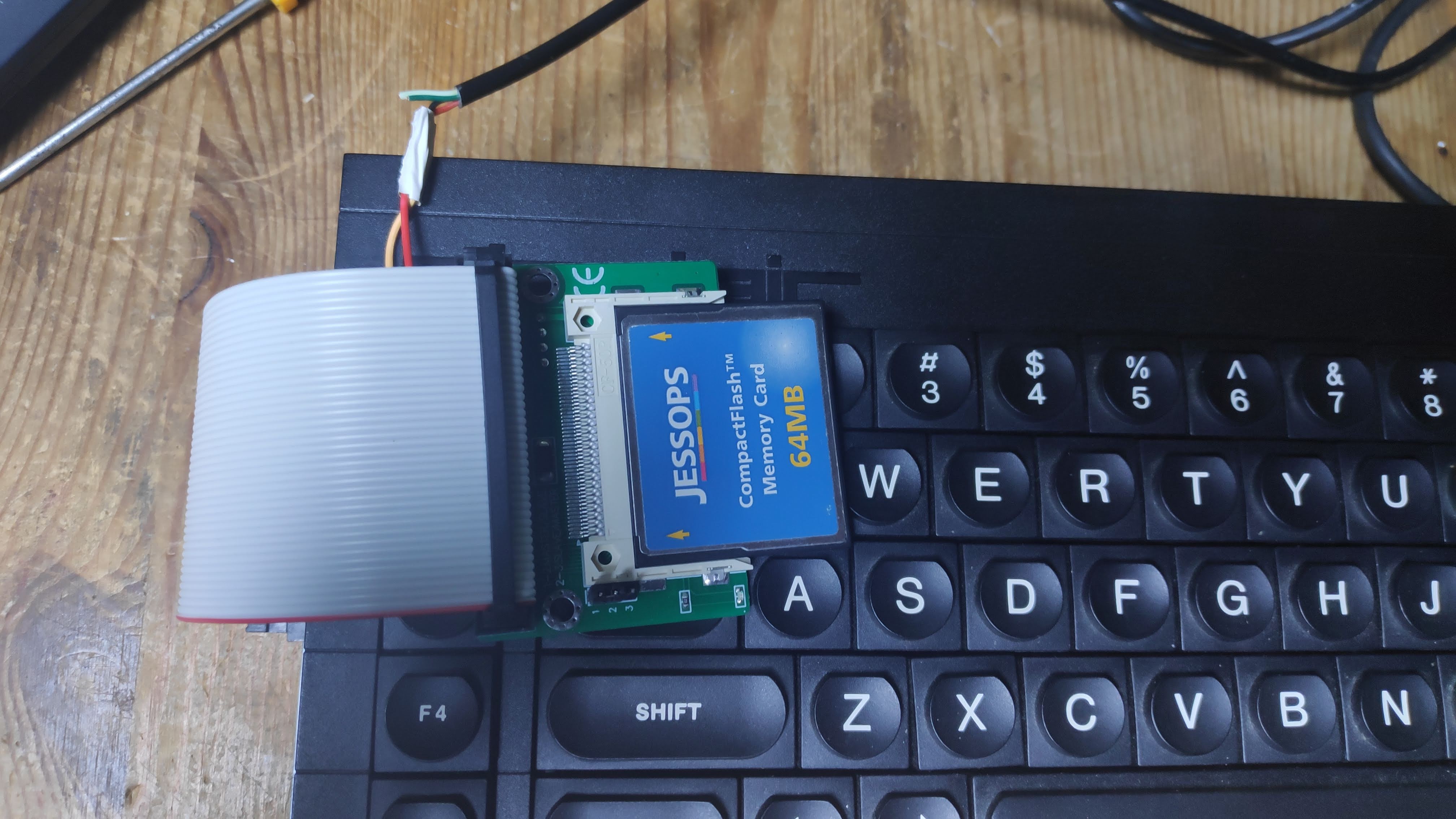

How is your compact flash connected to the Qubide card - I am guessing you have some kind of adapter installed?

Its just ide to cf adapter. win_format 1,4 works then win_disk "CREATE",1,1,64 gives "end of file"

Red messages?
Shouldn't they be green?

Apart from the wrong colours, which maybe video cable problems.
The CF Card is being recognised by the QubATA rom, it has seen a partition, which is not a Qubide partition, so the the WIN device driver can not be linked to partition 1.
The WIN_DISK command is not working, because you have not initialised the disk.
