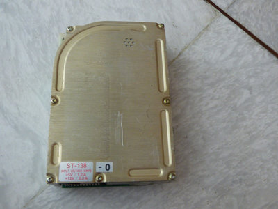

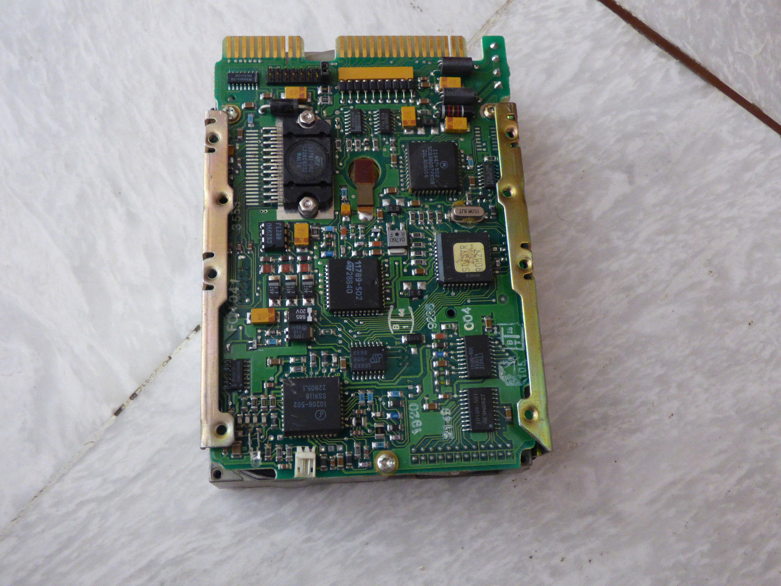

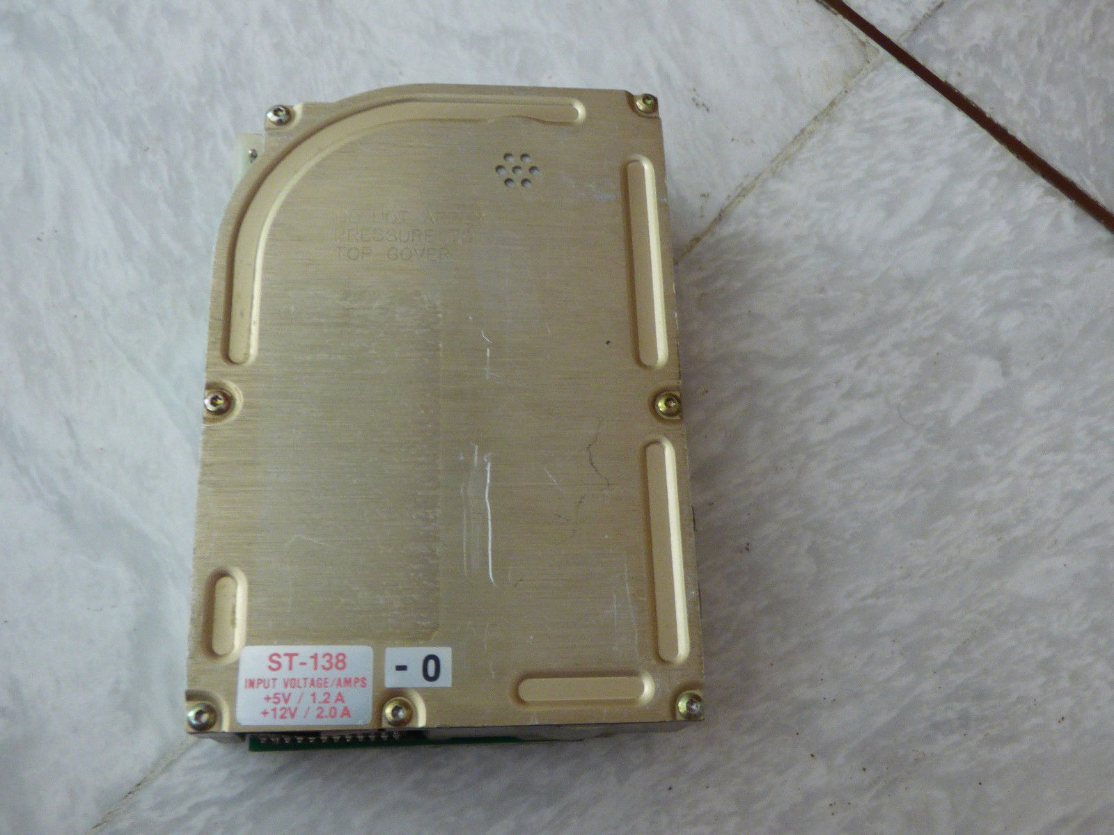

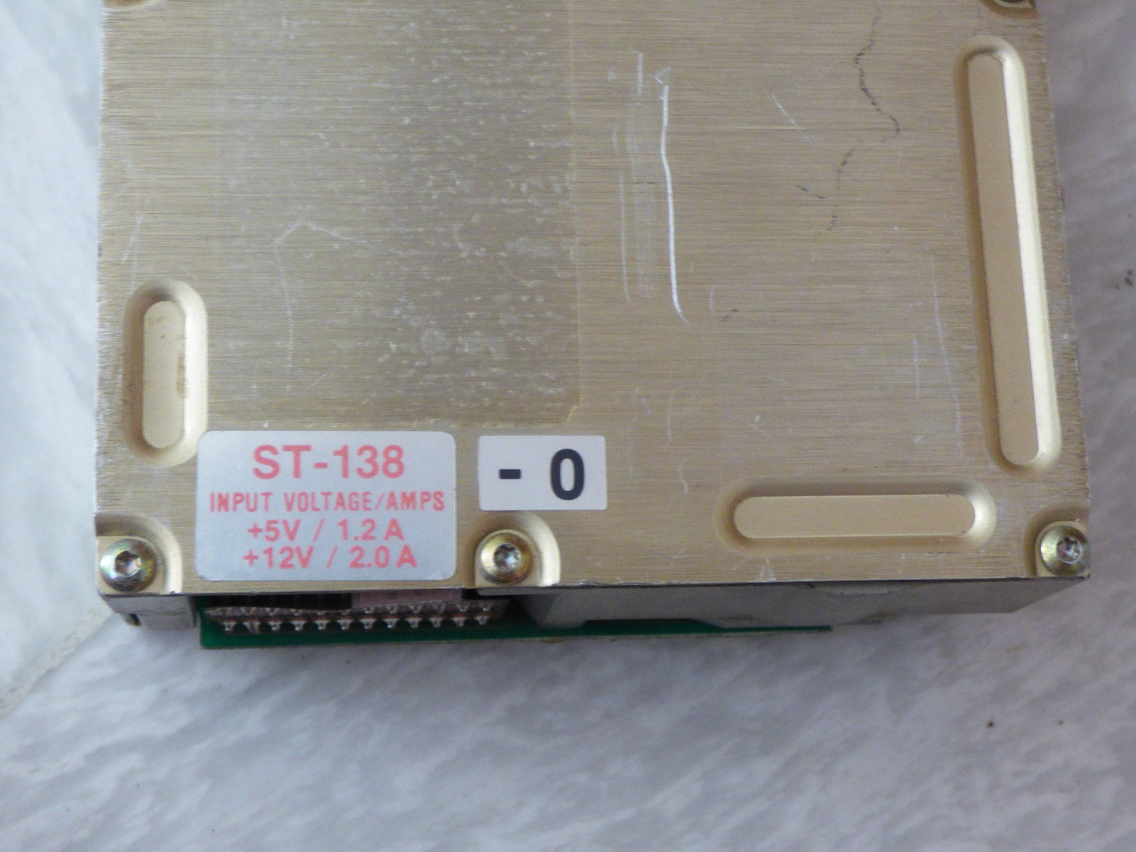

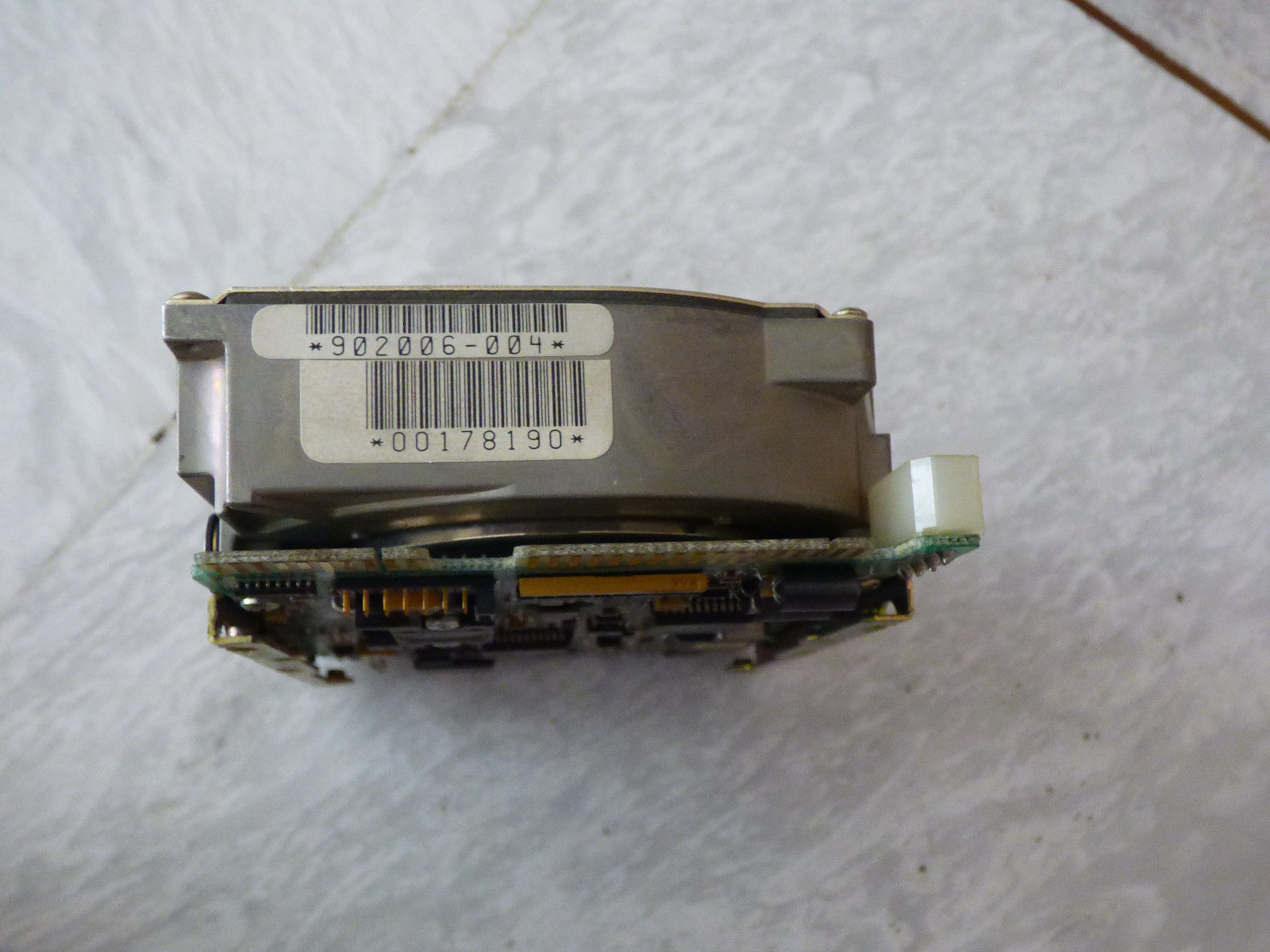

Finally found time to connect "SEAGATE ST138 33MB 3.5" RLL Drive".
First don't spin, so I kick it a little and now start perfectly ;)
The Winny check it and boot, so I simply need to format it.
But...I've tried 4/5 time without success: all the time the system advice that the media is BAD.
Miracle drives comes pre-formatted...they use some special parameters for initalize the drive?
This HDD works perfectly on DOS and can be formatted and used without problem.
There is a way to solve this problem? I suppose that need that a Partition will be created as we do on the QUBIDE. Exist a command that made it?
Antother thing: the original MINISCRIBE have a LIGHT / STATE of the HDD connected on the disk, with the Seagate I find a similar part but I'm not sure is the same ;)

Thanks for all the help.
