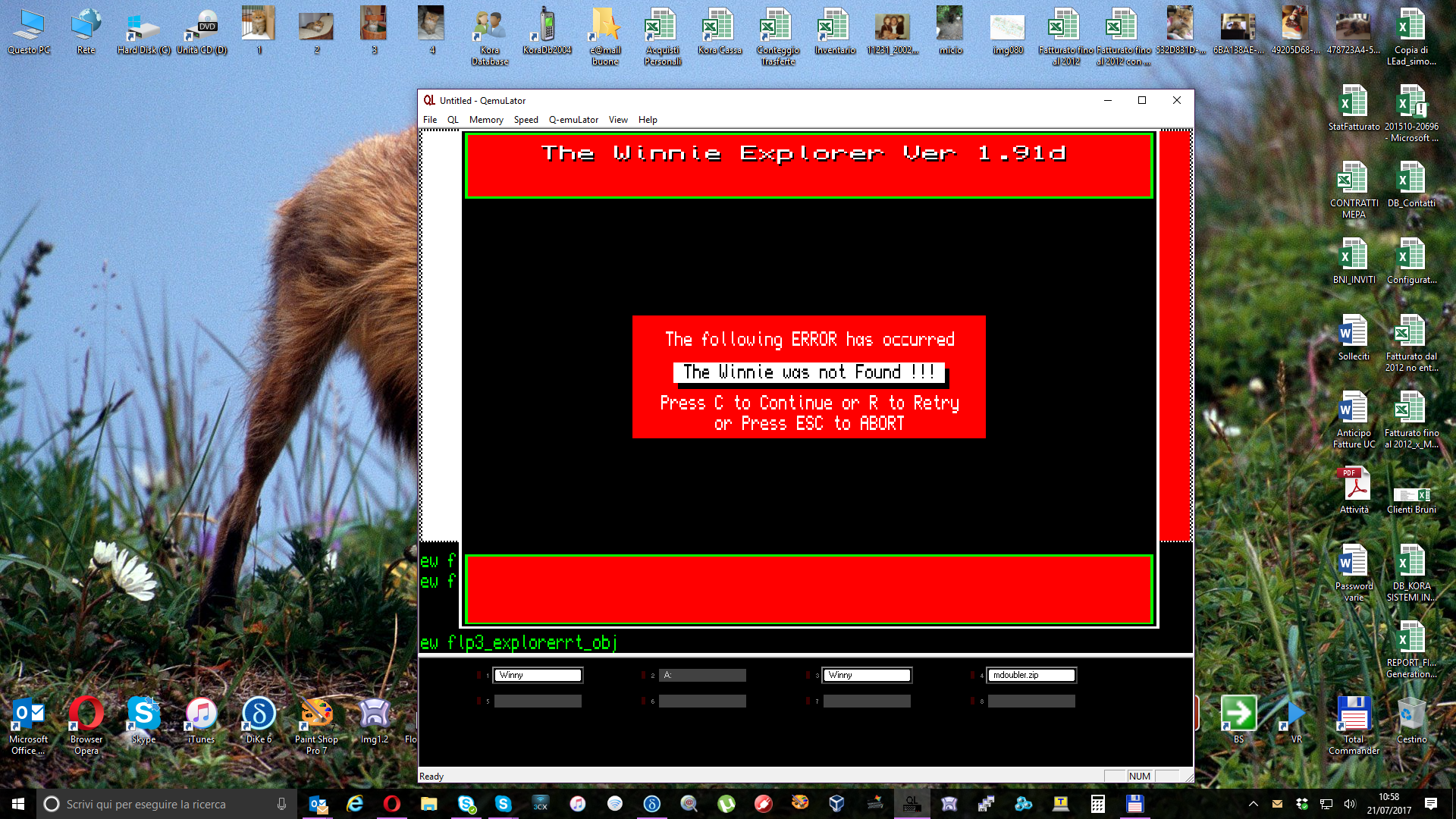

Outsoft wrote:Found these but...the links won't works:
https://web.archive.org/web/20060509091 ... e16_it.htm
Someone have it?
Thanks.
The Explorer by Chris Fowler is at:
http://www.dilwyn.me.uk/files/Explorer_v1_91d.zip
The pgrogramme is compiled Qliberated Superbasic, one version with runtimes included.
Which is supposed to read the Miracle Hard Drive, but I have never used it.
Outsoft
Posts: 697
Location: Italy
Re: Winny problem
Post by Outsoft »
Someone have it?
Thanks.
Tested on Q-emuL and seems start: I will try it in hours, thanks!!
