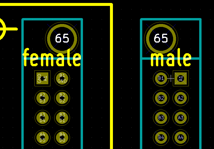

I have started my PCB design, as it seems a better option to using prototype backplane board.
I seem a little bit confused about DIN expansion connector pinnout.
QL Concepts Guide gives such pinout as MALE, I guess I need to put FEMALE in the design, but there is yet another view such as solder side, connector side.
My design software offers these two DIN pinouts, it is top view solder side.
Can anyone help to choose?
Many thanks TCAT

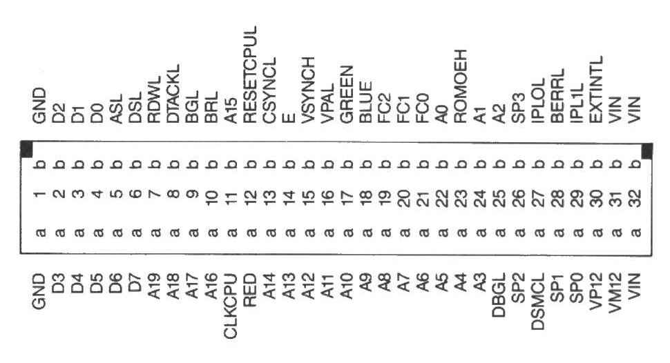

QL DIN pinout
QL DIN pinout
Posts: 3211
Re: DIY RAM EXPANSION
Dave,
according to the document on the Reichelt site, the "a" row is always the bottommost on the connector and the pin row closest to the card edge. Your picture seems to show the non-angled connector pinouts - They are slightly different and have the mounting (screw) between "a" and "b", but closer to the "b" row. The angled ones have it outside (towards card edge) of "a".
Hope this doesn't confuse even more....
tcat
Posts: 633
Post by tcat »
Tobias,
"A" pins are on the edge, I was afraid so.
Meaning that "A" row contains most of the address and data line pins, this makes it difficult for track routing. To reach address and data pins on the PCB the tracks would have to go between many "B" row pins.
Correct?
Many thanks so far.
TCAT

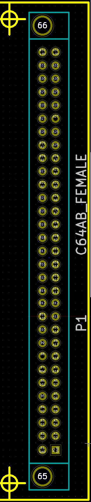

tcat
Posts: 633
Post by tcat »
Dave, Phill,
Expansion card edge with connector imprint, TOP VIEW, should look like that.
Correct?
Thanks so far.
TCAT
QL expansion card edge
Posts: 2877
Yes, the two ground pins 1a and 1b are at the bottom. The three VIN pins are at the top, 32a and 32b, plus 31b.

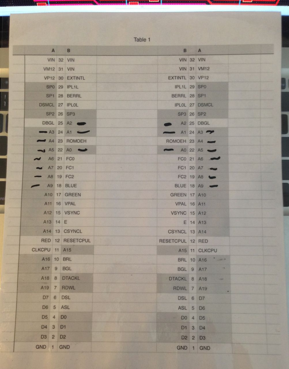

I made this handy laminate that I use with a dry erase marker when hooking stuff up - great for keeping track...
QL on right, thru-conn on left. :)

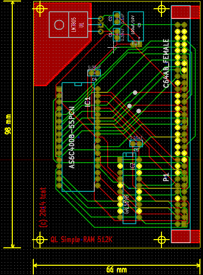

My first ever PCB, 3 vias in grey, unconnected pads in yellow.
I skipped prototype backplane, relying mostly on forum advice, how certain can I be, it will work in the end?
Thank you ALL so far.
TCAT
ql520 ram pcb
