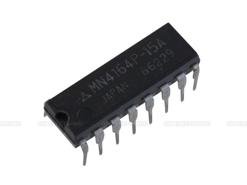

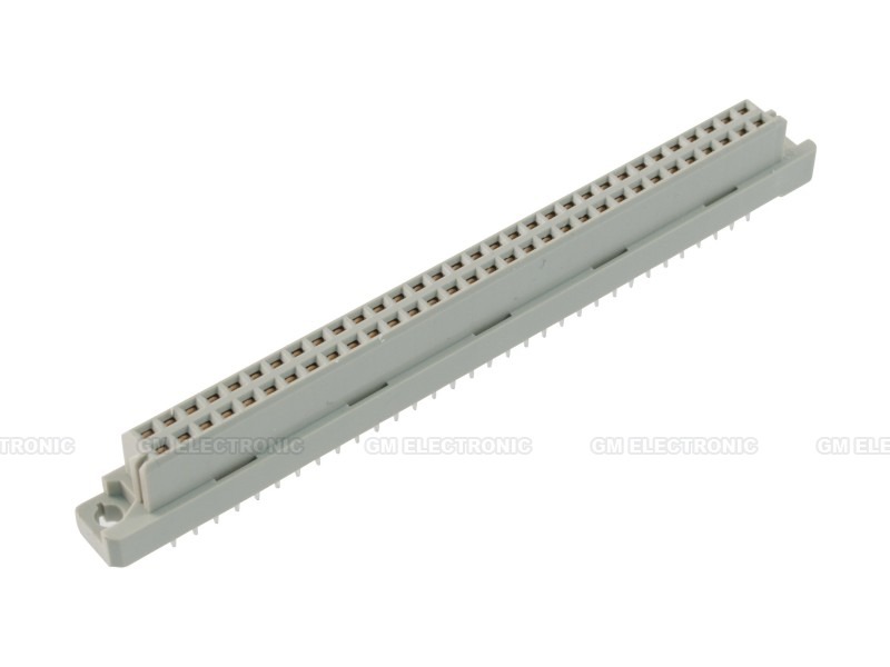

Dear All,
I have a plain 128k no TK2 good quality QL, I wish to expand it with a little amount of RAM, to get at least to a double i.e. 2x128k, as was the Sinclair option for QL developers back in 1984.
I am not much good at h/w designing as most of you here likely are. I looked at these components I wish to use to build my own expander ram.
DIN 2x32 1pc of female connector
DRAM 4164 a handfull
Some capacitors, resistors, not sure what values
Please see pictures. I would welcome any guidence or suggestions of yours, as for where to get recommended PCB layout, is there an article in one of the QL USER back issues covering this, what other components I may need etc.
In the QL Technical Guide, there is a paragraph covering external peripherals and expansions, but I realise I need more advice to get started.
Many thanks in advance

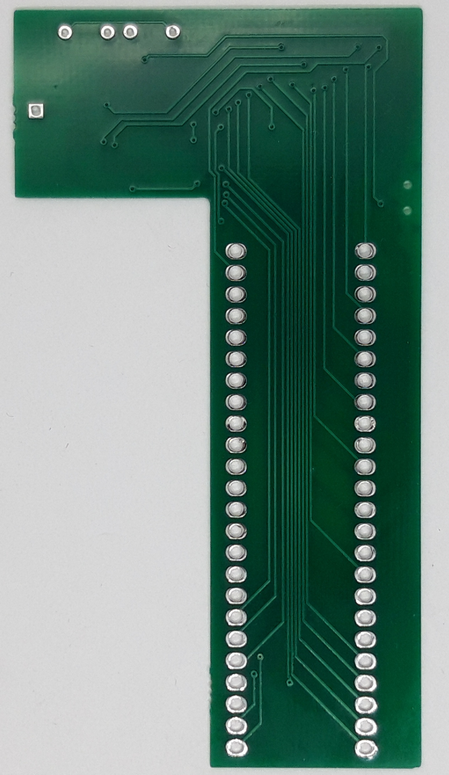

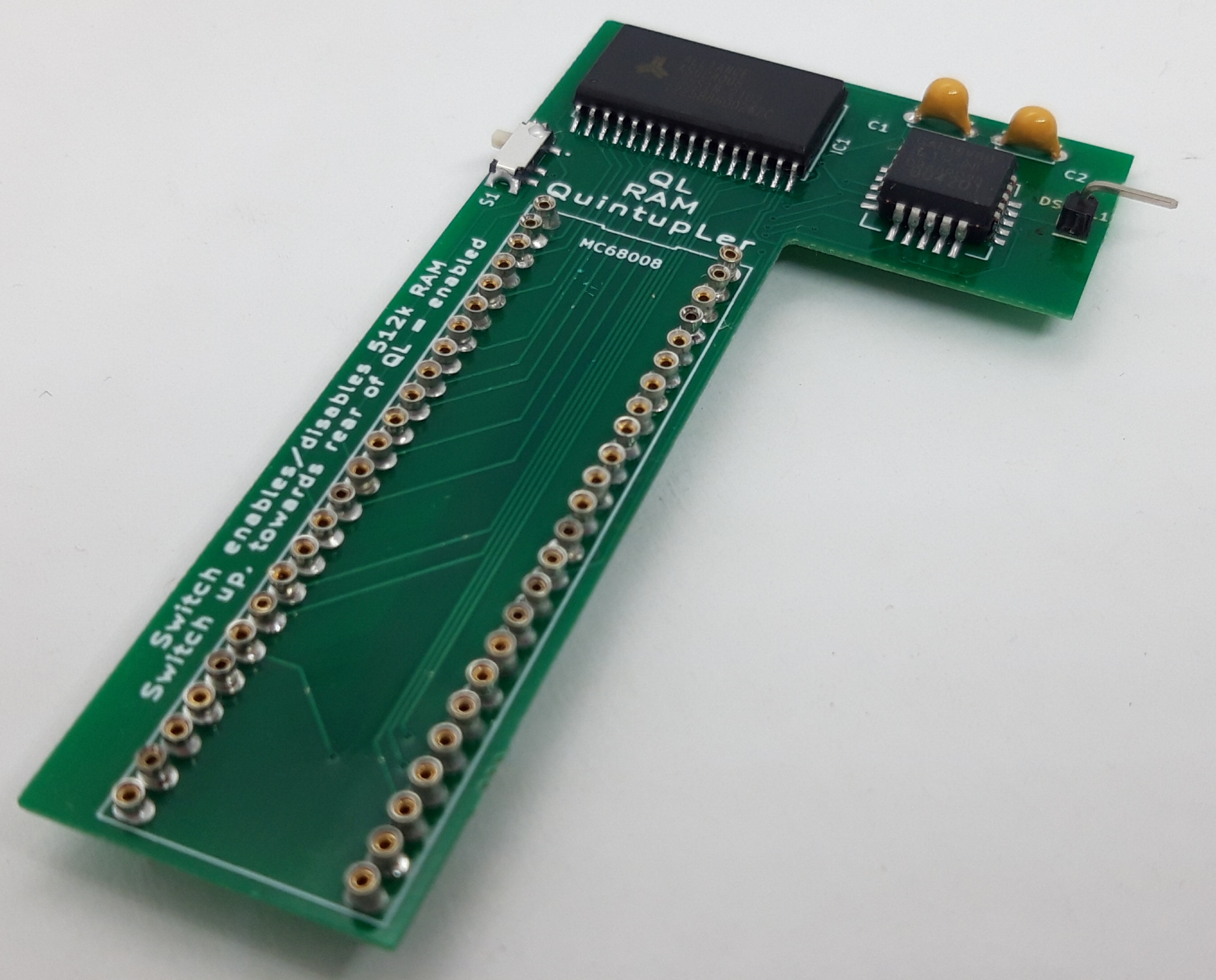

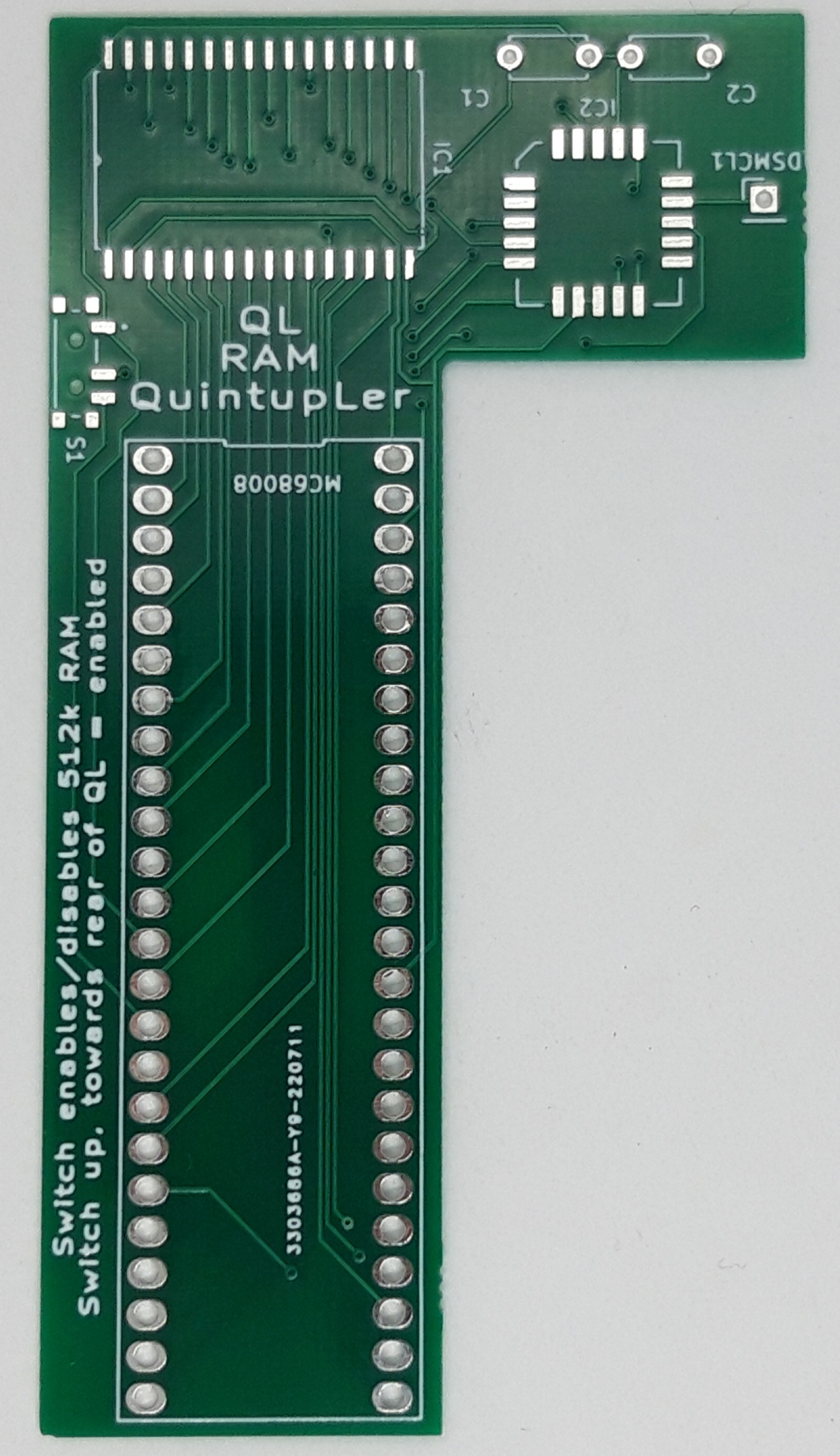

I built one using a 512K SRAM chip and a PAL...Now where I found this design? I'll look for it and post here

Re: DIY RAM EXPANSION
There will be a properly made 896K SRAM-based memory expansion on the market in just a few weeks.
