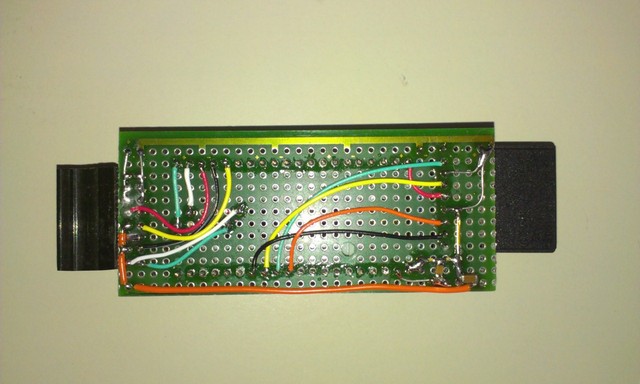

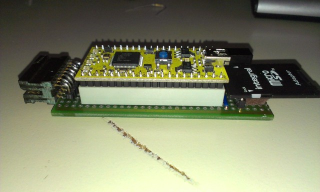

From breadboard to prototype..
Prototype connected to MD port
proto MD emulator
proto MD emulator
simple connections
simple connections
I used a Recom 7805 replacement R-785.0-1.0 (switching type regulator) to reduce the voltage from the QL (9 Volts) to 5 Volts before feeding it into the mbed. Theoretically it would be possible to attach the raw QL voltage directly to the mbed (allowable input is 5 to 9 Volts). The SD card adapter is used as a microSD connector. You can solder on those adapters quite easily and they are free with each microSD card...
