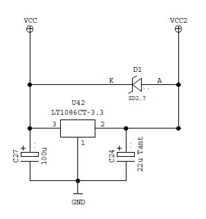

Silvester wrote:Not sure I understand the 3V3 supply arrangement, referring to image in last post: Square pad in group of three pads is Ground. Square pad next to power connector is +5V. With link in place (as shown) +5V is fed to other two round pads.
For 3V3 conversion replace link with 2V4 Zener diode: cathode to +5V square pad, anode to pin 2 (Vout) and pin 3 (Vin), with ground on pin 1 (ADJ/GND) of regulator.
(I can only assume there is a link somewhere to be removed between pin2/3.)
I don't fully understand. Let me rephrase:
1. Place Linear Voltage regulator on the three adjacent pins, heatsink toward PCB border.
2. Place Zener Diode with cathode toward power connector, instead of the wire used on Q40.

Thanks for diagram, that helped explain what is going on in the hidden PCB layer, that makes a lot more sense :D

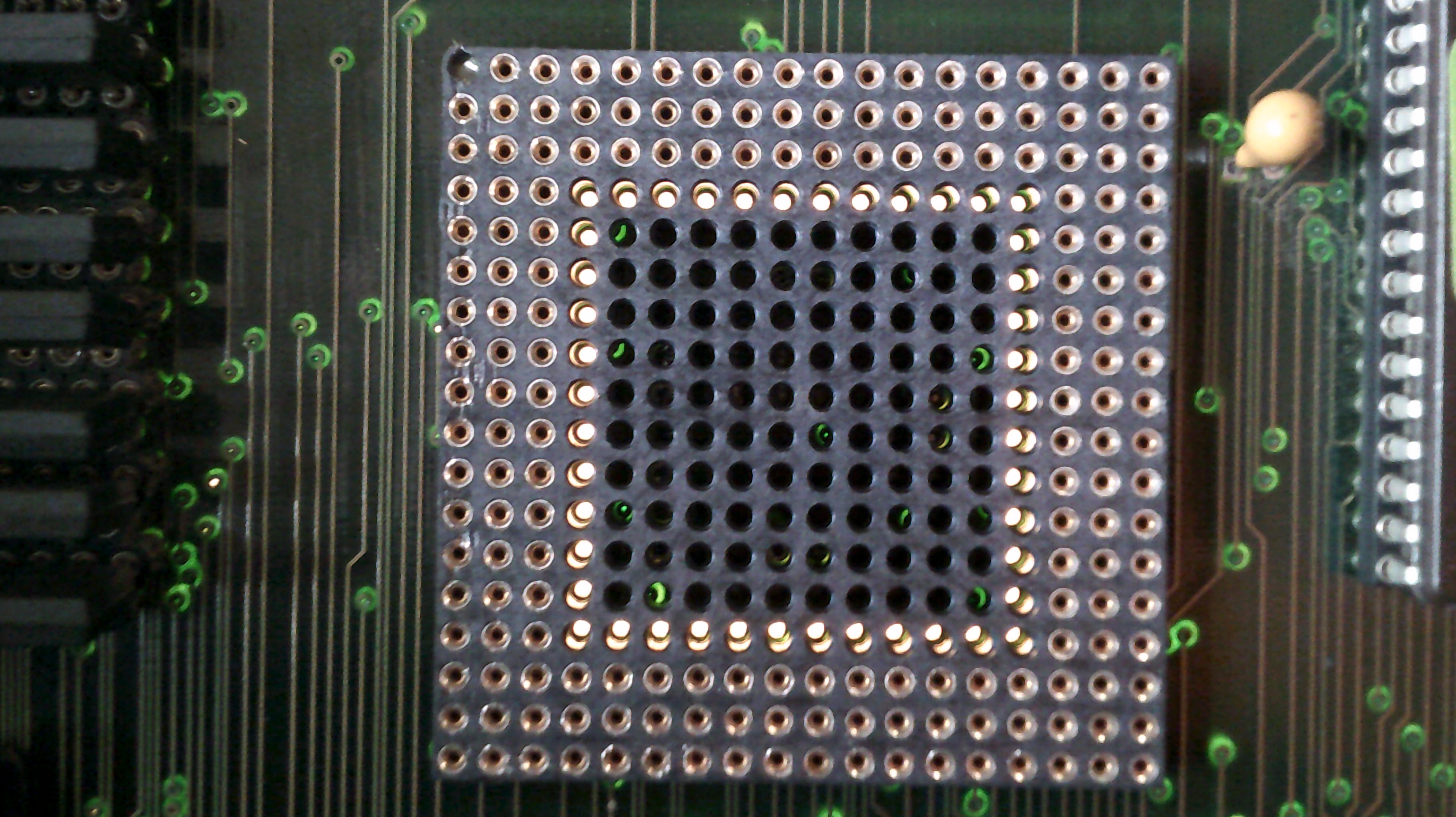

Q40 PGA socket
Q40 PGA socket
Slight identation into socket on left edge unavoidable due to video RAM making it awkward to gain horizontal access. Backlit so empty PCB holes clearly visible. But thankfully all CPU pins remained straight :)

Once the regulator and Zener diode are in place I'm guessing to revert it to 5V it is OK to just put link across Zener diode? Also what voltage Zener 2V4 or 2V7 ?
I read elsewhere overclocking 68060 rev.6 (71E41J) to 80MHz may require up to 4V5 to CPU, would it be inappropriate to consider installing adjustable LT1086 on my Q40?

So by my reckoning I'm going to need 25 (26?) sockets:
VCC (14) : D8,D10,D12,D15,E4,E15,G4,G15,J4,J15,P4,Q10,L4,N15
GND ( 5) : F4,F15,H4,H15,Q9
/CLA     : K15
/SNOOP   : P15
/CLKEN   : Q8
/BGR     : Q11
/TRA     : Q12
/BTT     : Q15
no pin   : D4 ? (unassigned in MC68060 manual)

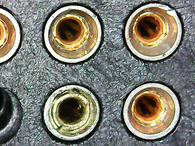

Peter wrote:Now let's hope your CPU socket allows easy addition of the 68060's extra pins.
Tried dropping in normal turned pin sockets, but don't seem to be same quality, the cone is less forgiving of misaligned pins (bottom left is newly inserted, others are original).

Silvester wrote:Tried dropping in normal turned pin sockets, but don't seem to be same quality, the cone is less forgiving of misaligned pins (bottom left is newly inserted, others are original).
Still it looks quite good! Personally, I would do it this way.

Silvester wrote:Once the regulator and Zener diode are in place I'm guessing to revert it to 5V it is OK to just put link across Zener diode?
Yes. And remove the (output connection of) regulator, of course.
Silvester wrote:Also what voltage Zener 2V4 or 2V7 ?
Both are fine.
Silvester wrote:I read elsewhere overclocking 68060 rev.6 (71E41J) to 80MHz may require up to 4V5 to CPU, would it be inappropriate to consider installing adjustable LT1086 on my Q40?
