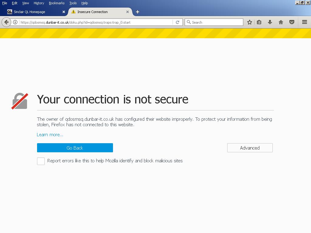

This is the following message I get when clicking on Norms link. A better demonstration of entering supervisor mode would be hard to beat.

Regrading "Your connection is not secure", that's because my site hasn't paid up for an SSL certificate yet. So you can only go there with HTTP rather than HTTPS.
I'll get around to it some day.
In the meantime, if you trust me, click "advanced" then there will be a link saying "proceed to qdosmsq.dunbar-it.co.uk (unsecure)" you can click that to get to the site.
