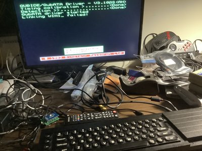

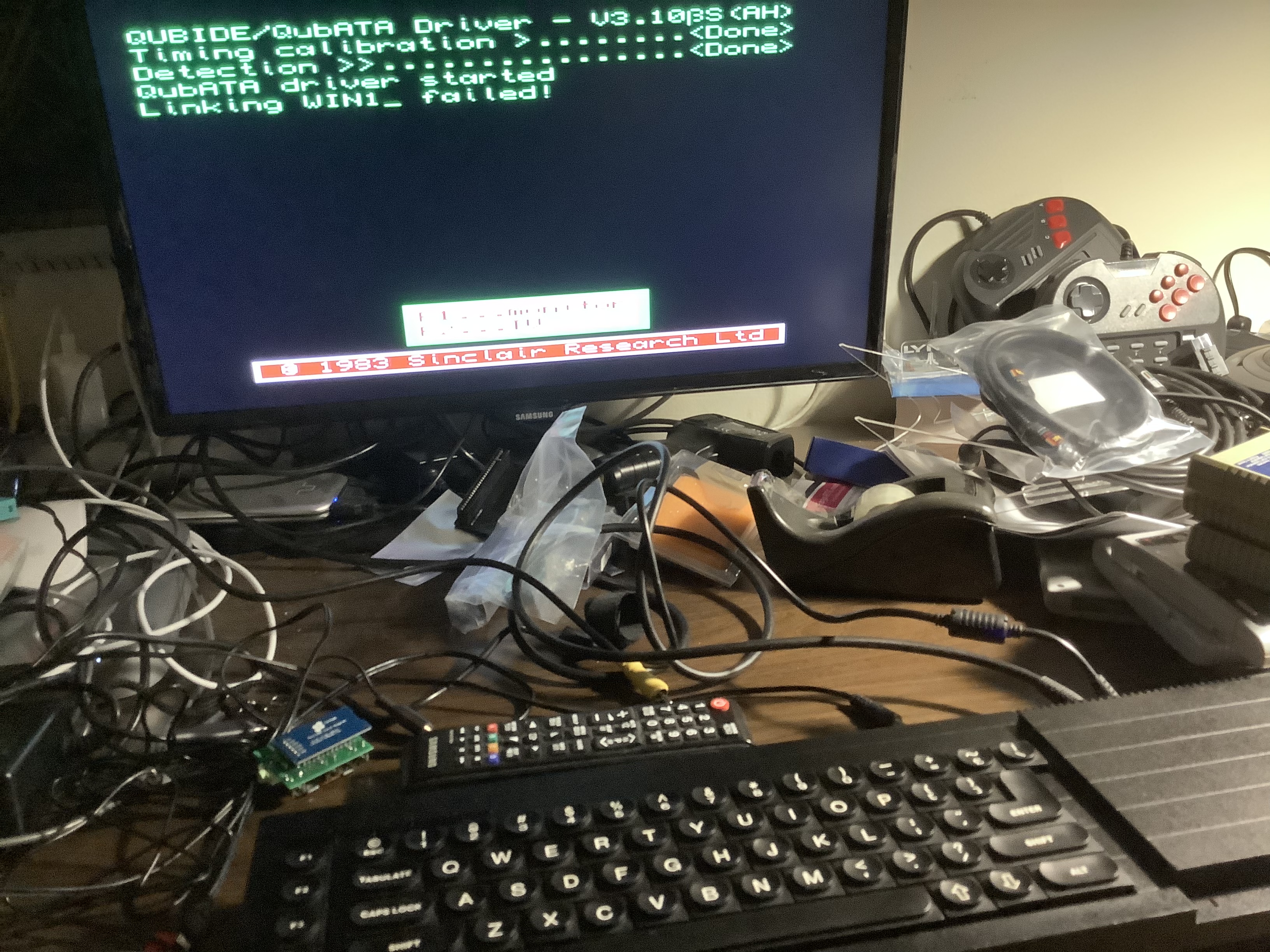

af0l wrote:Well I just soldered together tetroids qbide :)
But it gives me black screen for now - I reall need to find an IDE device. Not so easy anymore :)
If podt a picture of each side of the board, we might be able to help.
I have soldered a few of these Tetroid boards, the main problem area is having the resistor array the correct way around.

Thank you, Derek and everyone else, for your valuable input. In the end it was me again - I actually switched GAL's 1 & 2 :shock:
Now I REALLY need to find me a working IDE device. Got a DOM inbound from China, but that's weeks away...
