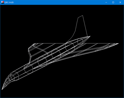

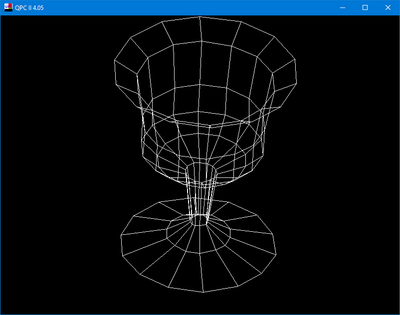

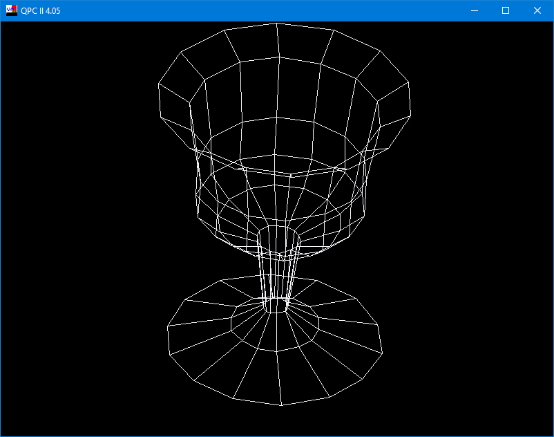

This is Tridim 3 for SMSQ/E systems.
I have decompiled the original Tridim program back to SuperBASIC and made it work in SMSQ/E.
This version could do with a little more work, but I am releasing it for testing and feedback.
Things I know that need more work are:
System 4 views, inverting the screen with 'N' does not work properly.
Saving a screen dump only works in QL screen modes.
Having Tridim in a subdirectory can cause problems. Unless you use something like a DEV device.
I have put quite a lot of time and effort into this program, and I fancy a break from it for a while. If anyone feels like picking up the reins and running with it. Please feel free.
