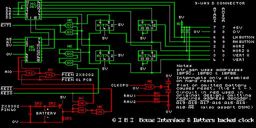

Qimi at $1BF9C/$1BFBC/$1BFBE. See Dilwyn's site for my Qimi SCR (also PNG).
QIMI does not just occupy those three addresses used by the driver, but every address it gets mirrored to.
I hope to be wrong, but from a very quick look at the picture on Dilwyn's site, it seems like QIMI contaminates lots of the area between $18xxx and $1Bxxx by incomplete decoding.

This:
http://www.dilwyn.me.uk/docs/manuals/qimi.png

Peter wrote: I hope to be wrong, but from a very quick look at the picture on Dilwyn's site, it seems like QIMI contaminates lots of the area between $18xxx and $1Bxxx by incomplete decoding.
It doesn't seem to me like this is QIMI's fault, but rather incomplete decoding of the original QL memory done by the 8301 or, in later revisions, the HAL. QIMI uses /PCEN && A10 as a base address. To me, it seems like the 8302 would occupy the complete area (maybe, depending on what exactly happens in the 8301 and/or HAL) anyhow and QIMI just steals 1024 addresses from there by intercepting /PCEN.

Yes, but there is the remark "omitting requires address decoder... also assert DSMC" which led me to the assumption that some QIMI devices have that incomplete decode also.

Peter wrote:Yes, but there is the remark "omitting requires address decoder... also assert DSMC" which led me to the assumption that some QIMI devices have that incomplete decode also.
I'd rather think that means "you can leave the red part away" (not relying on /PCEN), "but then you need to replace this with an address decoder" (which can be a good one or a worse one, but hopefully is a proper one).
You apparently still need to intercept PCENL in order to not have it answer to that full address range.

Peter wrote:QIMI does not just occupy those three addresses used by the driver, but every address it gets mirrored to.
I did the diagram from a rough hand-drawn circuit from QImi PCB supplied to me by by Dennis Briggs/Terry Harman. Apparently they didn't have much luck getting one working external to QL PCB. I did. I also supplied Nasta with same info and he implemented Qimi on Aurora. Yes of course it contains a lot of incomplete decoding, but you don't need them, you can just decode what you need ie. just three address - or a 256 byte area (as I did, and quite obviously Nasta).
Yes, that is my comment. The diagram is copy of Qimi which sits on ZX8302 and intercept pin. I did the part in red to show what you don't need if you make one external - just provide your own decode as suggested.
