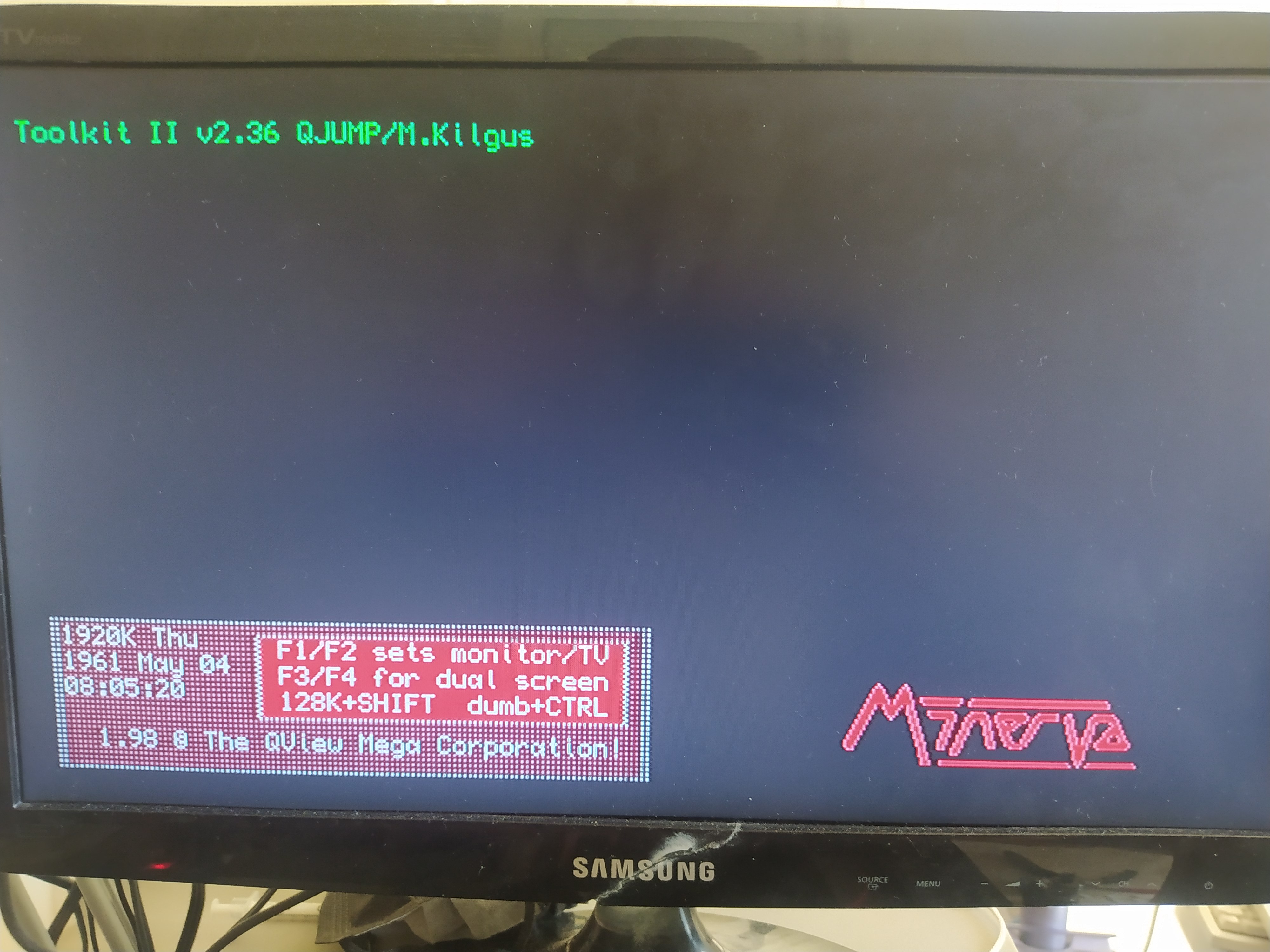

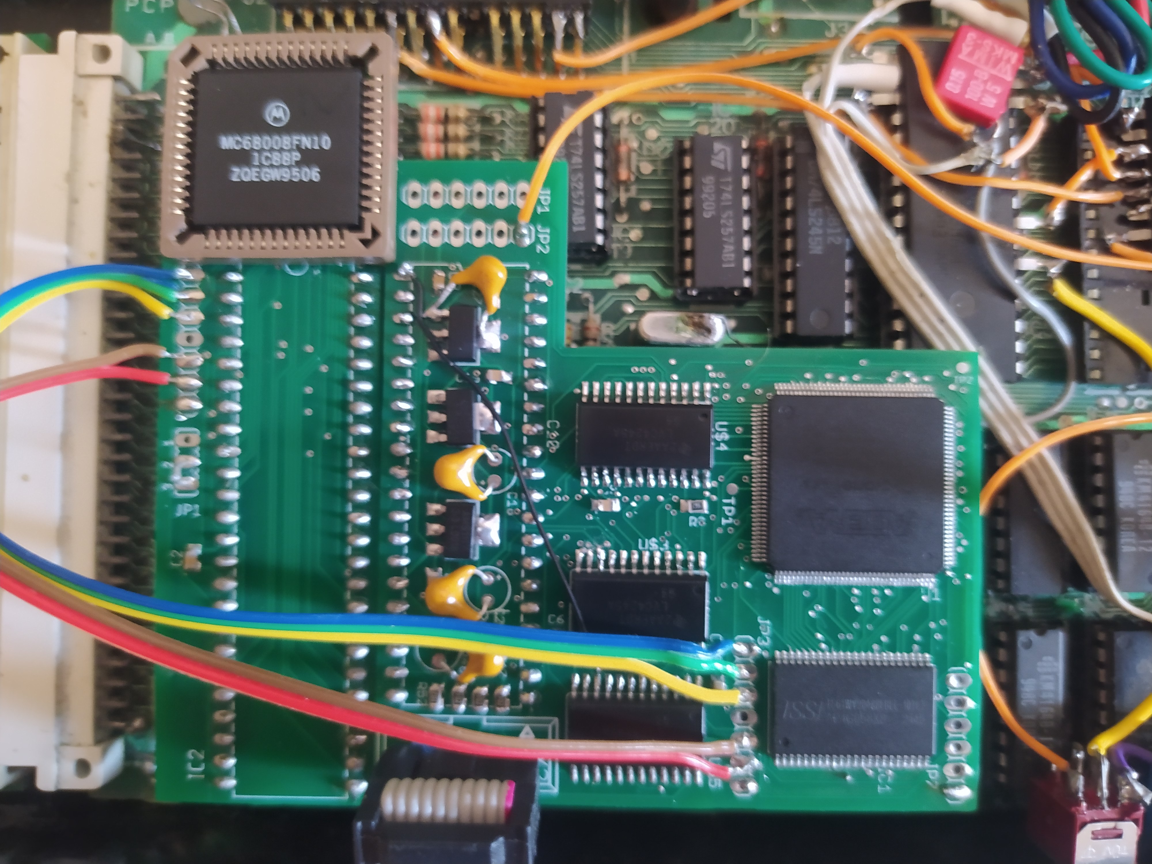

I started a fpga (altera/intel cyclone IV) ULA project plus a PLCC52 68008 board.
QL sees 1920K of the on board ram but if a card with rom is present then it stops there counting ram, so with my qubide clone it stops at 832K.
It already supports what the cpld offered and the faster video memory and I hope I'll add a lot more taking my time.
