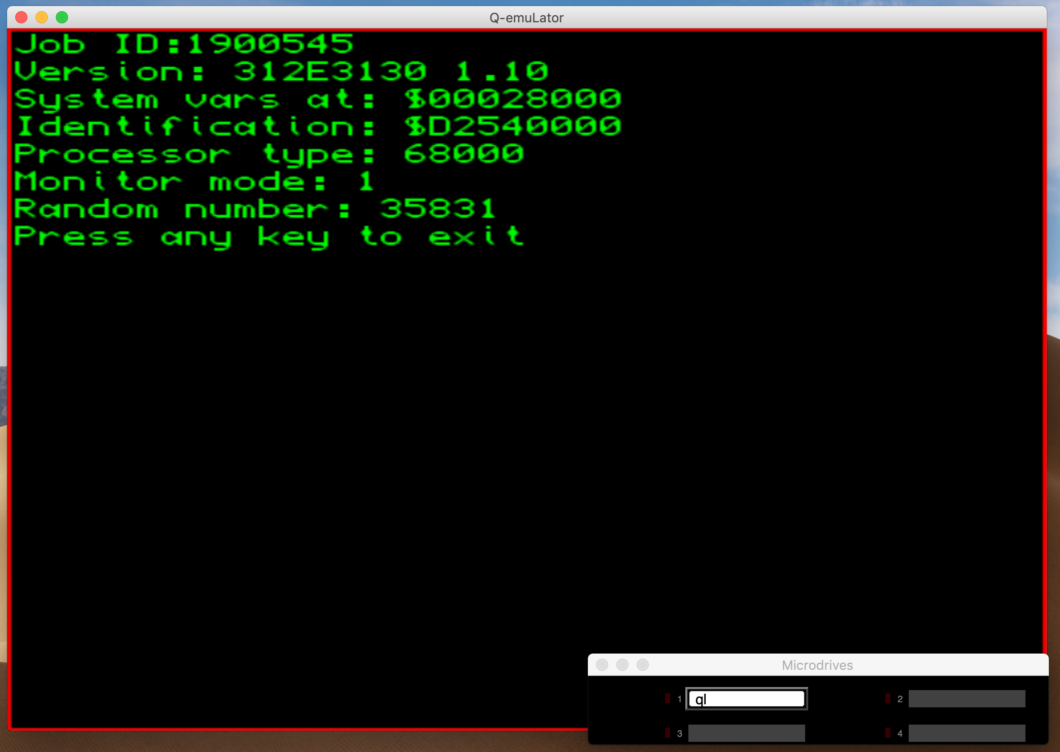

NormanDunbar wrote:A quick fix for today. The existing MT_INF in qdos.inc has the system variables address coming back via a pchar and the ASCII version via a plongint. They are the wrong way around. Patch 6 fixes the problem.
Sorry Norman, but I'm pretty sure this patch is wrong, but having said this, I'm not saying the original version in there is entirely correct. But there I copied the mt_inf() function signature from QL-GCC libc actually.
If I understand properly the description, the ver_ascii info is returned in D2, which means the short 4 char ascii string is actually in the register itself, and not pointed by the register. The fact that the system vars are PPChar is not elegant, perhaps in Pascal it should be a PPointer (pointer to an untyped pointer), or PPByte (pointer to a pointer of bytes) instead. But as I said the function signature was copied from QL-GCC, where it had a char **, so I went with PPChar. That could be fixed/changed indeed, but ver_ascii as PLongint is correct. You need to pass a pointer to a longint (or well, any storage 4 bytes long) to make this work. And passing PChar is dangerous, because the resulting characters won't be zero terminated, so writing them can cause issues, unless the pchar buffer is a fixed size array.
If we really want to make this elegant and Pascal-ish, I'd just make another function signature which allows these as pass-by-reference arguments, and then make it pass an array of 4 characters as reference instead. but because in FPC you can just typecast a longint to a 4 byte array and vice-versa, I think this is a really minor issue. Plus the compiler protects you, and gives an error in case you want to cast a wrong sized array.
This is how it works (with the original function signature):
program inf;
uses
  qdos;
type
  Tver = array[0..3] of char;
var
  job_id: longint;
  ver_ascii: longint;
  system_vars: pbyte;
const
  SV_IDENT = $00;
  SV_TVMOD = $32;
  SV_RAND  = $2e;
  SV_PTYP  = $a1;
begin
  job_id:=mt_inf(@system_vars,@ver_ascii);
  writeln('Job ID:',job_id);
  writeln('Version: ',hexstr(ver_ascii,8),' ',Tver(ver_ascii));
  writeln('System vars at: $',hexstr(system_vars));
  writeln('Identification: $',hexstr(pdword(@system_vars[SV_IDENT])^,8));
  writeln('Processor type: 680',hexstr(system_vars[SV_PTYP],2));
  writeln('Monitor mode: ',system_vars[SV_TVMOD]);
  writeln('Random number: ',pword(@system_vars[SV_RAND])^);
end.
The output of this code looks like this:
I mean, the castings to get the various offsets are slightly ugly this way. The right way would be to define a record type, where you can just reach all fields with the right offsets, or, worst case have a GetByte/GetWord/GetLong() helper function which would contain/hide all the messy pointer gymnastics. But as far as I'm concerned, maybe the system_vars argument type should be changed to PPbyte, instead of PPChar, but nothing else.
