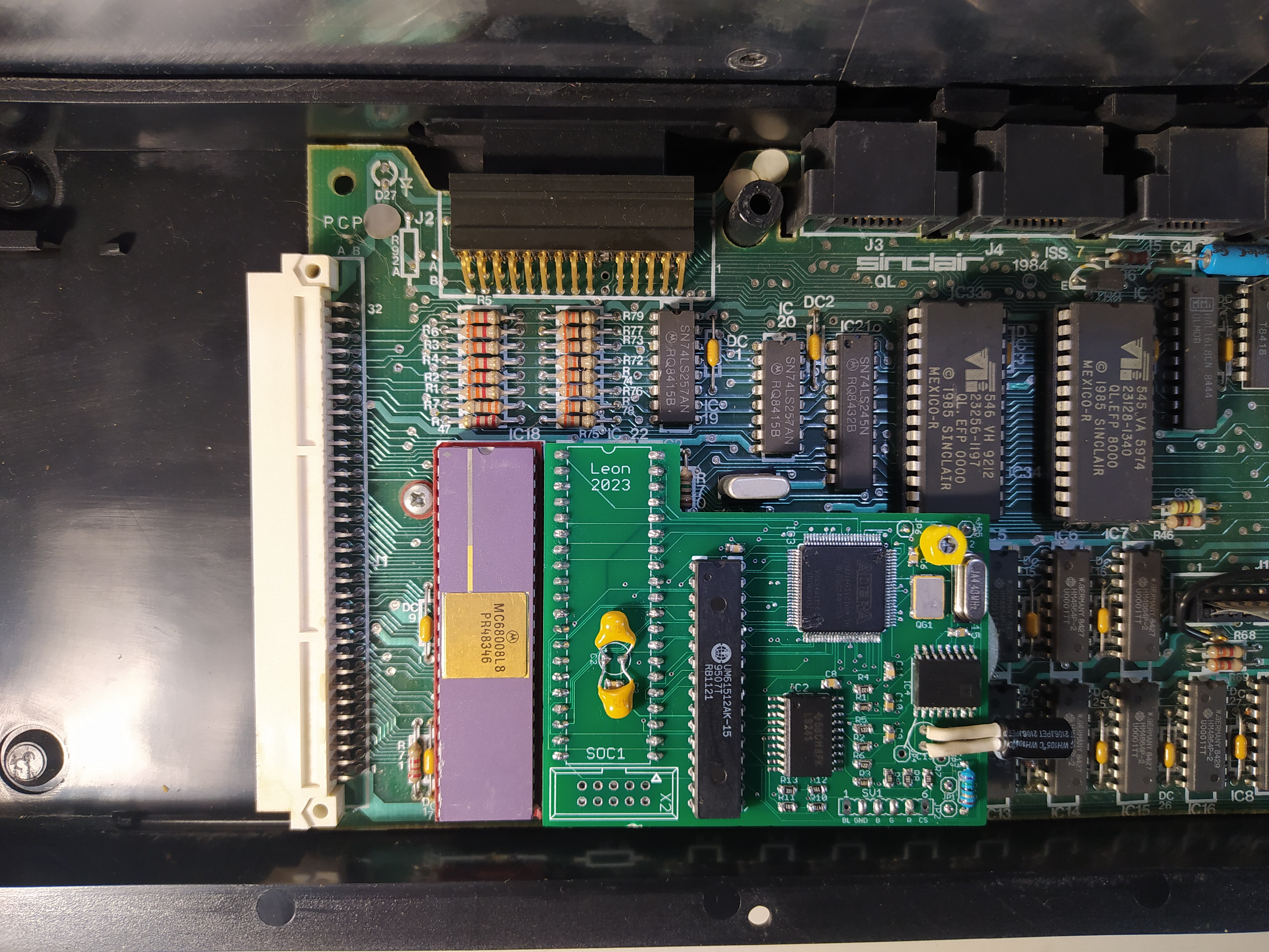

I finally managed to test the pcb with issue 6 and 7 motherboards and it works well.

The last upgrade is very nice, you can see the difference in a simple dir or list command, QL scrolls faster and also games are faster.
I'll make a summary when I finish with the new pcb I am waiting, for the Xilinx cpld but I haven't decided if I'll make public the fast lower/video ram version.
