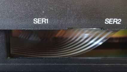

I don’t think there will be any issues with a 90 degree bend using new membranes. Once installed there will be stresses in the membrane but it will be static stresses. What breaks such membranes is usually fatigue. In other words, install it and leave it alone.

I think what breaks the QL membrane usually is heat and stress. Peter's board will likely not give out much heat.

I checked my crystal sphere and I foresee there will be a solution for those who like to have a few centimeter of ribbon cable between the board and the membrane connectors. Trust in me!

I have removed and attached case top and keyboard at least 20 times by now and did not have the impression of too much stress.
Here is a peek from the back:

But that is without anything else in the way, at least wouldn't connectors for SER impinge?
(I'm OK with replacing membrane connectors with something else and using extension connector.)

Silvester wrote:But that is without anything else in the way, at least wouldn't connectors for SER impinge?
Only SER1 is supported, which should be okay. The british QLs don't have the D-Sub space at the back anyway and would use the extension slot cover. Which everybody else also can do. Easier than extending the keyboard cables.
