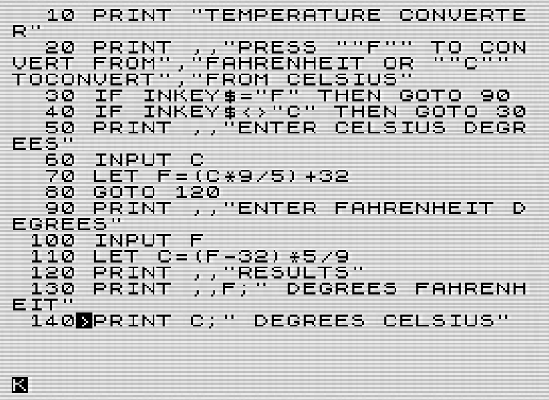

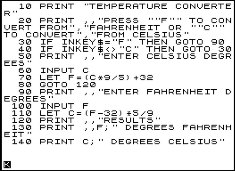

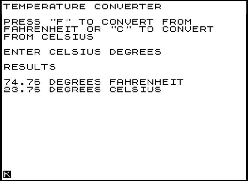

...and here is my first typed-in program requiring non-integer math from the web. It's simple but it worked right away.
So first, the program I found on the web:
Next, after typing it in, here is my version:
...and finally, running it gives the correct asnwer:

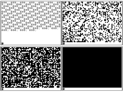

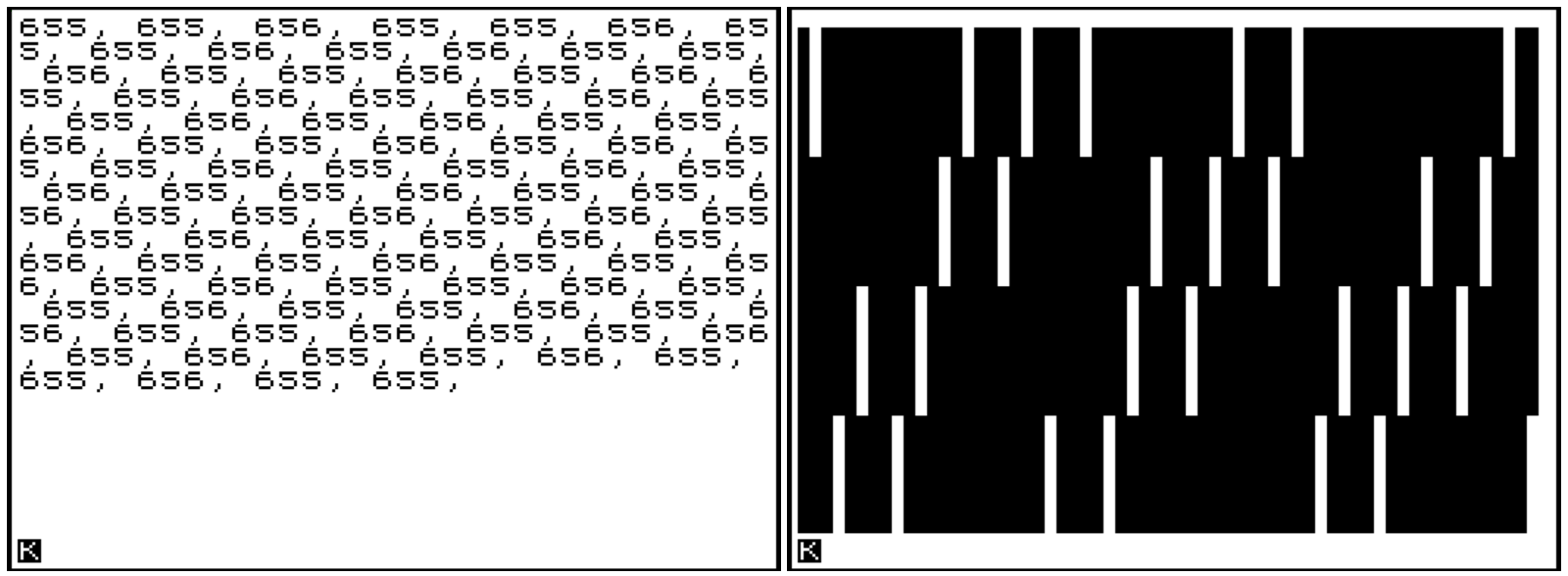

Implementing a working random number generator (RNG) with only 2-point precision was interesting. I first tried to implement the RNG that the ZX81 used as stated in Wikipedia on Lehmer RNGs:
seed = (75 * seed) / 65537
That didn't quite work, as it showed some patterns in its scatter plot, though the histogram showed it being evenly distributed:

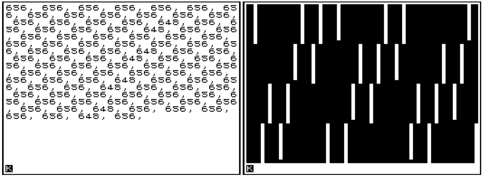

Then I realized the ZX81 BASIC book actually gives the formula they used, which is slightly different from the Wikipedia article:
seed = (75 * (seed + 1) - 1) / 65536
However, that also didn't work out as the scatter plot still showed the same issues, and the histogram is a little different (maybe a little less even as the two values are 656 and 648 as opposed to 656 and 655):

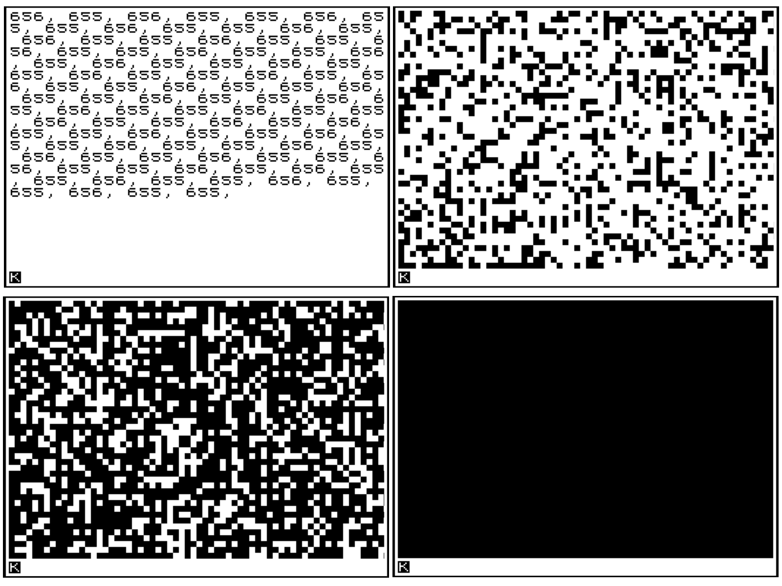

So, I had to look for a different RNG and found this one online (I don't know what it's called):
seed = (31421 * seed + 6927) % 65536
This one works, and passes all the markers...the plots below show it in stages from about 1100 values, to 3300 values, to fully covered:
I haven't tested the RNG that the ZX81 (and presumably the Spectrum) uses with full floating point precision but I suspect it does just fine. It's this 2-point precision that seems to trip it up and I don't really understand why? Does that mean we are seeing some flaws in it?
[Edit: Here are is the scatter plot and histogram BASIC programs]
