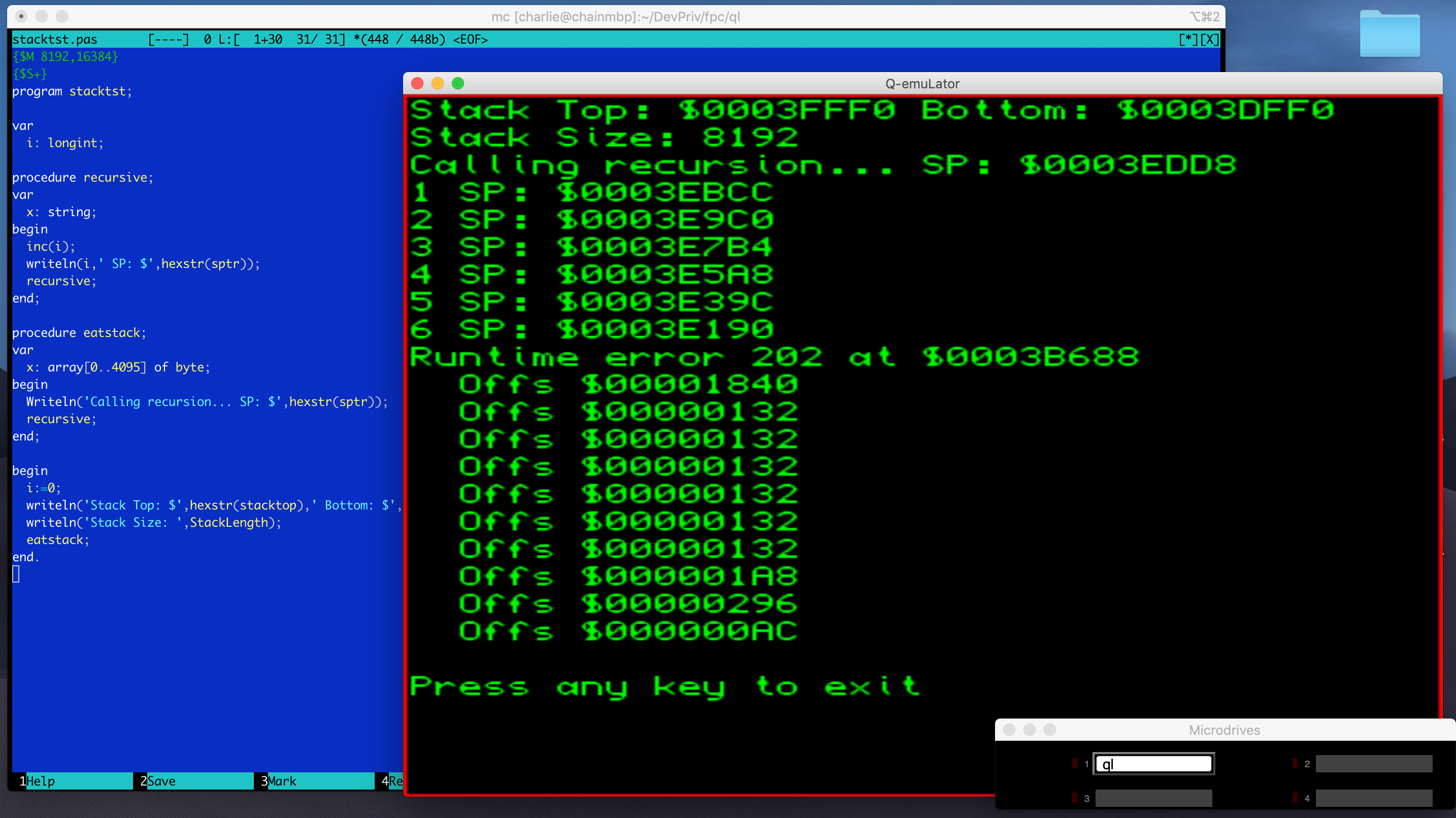

In other news, I had some overnight fun with stack pointers, so now the QL port sports working stacktraces, and even stack checking. This later is optional, enable it with $S+ directive, or -Ct compiler command line argument, but it's a debug feature, not to be included in production software due to its performance implications and because it really isn't a silver bullet: there are scenarios where the program could still overflow its stack. But I'm sure it's helpful to debug some cases anyway. Note the stack checking code works with 5% (or max. 16KiB) of stack space safety margin, so the RTE 202 will occur before the stack has actually overflown, unless you have a function which uses more stack than the safety margin.
Only one is visible on the screenshot, but in the stack traces two different kind of lines are possible. "Offs" lines, they show the offset from the code start within the binary. And "Addr" lines, which would be absolute addresses, in case some stack call offset is outside the binary's code range, and they're somewhere else in memory. The offsets are really useful if you use the -Xm compiler argument. Then FPC tells vlink to generate a human readable linker .map file. Using the map file, the offsets can be turned into function names with relative ease, when debugging.
