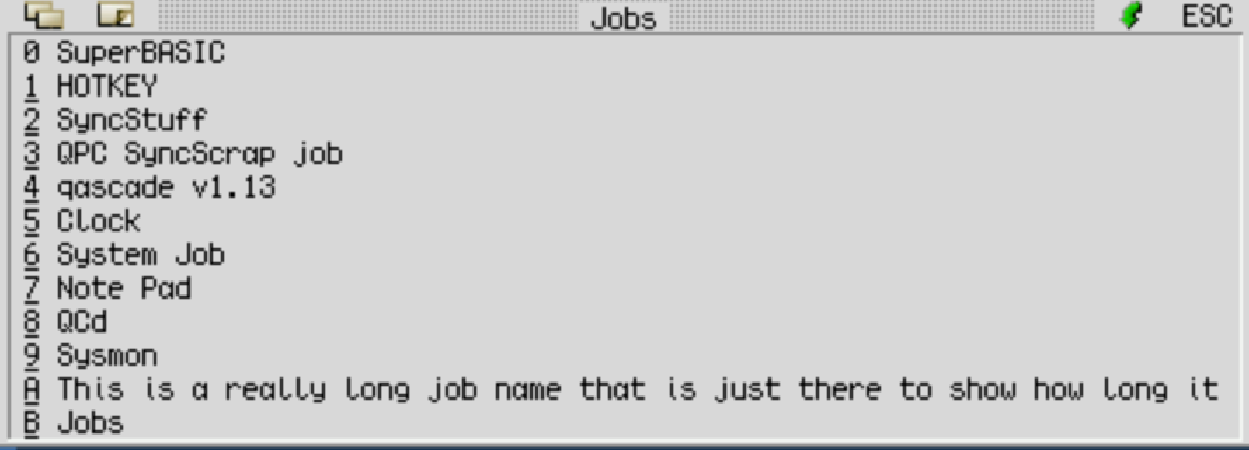

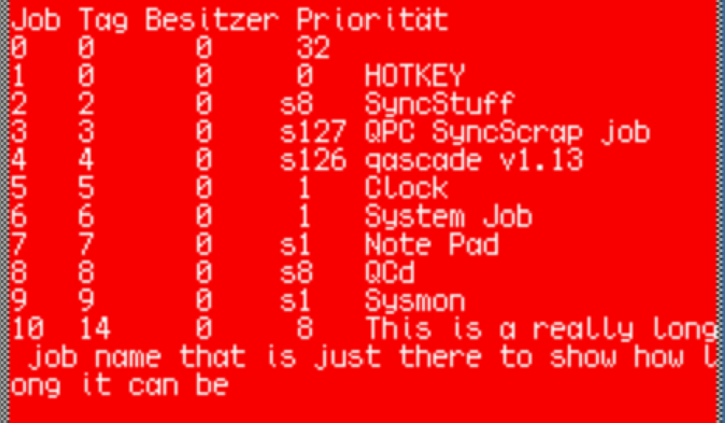

I don't think there is a limit other than the job name is just a QDOS string that lives in the job's code space, and most people use short branches to reach across that string (which would mean something along the lines of ~120 characters). There might be limits of how many characters of that string are actually being displayed by the job tools.
A quick test in assembly reveals:
"JOBS" in TK2, for example, seems to happily display everything you throw at it, the job listing in QPAC2 seems to have a limit of 70 displayable characters (and simply cuts the name at that length), Sysmon displays whatever fits into its current button size.
Such long job names (and even longer ones) actually make a bit of sense when you want to include both the program name and the file you're currently working on - like QD does, for example
