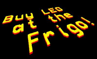

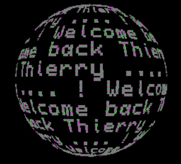

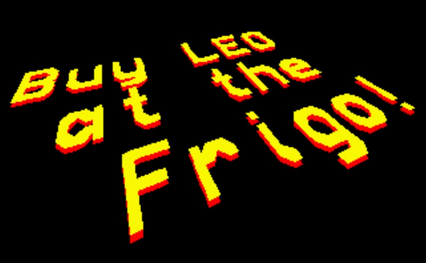

Hi Folks,
It is a simple matter to map text to any curved or plane surface, as seen from the images attatched.
But writing a shader to map textures would require accurately Peeking into a SuperBasic window, (or buffer).
Peeking the screen is awkward in view of the QLs method of accessing Pixels.....
If anyone has written a function to find the colour of a pixel at any screen position, I would be prepared to write a prototype shader for the QL.
I did once map the screen of the 'WEST' cartridge onto a flying carpet, but it was not pixel perfect, for the reason mentioned !
Steve.
