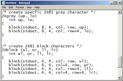

Another new version:

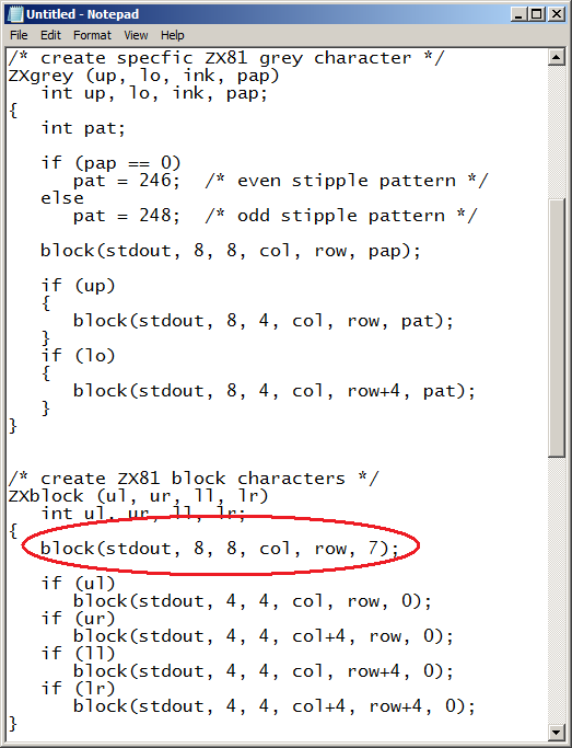

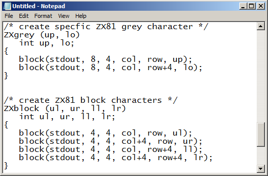

So whenever I try out a new ZX81 BASIC program I find some small bug or idiosyncrasy. If you gave the ZX81 Vroom clone a try you might have noticed that during change of track you saw a white streak...well what I did, whenever printing out either a full black block or a quarter-, half-, or three-quarter block I would first clear the screen with a block inverted (so usually that means a full white block as circled in red in picture) but that caused this side effect, plus it was inefficient code.
I was doing this in both block and grey routines, passing in 1 or 0 for true and false and then figuring out what to plot.
Why not instead pass in the color/pattern that I need and get rid of all that conditional. Then, I never have to invert the entire screen and just plot each quater-block (or pixel as they are seen in ZX81) as white or black.
So in the end less code. Not clear if it's faster or slower since I always do 4 block calls now whereas before I may have only done at minimum 2 and at maximum 5. But in the latter case I also had to do 4 conditionals, so it depends on how slow the block call is and if doing an 8x8 block takes more time than a 4x4 block (Update: new code is faster...)
But now the flicker in the Vroom clone is gone and it behaves exactly like it does on the ZX81.

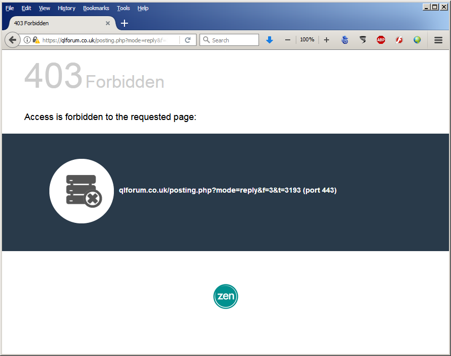

P.S. qlforum wouldn't let me insert the code this time so I had to use pictures...kept giving me this page:

P.S. the code tag in the forum is still broken...looks like it crashes when you use an "if" in the code listing. I substituted the character "i" with the ASCII character with code 141 and that worked.

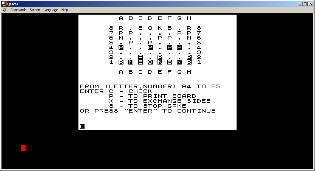

I found the bug because I finally was able to retrieve an old ZX81 BASIC chess program I typed in and got to work when I was a kid. I had to modify it a lot from the original Tim Harnell version that came from his Giant Book of Computer Games book since the ZX81 didn't have DATA statements and his game used upper/lower characters for the pieces and scrolled the board up the screen each time.
Here is the ZX81 BASIC for Chess:
Note that when I tried including it as a code listing, it once again caused qlforum to hit the 403 page (and perhaps crash as well). This was the problematic line (note I replaced the IF with ?? to get it to work):
Also curious is that if I rearrange it and put the RND first then it doesn't crash qlforum:
IF I>10 AND A$<>"Q" THEN
IF A$="C" AND I<100 THEN
590 ?? (A(AX)=K OR A(AX)=P) AND RND*10>1 THEN RETURN
590 IF RND*10>1 AND (A(AX)=K OR A(AX)=P) THEN RETURN

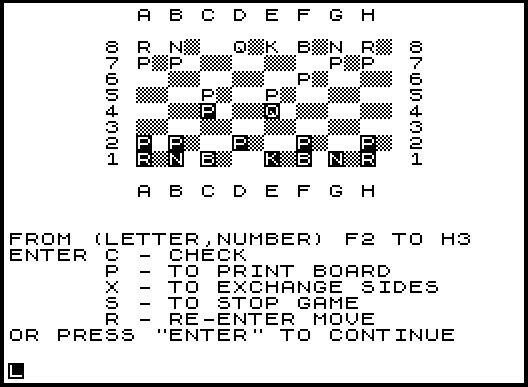

Been a long while since I posted on my ZX81 ROM emulator. Still not complete but earlier this summer I did update it and add support for 2D string arrays. That will likely go up to 4 or 5D when I add floating point but for now 2D is pretty useful and I haven't seen much use beyond that (maybe 3D for different image scenes).
I also reduced the code size a bit so there is a net reduction, which is always good after adding a bunch of new code (a bit complex to do 2D string array subscripting in ZX81 BASIC since it's so flexible) -- it did slow down slightly but that's to be expected when adding more features that add more capabilities (we're talking about 2-3 seconds over 90 second test though that's testing that specific feature...i.e. it's not an across the board slowdown, just with subscripting).
Here is the latest version. If you take a look at it you will also note that the source (src_zip) is no longer one long file but made up of 5 since I finally figured out again how to do multi-file compiles:
I've also been playing around with various chess programs so I updated Tim Hartnell's chess to give it a better board. It's not included in the zip since I didn't author it, but you can play it on the http://ZXSimulator.orgfree.com website.
...and here is the ZX81 BASIC chess program you can either run in ZXSimulator or convert to a .p file and laod into another ZX81 emulator or real machine.
It was fun converting the chess program to ZX81 BASIC -- still a fun language to program in IMO.

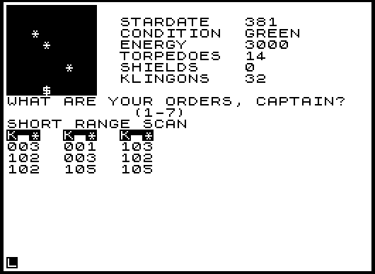

Found a cool Star Trek game for the ZX81 (Bug-Byte version) and so I adjusted it to run on My QL ZXSimulator. It's been uploaded to the website:
http://zxsimulator.orgfree.com/
To run just type LOAD "WIN1_TREK_BAS" followed by RUN to try out. It's a slightly simpler version of David Ahl's Super Star Trek game from the book BASIC Computer Games that one of the two on the QL is a direct conversion of. I did try the other, more sophisticated QL version and it looks like it adds a few more features, though is based of the same game engine that all of them seem to be.
This ZX81 version (Bug-Byte) plays well, esp on the ZXSimulator. It comes with pretty easy to understand instructions and its game-play is pretty intuitive (i.e. moving north is direction 0, north east at 1, east at 2, etc...some others have very weird directional systems that were hard to remember). I tried a whole bunch of the other ZX81-based ones and was disappointed in them, even the all-machine code versions that had some cool graphics. I was surprised by how well the Bug-Byte one played and it was mostly written in BASIC (one set PEEK/POKE). The only thing that's missing is the galactic map feature, where it remembers where you've been beyond the 8 quadrants around you...I may add that in eventually to make it more complete.
Here's a screen shot:
I did have to do a few mods since my emulator is still not complete and doesn't yet support floating point operations...I haven't worked on it since last July but may look at it again this summer. So I had to make a few minor revisions to the BASIC code of the Star Trek game, some simpler than others, but they all perform as the original game did (ran it first on my actual ZX81 before trying it on the ZXSimulator).
The most interesting was having to approximate the square-root. The original call for firing phasers and figuring out how much damage the enemy sustained was this:
The approximation code was this:
...a lot of work to do a simple math function. I really need to implement floating point in ZXSimulator as it would make life so much easier.

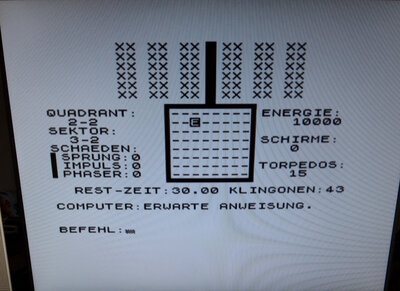

Talking of Startrek clones on the ZX81, many years ago a chap called Kilian Schlaich made a version that was retailed by ISS in Germany. I found a copy in 2019 and was able to digitise it, then track down Mr Schlaich. He gave me permission to share it freely and because the cassette contained no instructions (I don't know if it ever did) he wrote some for me, 38 years later.
Here it as as a zipped .p file, with text file instructions (all in German).
