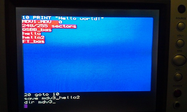

Very interesting project - please keep us informed of progress. Good luck with your work on this device.gertk wrote:Well, result! Yes... My first directory generated by the mbed and recognized by the QL..![]()
(snip)
Next step is to attach te sdcard to the mbed and get the sectors from there instead of my (huge) include file with the Quill MDV image...
Re: Microdrive data line format
Connection to the SD card made, reading and writing works at the moment to a .MDV image file in the main directory of the (micro)SD card !
