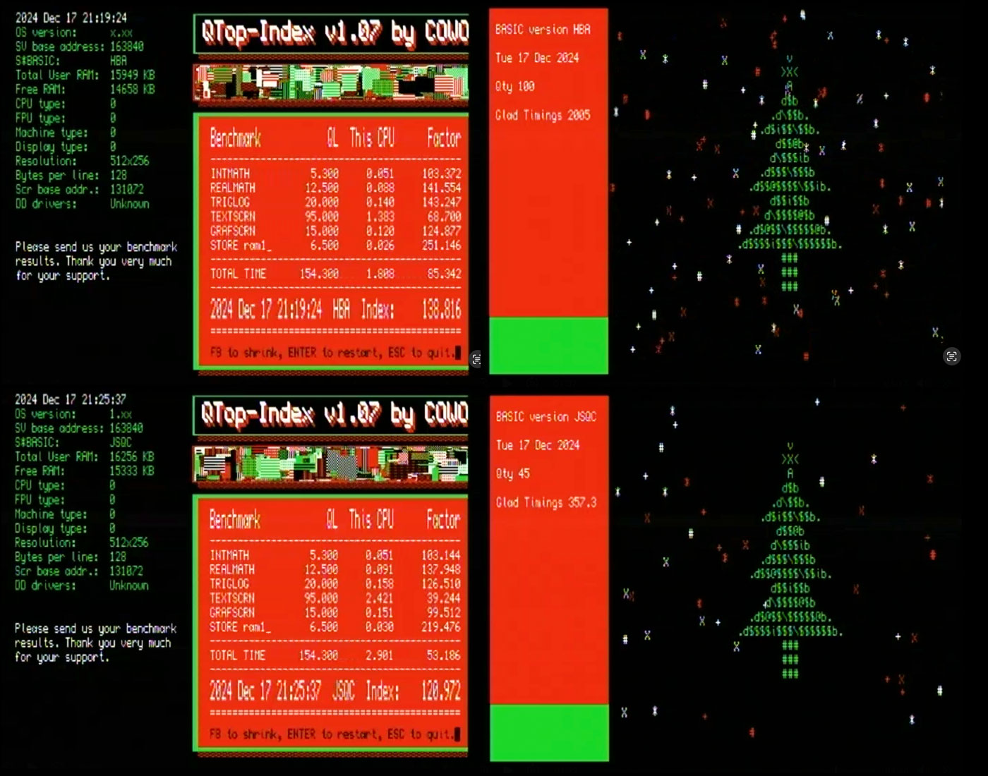

Hi Peter,
SMSQ/E at the top and QDOS Classic at the bottom.
I know you only asked for the QTOP + SMSQ/E timings but while I had my Q40 out of the cupboard...
Here is some timings from my Q40 with copyback enabled

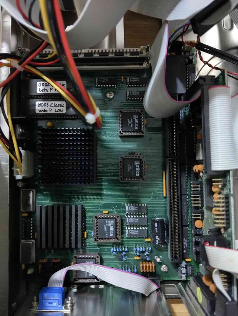

Re: Qzero with SRAM extension reaching 40 MHz 68040
Hi Mark,
oh how nice
Many thanks for your christmas benchmarks, glad you still have a working Qx0! QDOS Classic is still cool, an amazingly portable and modular QL OS. I hope it can be completed for Q68 and QIMSI some day.
Regarding my sensational headline, I'd have to back down now, if you really tested a Q40.
Your result is very hard to believe though. Because in Dhrystone, TEST909 and QSBB_BAS, the Q60/80 was almost three times Q40 speed. Which is reasonable, because the CPU runs at double clock speed plus the architectural and cache size advantages. Motorola 68060 Manual even states 1.6 to 1.7 times higher performance at same clock over a 68040.
And now a 80 MHz 68060 scoring only 39% better than a 40 MHz 68040? It looks like something went utterly wrong - but what?
I have SMSQ/E version 3.33 in Q60 ROM. Which definitely executed from the (faster) RAM.
I made sure that Writethrough differs from Copyback result. So cache mode selection works.
I've also checked BogoMIPS to be around 2 * 80 = 160, so the clocks work right.
Could you check if your Q40 has about 2/3 * 40 = 26.6 BogoMIPS as it should? Attached here for convenience.
Q-Top Index full of MOVEP instructions?
Does your Q40 run on steroids maybe?
More seriously, what comes to my mind is that some 60 MHz Q60 were made from 68060RC50 chips.
The factor between our results is not exact 80 MHz / 60 MHz, but due to external memory timings it is still plausible.
Sorry for the stupid question, but are you sure you actually have a Q40?
All the best
Hi Peter,
It started life as a Q40 and I don't remember an upgrade, but It's entirely possible that I may have forgotten.
The processor is obscured by a heatsink. I'll check 161(a6) and BogoMIPS after work.
Mark
It has survived by being stored at the back of my wardrobe. The computers stored in my loft have not faired so well.
It's not an unreasonable question.Peter wrote: Wed Dec 18, 2024 12:16 am Sorry for the stupid question, but are you sure you actually have a Q40?
Mark
Thanks for providing the Q60 privileged treatment.Mark Swift wrote: Wed Dec 18, 2024 8:12 am It has survived by being stored at the back of my wardrobe. The computers stored in my loft have not faired so well.
Thanks for the nice internal view on your Q60. Can't see the upper quartz oscillator exactly, but by now I bet it is 60.0 MHz. A frequency never used on Q40, and a clear idicator it must be a Q60/60.Mark Swift wrote: Thanks, I got the Q60 yesterday. Plugged it all in last night... works great.
Just not sure why the factor between our machines in Q-Top is 1.39 and not exactly 1.33. I did not optimize the Q60 DRAM controller especially for 60 MHz. It is probably the 66 MHz controller running 10% slower. Since SMSQ/E does regular cache flushing to DRAM (even when not required) this might be an explanation.
By the way, I noticed something a little weird. Under QDOS Classic with copyback cache, I get exactly 160.0 BogoMIPS as I should. Under SMSQ/E 3.3 it is only 157.9 BogoMIPS. I have no idea for what they consume 1.3% of CPU time with no extension loaded and no other job running.
All the best
