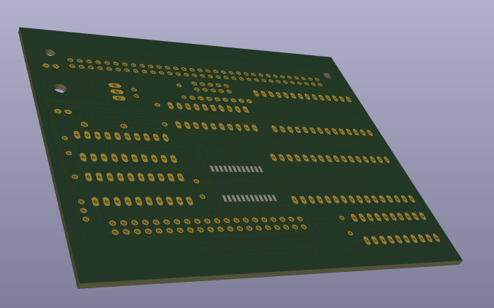

I have converted the Eagle Qubide data files into KiCad, here is a screen shot of the PCB: Just got some tidying up on the schematic to do.
If you want to get a new PCB with the mods done, this is a way to do it.
