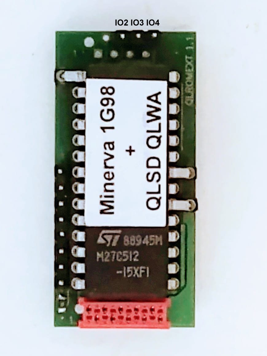

for optional coexistence with devices that reside in the address space $C000 to $FFFF, there is now an alternative PLD logic variant for QL-SD.
Instead of the rarely used SPI interface on connector P1, it expects a pin strip soldered to the three upper right ports IO2, IO3 and IO4. The alternative PLD provides three options:
(A) No jumper
QL-SD registers enabled and full ROM provided.
Tradidional QL-SD operation. No other device at $C000 to $FFFF allowed.
(B) Jumper at IO2+IO3
QL-SD disabled. Only ROM $0 to $2BFF provided.
Other devices at $C000 to $FFFF allowed, e.g. external ROMs or QIMSI.
QL-SD is only used to hold the operating system.
(C) Jumper at IO3+IO4
QL-SD card access enabled and ROM $0 to $2BFF provided.
A QIMSI device is allowed and will access an SD card attached to QL-SD.
QL-SD is also used to hold the operating system.
The card socket on QIMSI must be empty.
The JEDEC file containg the alternative QL-SD PLD logic is attached, together with the source code.
Use at your own risk, this PLD logic was not tested comprehesively.
(A) No jumper

Re: QL-SD jumperable
Hi Peter,
thanks for this update. As we just discussed I made 1000 write, read and delete cycles with a SCREEN$ and this new firmware. Each with the SD card in the QIMSI as well as in the QL-SD. No Errors observed. So should run well.
Best, Stephan
Best, Stephan
Hi Peter,
Further from this message in the Hacking Qubide thread:
viewtopic.php?p=54200#p54200
I soldered the 3 pin jumper onto the QL-SD ROM board and updated the FPGA code with the file supplied.
I can now use QIMSI with QL-SD SD Card reader and Minerva ROM, I have the Tetroid TDI card attached with the CF Card slot disabled, so QIMSI works. Quite a nice system, with twin Disk Drives attached to the TDIfloppy drive port, maybe needs a Gotek as FLP1.
The QIMSI mouse work okay, but I prefer to use the QL keyboard.
One other thing, I use the QL-SD SD Card to hold MDV images which can be loaded into the QL with Martin Head's MDI driver software, this also works with the vDrive as well.
I employ the same MDV image usage on the Q68, using an SD Card in Slot 2 as a FAT drive so MDV images can be loaded from the SD Card, and mounted as MDV1.
So really, I do not need extra MDV emulation hardware, the software solution is better, and in this way MDV access can be achieved on any QL system, including QPC2 or Q60.
