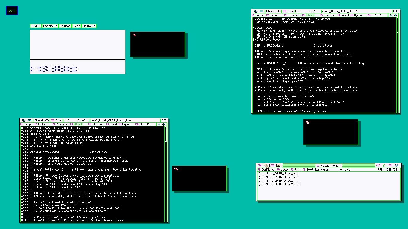

I have played with MINIQPTR_bas and found it worked first time in my setup. I interpreted it as an SBASIC daughter job, then compiled it with
line numbers and finally, after removing the instruction RESTORE, compiled it without line numbers. Programming without line numbers
is my preferred configuration.
The image below shows the three instances of MINIQPTR next to the code that created them. I don't understand the code but that is something for
a future session.
