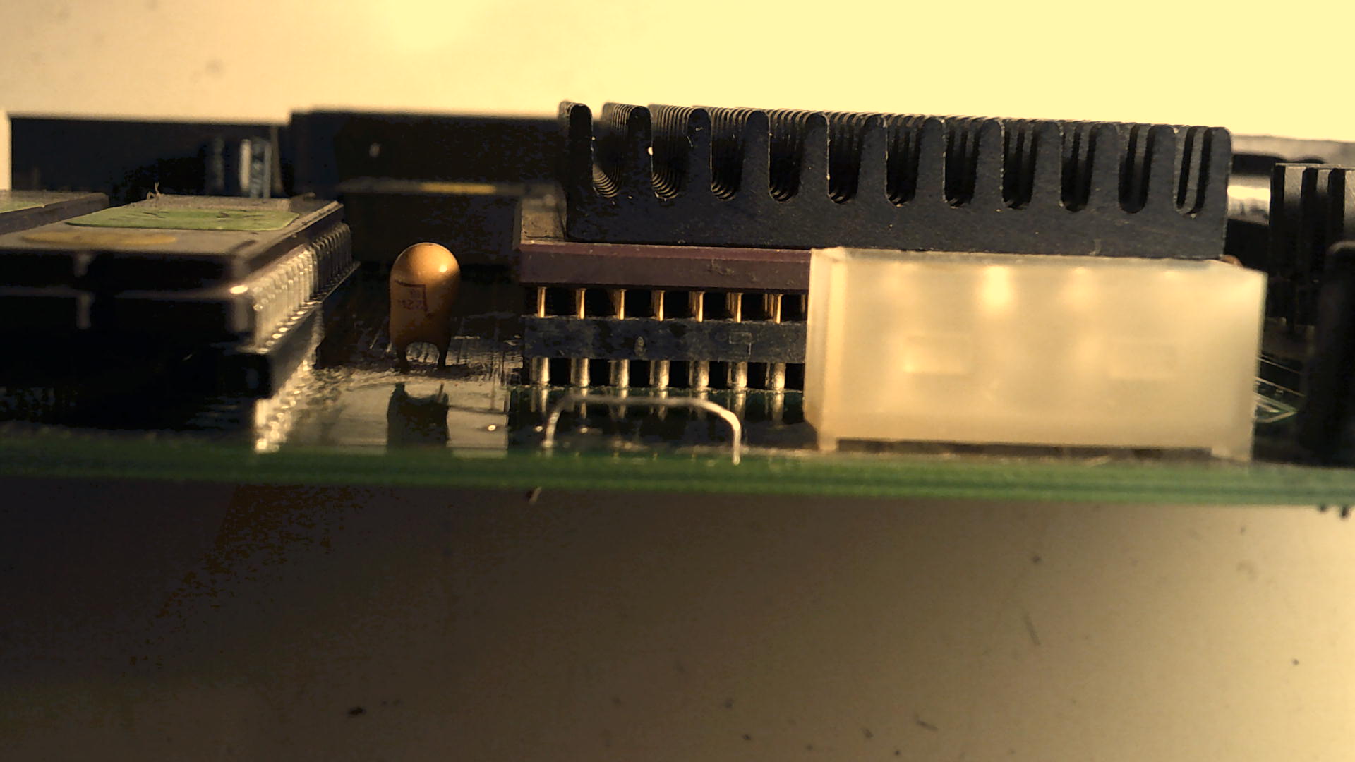

Taken about one hour to coax it out 2mm with gently prizing, I think I'll leave it tomorrow as the final release is where the pins could get bent.
XC68040RC40M  02E31F
XC68040RC40M 02E31F

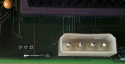

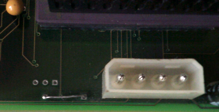

Not sure I understand the 3V3 supply arrangement, referring to image in last post: Square pad in group of three pads is Ground. Square pad next to power connector is +5V. With link in place (as shown) +5V is fed to other two round pads.
For 3V3 conversion replace link with 2V4 Zener diode: cathode to +5V square pad, anode to pin 2 (Vout) and pin 3 (Vin), with ground on pin 1 (ADJ/GND) of regulator.
Edit: nonsense above
