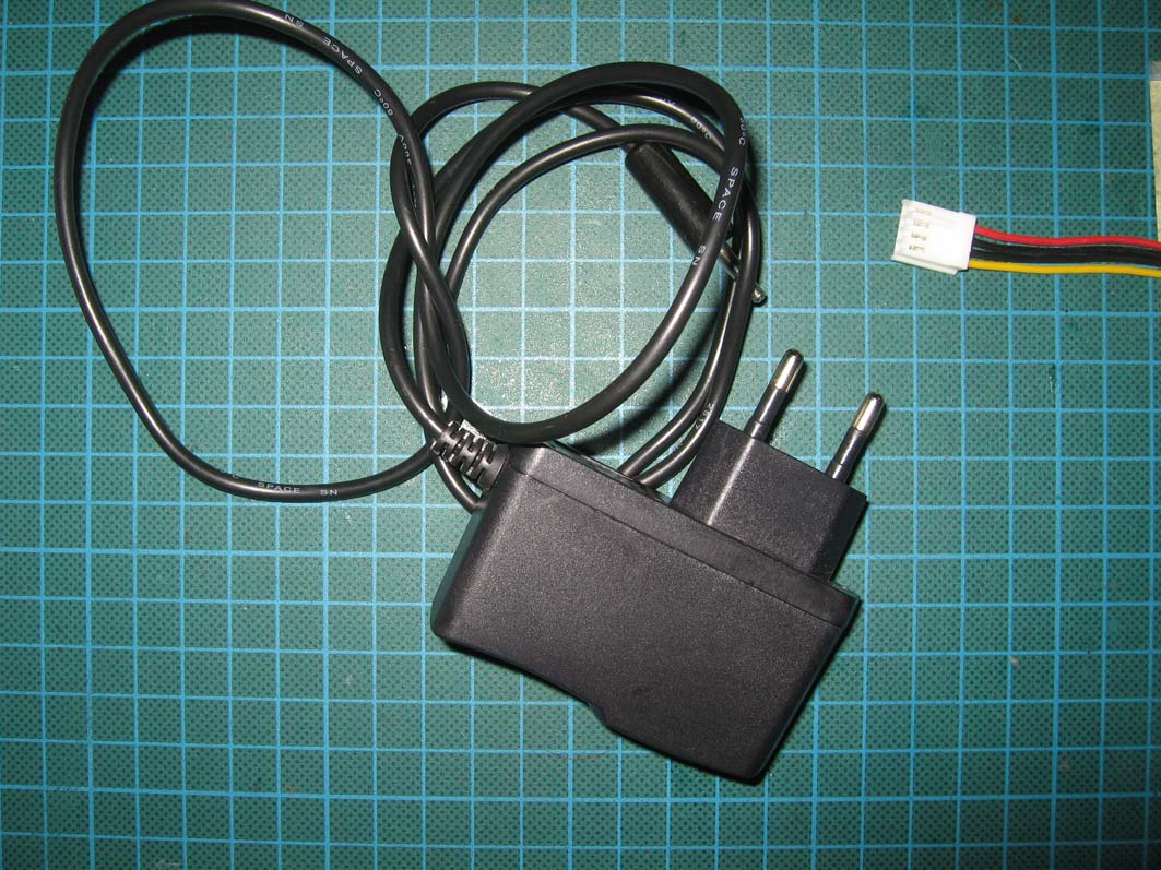

You need a proper 5 volt supply ( maybe a Ebay one 5 V 1 A about € 4,- ) to power 1 3,5 " drive .
---only old 3.5" need 12 V and 5 V
Then a pc floppy cable with all connectors .
Modify the pc cable for use with only 1 drive ( so straight cable ) and then only swap lead 10 and 12 to identify drive 1 and 2 .
That should do it .
Please verify pin number 1 otherwise risk of damage , easy visible as in that case , the led on the drive will be always ON .
