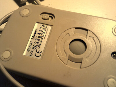

mselkin wrote:Hi,
I can offer some advice, having recently struggled with the same issue.
Most mice did not work and as a beginner I found it quite confusing but I after trial and error and I can confirm that there is a black serial mouse on eBay that does work and also the original genius mouse does work (but only the one that has a switch in front to change it's serial protocol).
I have attached pictures.

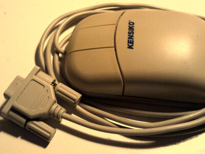

There is a impetus for USB, the Q40 uses a serial mouse. I've been using this one which only cost me £3 new from local computer shop in 1999:
Yes I wiinced. I just ordered some CH559 dev boards from China, could use chip for simple USB to SER mouse adaptor (programmed specifically to deal with QL serial)Derek_Stewart wrote:oh dear, £30 plus shipping for a mouse.mselkin wrote:I found this one, from China, I believe it is the same mouse:
https://www.ebay.ca/itm/322588661391?ha ... Swf1FfA0bV

Hi Silvester, is this a Sermouse compatible mouse? May I add it to the specific "Sermouse compatible mice list"?Silvester wrote: I've been using this one which only cost me £3 new from local computer shop in 1999:
